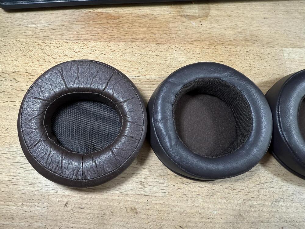

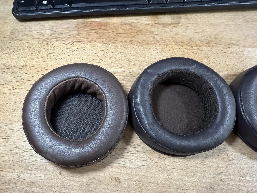

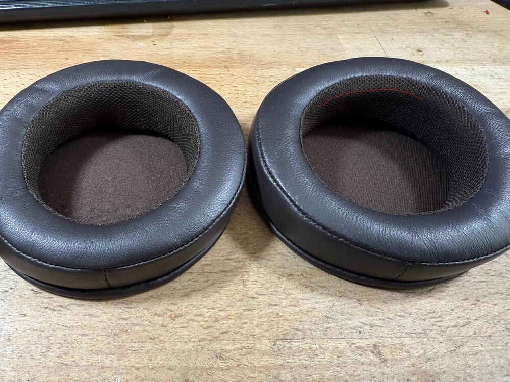

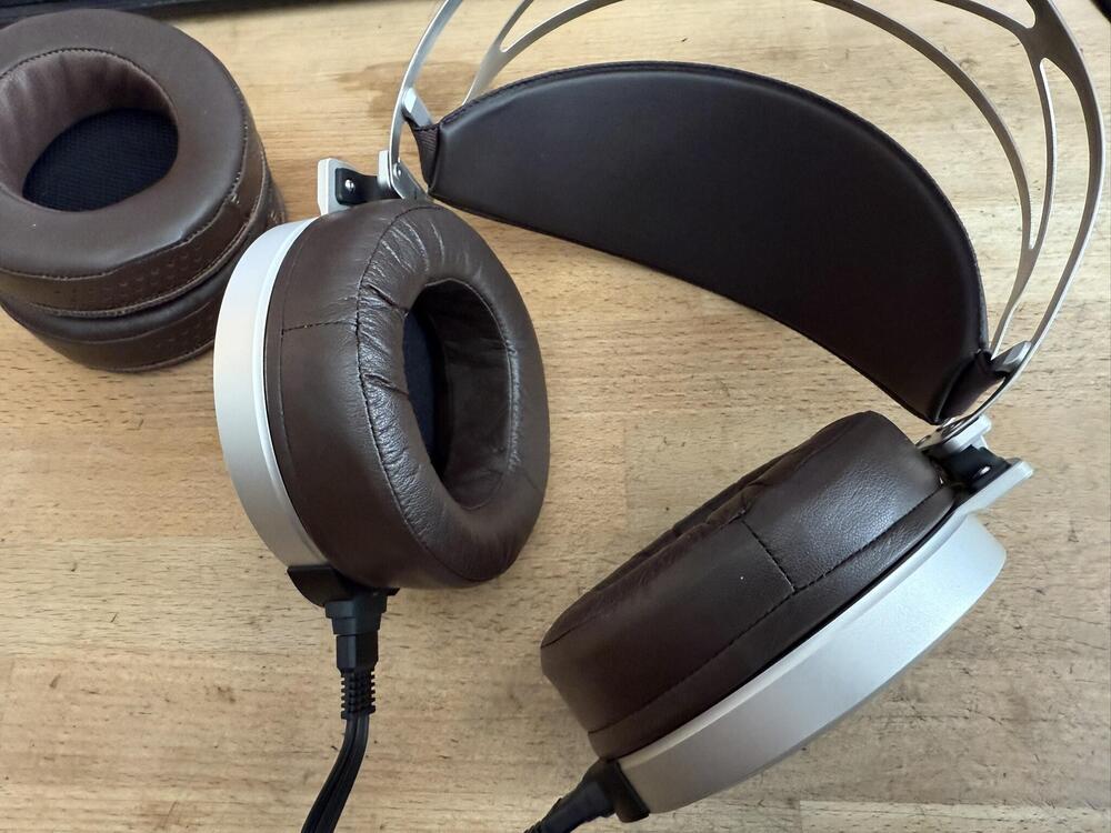

spritzer Posted July 5, 2025 Report Posted July 5, 2025 Had some free time so on went the 007Mk1 pads: These are the 71xxx type but fitted with new foam so not stock, not that a 20+ year old stock set would be fine now. First impressions are okey, the sound has a tad more space around it and the top end might be a bit better but a particular frequency range has that "sheen" to it that is not natural. I'll spend some more time with this setup Comparison of the stock pads on the right and 007Mk1's on the left (with new foam so a bit puffier than normal). Now the Kennerton pads vs. the stock ones. This is with 007 mesh installed but much smaller opening area. Thicker leather too. Finally I wanted to try and show just how shit the stock pads are: The red line on the right hand pad, that's the edge of the foam and where the leather should start. It's off by some 5mm or so in the middle and the same on the other side. I'm not sure if the foam is simply rotated out of alignment or if it is cut incorrectly but the pads are sealed so no way to simply peel them open like the older pads. Both pads are also crooked and just cheap crap. Stax you can do so much better... 5 3

spritzer Posted July 9, 2025 Report Posted July 9, 2025 After almost a week the smell from the stock SR-007S earpads has subsided so I put them back on... and they lasted there for a good hour before I removed them. What the hell were Stax thinking with these... Going from the 007Mk1 pads it was a drastic downgrade, bass, upper bass gets this reverb effect to it, midrange looses all definition and the top end is very peaky. The soundstage and imaging being poor on a 007 is pretty much rock bottom for performance. So I went back to the Kennerton pads as they were a better fit for the new arc and lack of rotation compared to the Mk1 pads. Sound is much tighter and more controlled with them with minimal downsides. As it stands now, I'm going to go with the Kennerton ECL-01 pads but I've gone on a bit of an earpad buying spree (as if I needed any more...) so there might be something better out there for them. To anybody with a set of SR-007S's, I'd recommend trying other earpads as the 105mm size is pretty common and they are easy enough to install. 2
