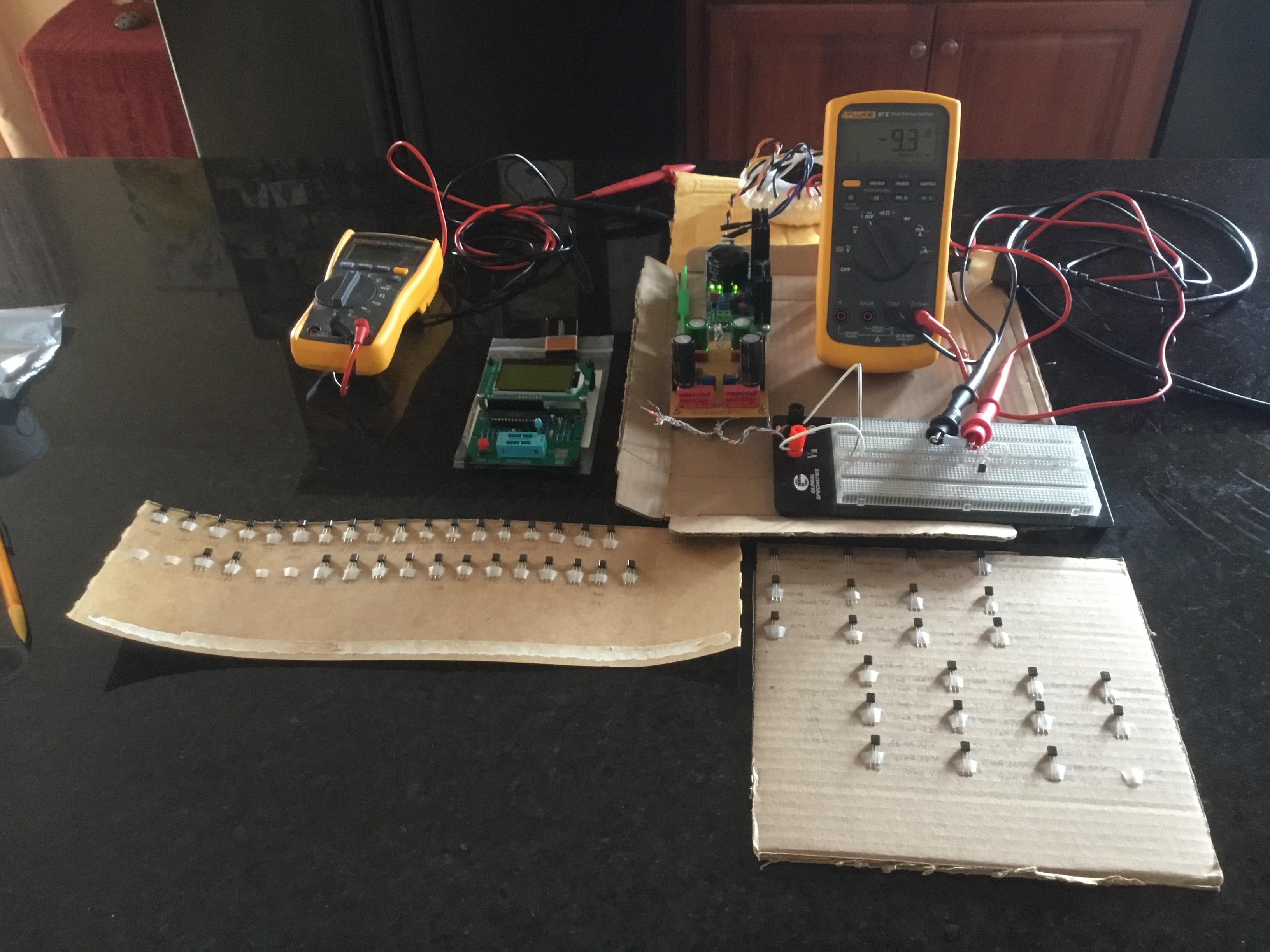

So I rigged together the test circuit both Jose and Chris suggested that used a 12VDC supply and measured the whole batch of 2SK170BL and 2SJ74BL (12 each).
The 2SK170BL IDSS measured between 7.7 - 11.2 mA, the 2SJ74BL measured between 7.0 - 11.0 mA but mostly between 8.0 - 11mA. Toshiba datasheet states 6 - 12mA for BL grade.
The good news is that the relative measurements between samples are consistent with those from the ATMega 328 tester.
I am pleasantly surprised that I should be able to find 4 pairs of K170 within 3% and 2 pairs of SJ74 within 1% and another 2 pairs within 5% of these random samples. Not great but OK. Unfortunately the match between P and N channel pairs are not nearly as good.

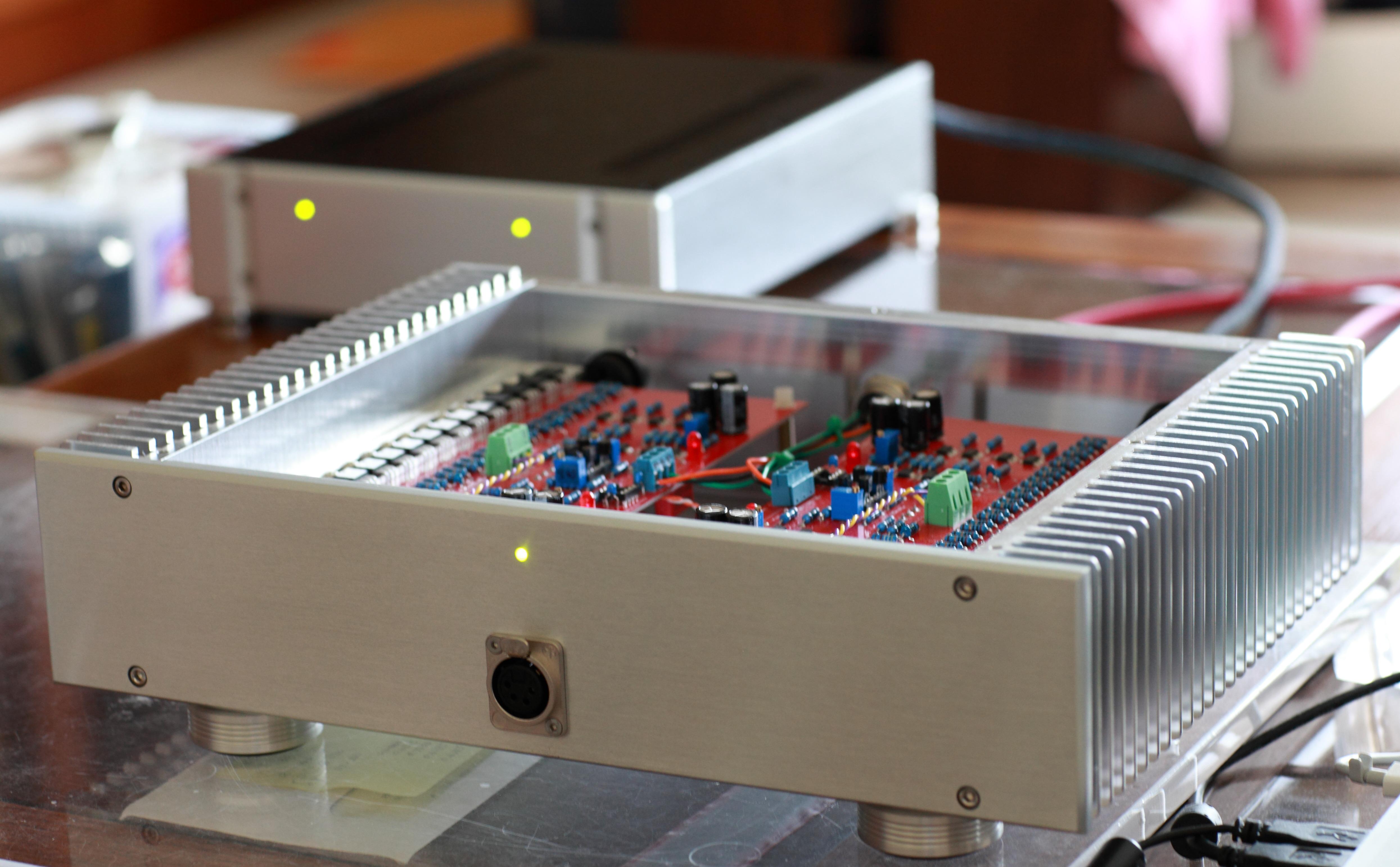

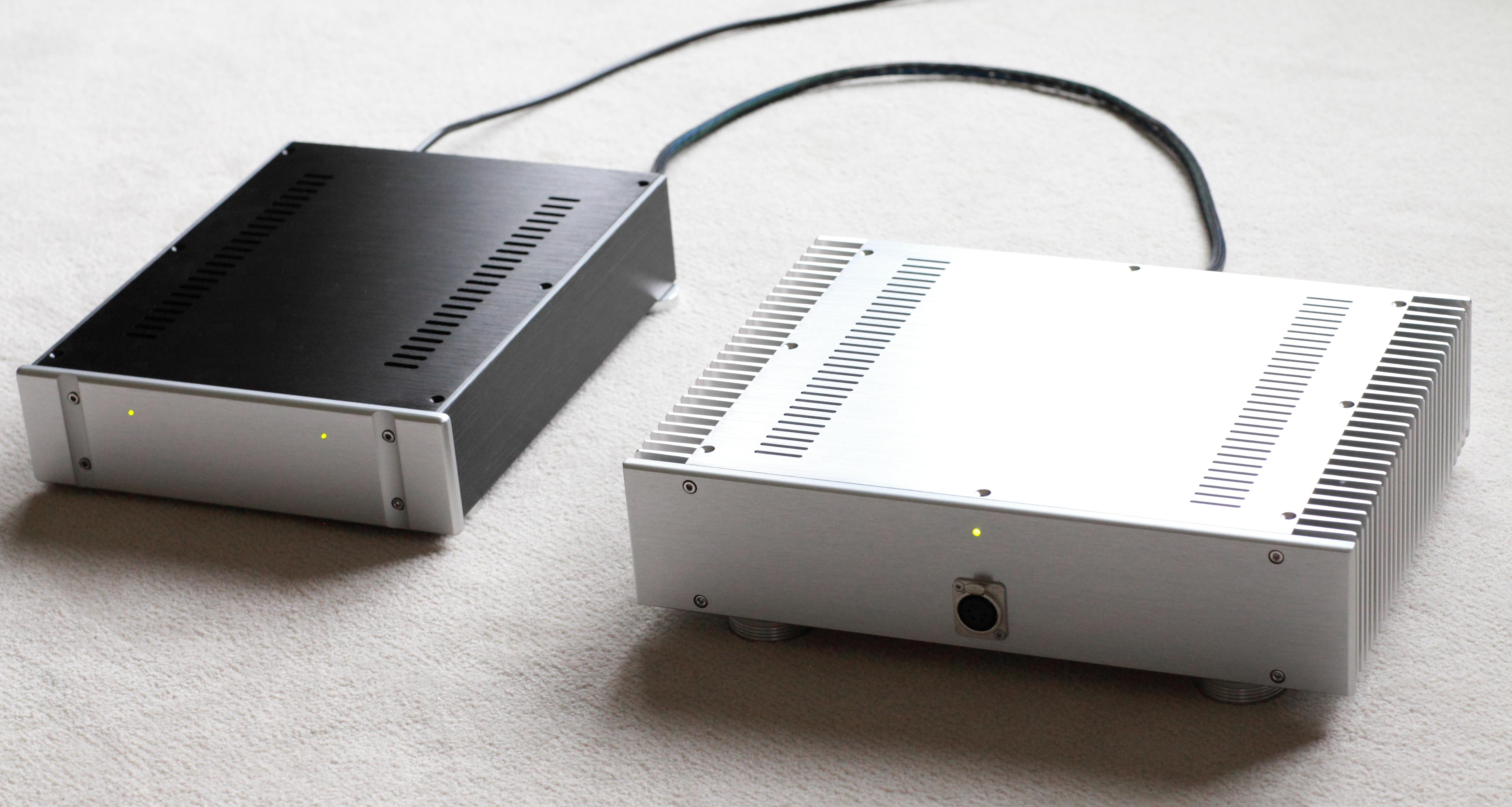

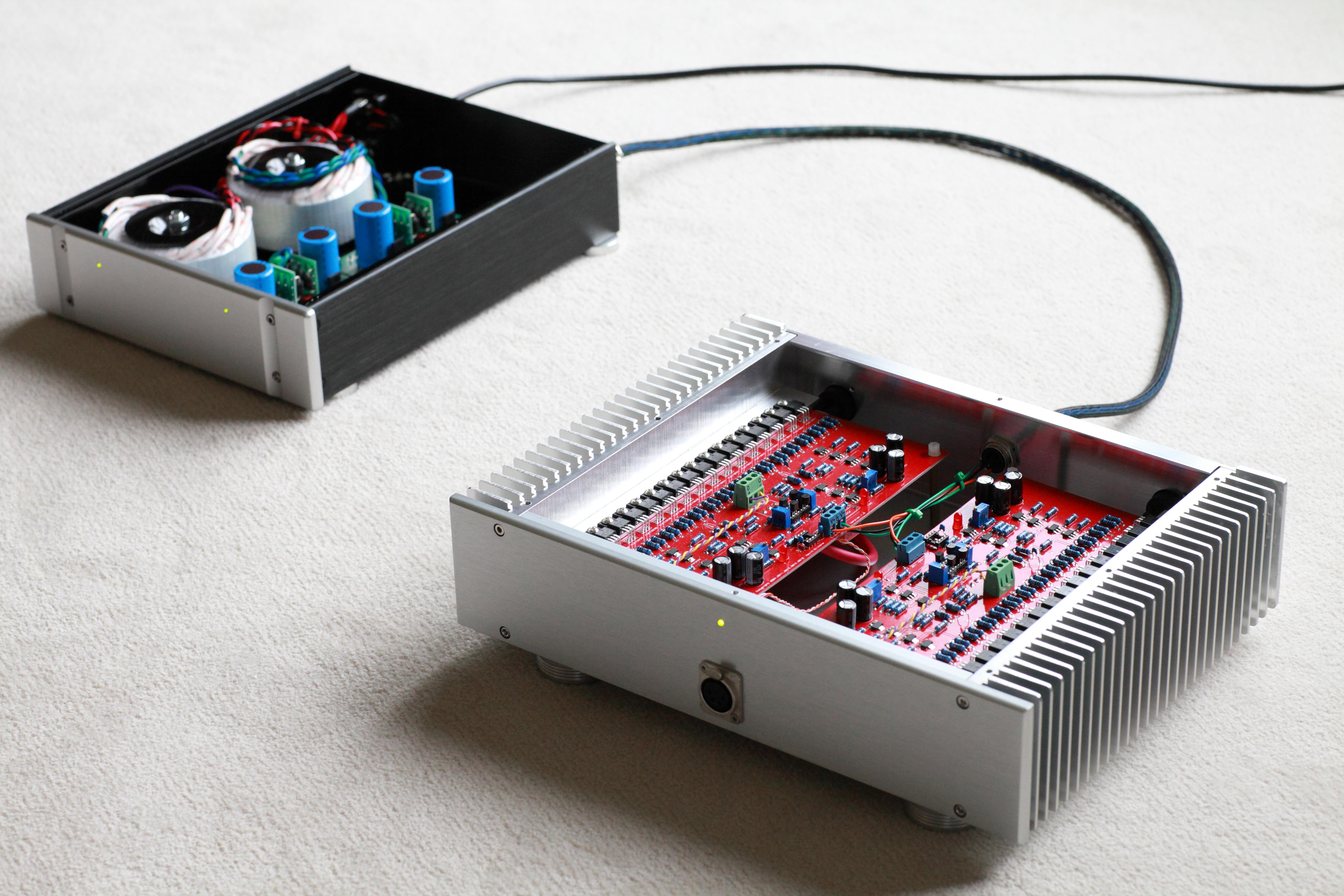

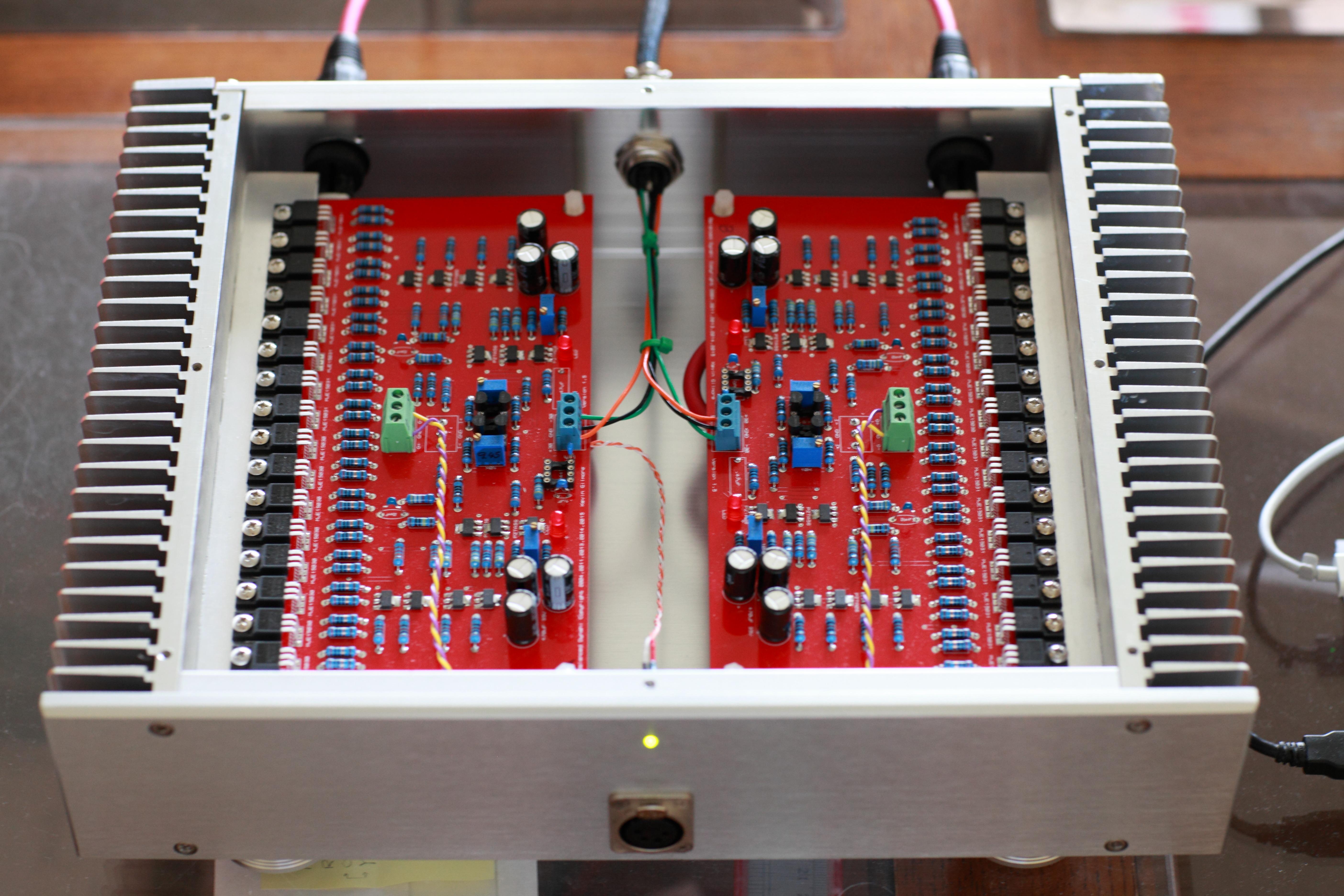

Almost done casing the Dynahi. The input XLR sockets are temporary, waiting for the Neutrik ones to arrive.
Also, cased the dual GRLV PSU which I will be using for both the SUSY Dynahi and balanced CFA. Two Antek 100VA transformers and the GRLVs are set for 30VDC rails.
