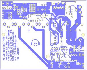

A. Who cares, B. The only such rumors I have seen have been from you, and C. The ground plane on the PCB is indeed a little messy, and there appear to be traces to nowhere. However, it seems really unlikely that any of that will actually influence performance negatively. Perhaps it reflects badly on the designer as someone who is not particularly detail oriented, but all empirical evidence seems to indicate that the amplifier operates as advertised.

As for the PCB design, you clearly don't see my point. This idiot attacks Ti openly and claims to have a superior design (because nobody has ever designed for low distortion before facepalm.png) but can't even do the basics right . The end result leaves a lot to be desired and the only reason this gets any attention is due to people out to prove a point they don't even understand.

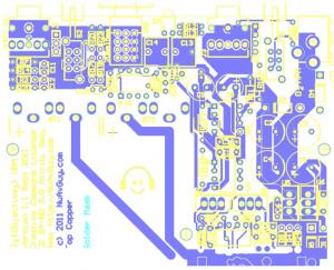

Here are some jpgs from his posted gerbers. Sorry, my graphics capability here kinda sucks smile.png
Really odd ground plane layout, including a couple of traces that don't go anywhere (connected to a pair of series caps).
