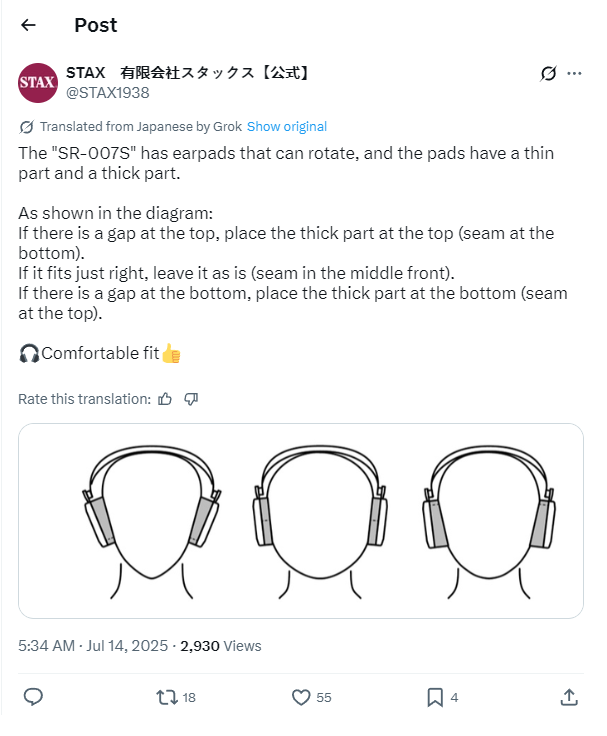

Stax just posted this on X in Japanese but it made me laugh: Anybody want to venture a guess why this had to be posted? Terrible headband design strikes yet again.
