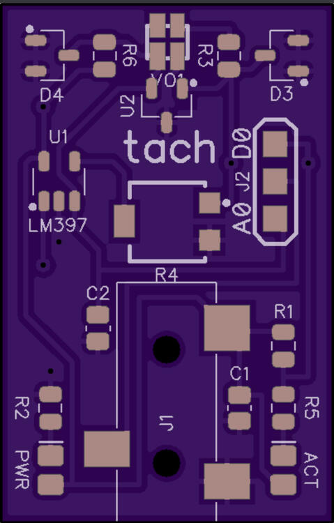

  7. The optical based sensor seems much more fiddly compared to the magnet. It’s influenced by ambient light (for example record needs to be on the platter) and I am using a small craft mirror on the platter but not sure if just a white dot would work better? The part is VNCT2020. IMG_2400.MOV

  18. I think I am going to try to use a reflective sensor - looking at Vishay VCNT2020. I need a mirror or similar, assuming the acrylic platter won’t be IR reflective. Maybe a foil sticker? http://www.farnell.com/datasheets/2614502.pdf added a comparator to the board to adjust the sensitivity
