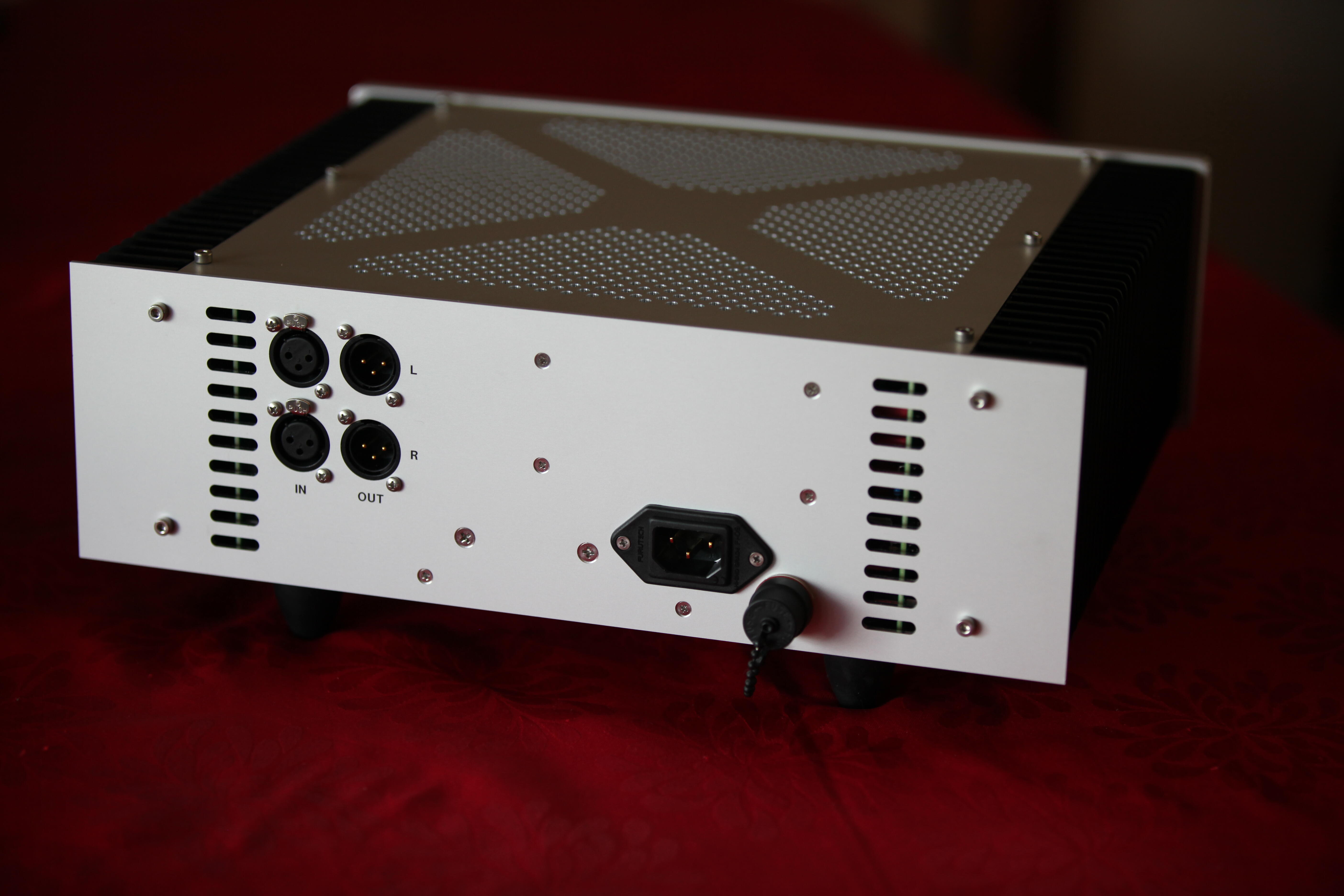

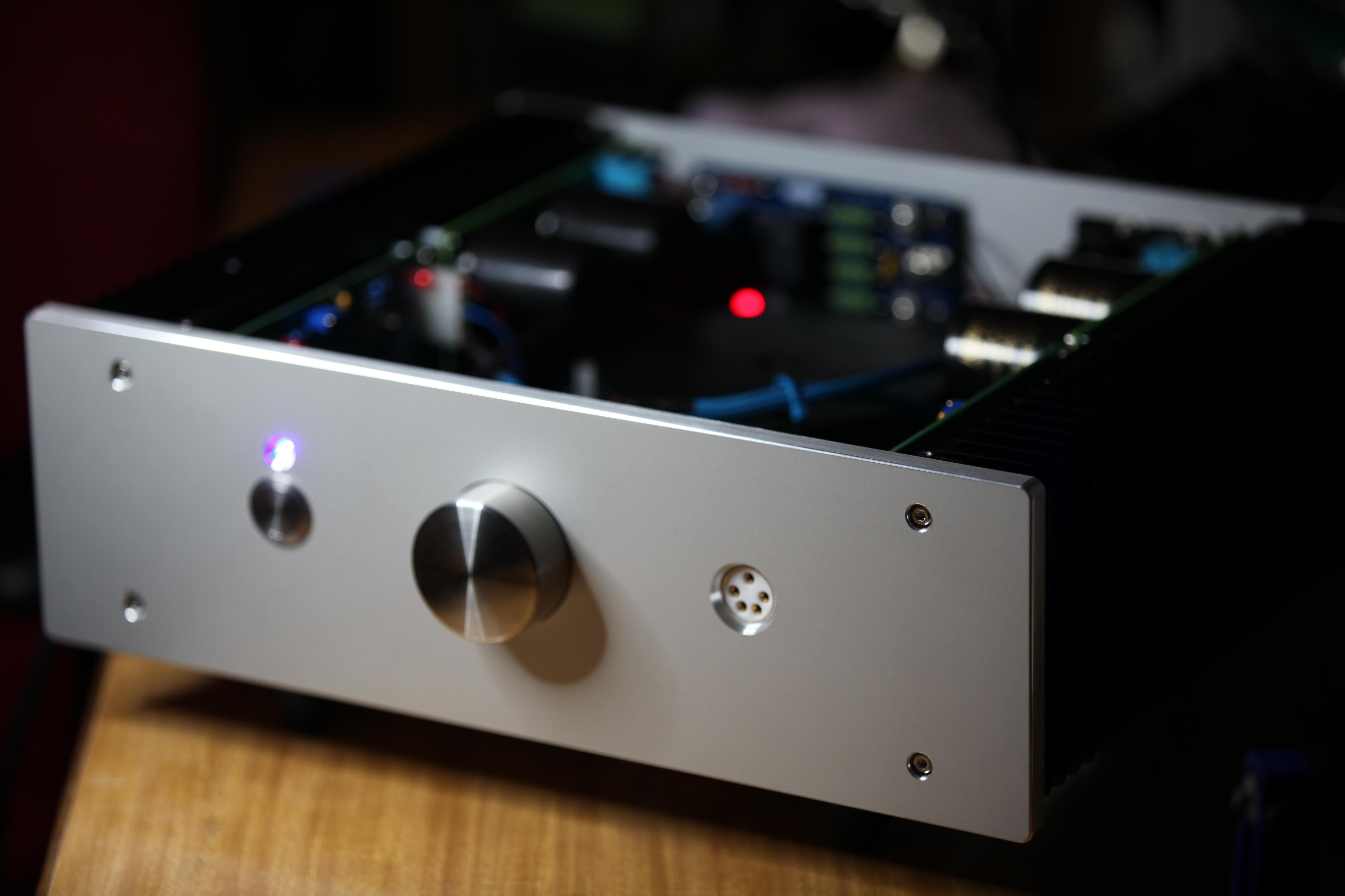

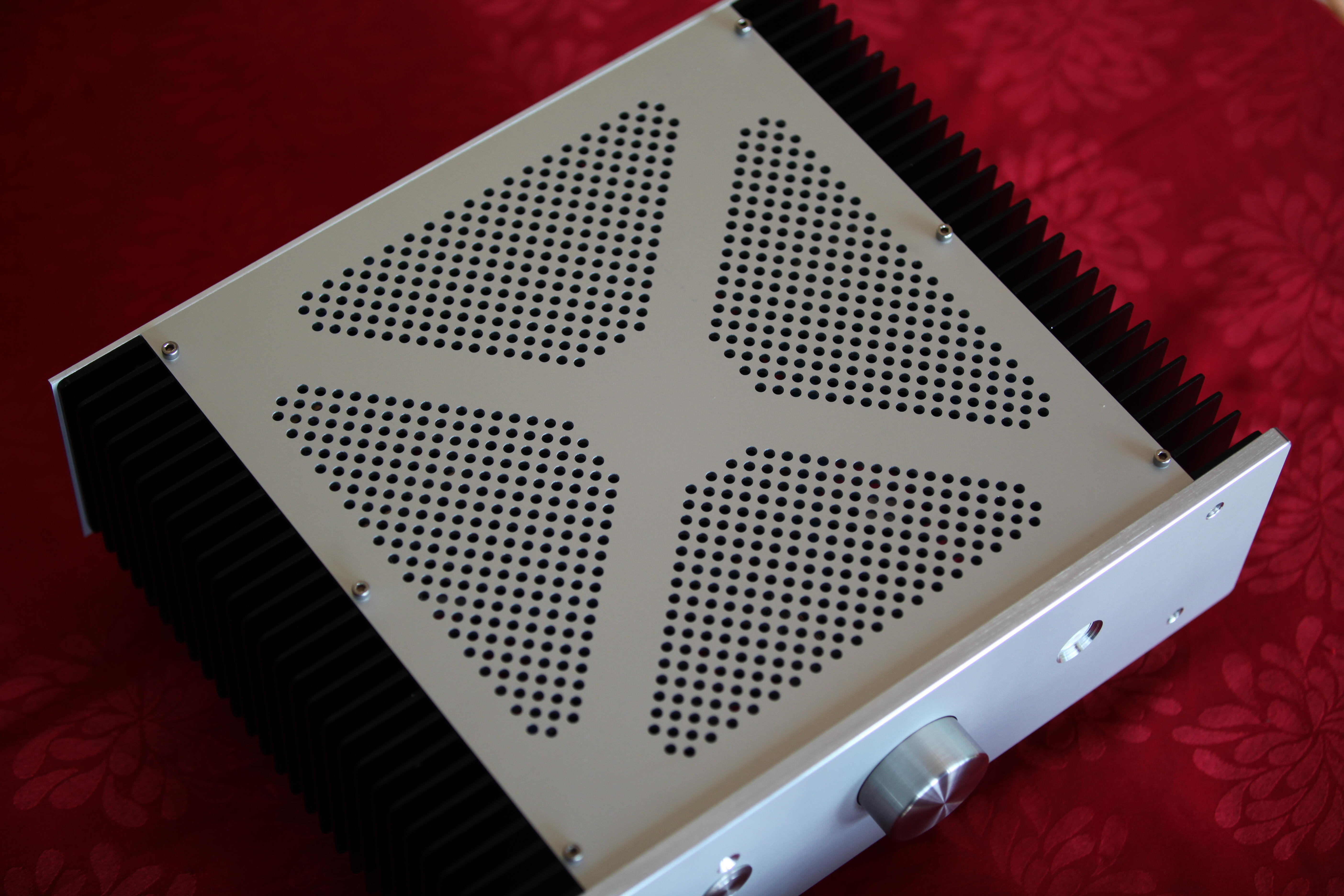

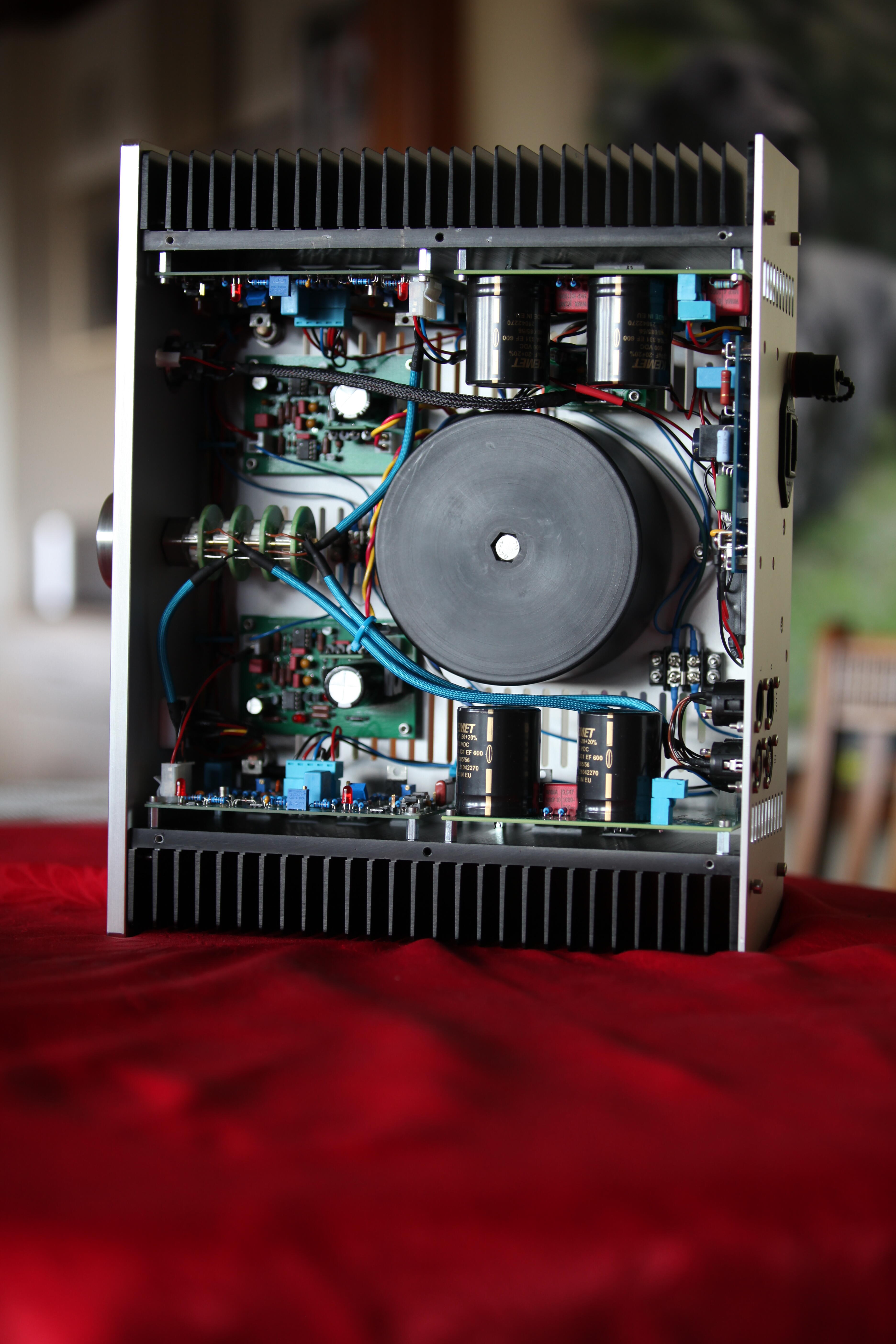

  16. Finally done! I regrettably sold my previous KGSSHV Carbon a while ago, this one’s not going anywhere soon. This is a 400V, 19mA version, using the ground plane amp board, Sumr transformer and Goldpoint V47 attenuator. I bought the heatsinks from China and had all the drilling and panels done at Front Panel Express. I pulled out the Canon 5D from the cupboard for some tasty shots.

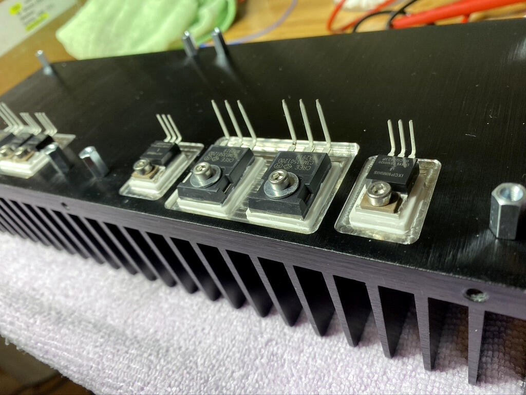

  17. More progress, it’s been a while since I tested one of these, I used Soren’s adjustment method for the CCS which worked well, dialled in for 19mA
