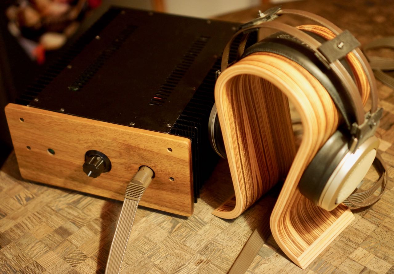

Here are some images. I cnc'd a front panel from future carbon (acazia wood). The extra boards are a 3-stage dc filter and a relay/resistor-based inrush limiter. My old house with strange wiring has quite some dc and it made the transformer hum constantly. The PSU is the standard BH-mini-psu circuit. I increased the cap size when I replaced almost everything on the board.

@Pflugshaupt, thanks for sharing pics!  Love the old school volume knob.  And the woodwork looks wonderful.
There is something different about your SR-007's.  Is that a custom yolk?
Edited by Blueman2
Not sure what you mean by yolk.. part of an egg? Sorry.. I'm not a native english speaker. Do you mean the color? It's a very early SR-007 mk1, so maybe it has seen many more hours of sunlight than most. The ear cushions and the headstrap had the same color - creamy brown, but I replaced those due to previous owner perfume smell ;).
I added a few dampers to combat the ringing when the headphones are touched.
He probably meant yoke, the springy part connecting the two drivers. Looks like you added some clamps to the springs, maybe in order to damp out some resonances?
Yes it's to get rid of resonances while handling the headphones or tapping them - or moving your head. These are 3d printed parts with a layer of sorbothane sandwitched in between. They were inspired by a thread on another forum, can't remember where - but google can find it if you look for stax 007 sorbothane damper.
