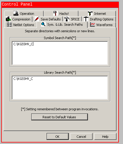

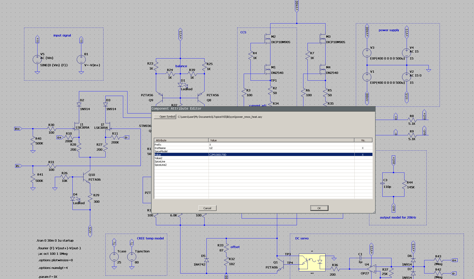

When I open “kgsshv_carbon.asc” I get message  “Couldn't find symbol(s): power_nmos_heat”

47 minutes ago, JoaMat said:
Thanks for LTspice files.
Sorry, for misinformation. Forgot to add it. Please rename to .asy and put it in the same directory as other files.
power_nmos_heat.doc
also make sure you have this setted to yours location

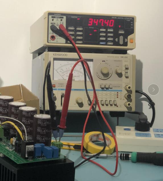

Assembling another kgsshv carbon, this time the positive 400V keep droping from first second, don't know why.
Any diode or mosfet leaking? Don't know how to simulate.
The tantalum cap or pair ksc5026s area about 95c, or 203F, hmmmmm....
Check the current source at the front end
should source more than ~1.3mA or so
look here for more
look here for more
Great great appreciate for your help.
DN2540 is gone,reverse leakage been found,stable now.

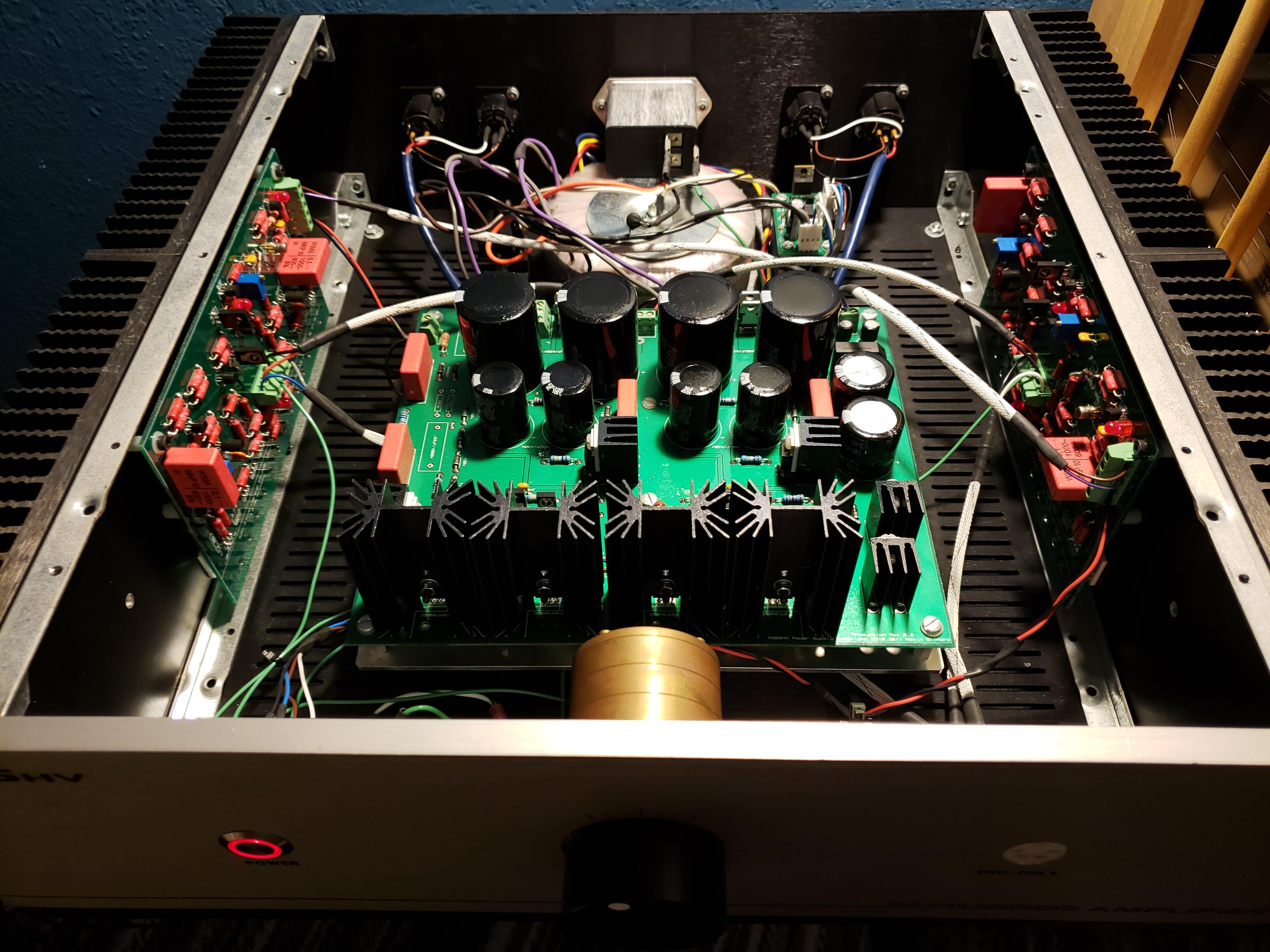

Finally finished the installation of my AliExpress KGSSHV Carbon into a proper enclosure.
I wanted to use a somewhat slim chassis so I skipped those taller ones (100mm+) and ended up with the Breeze Audio SD4309B. It's inexpensive (about $57) and has a pretty solid build. The internal space is just enough for the AliExpress/eBay Carbon PCBs, but a bit shallower than the transformers I have. I had to mill 1mm-deep 'pockets' on the bottom cover for the transformers to fit right below the top cover.
I'm not a big fan of the heat spreaders so those sections of the PCB were cut off. Aluminum angles were used to build a 'cradle' for the transformers that also work as mounting brackets for the extra boards (input switching and LV power supply).
I soon realized that the boards are not so DIY-friendly to work with. The Golden Reference HV PSU board is not designed for center-tapped HV winding which is more popular in surplus. The connectors are somehow placed at the convenience of the PCB routing but not so much for harness routing. Shared terminal pins means that you'll often have to stick two or more wires into the same hole, etc, etc. Not having a mirrored pair of boards seems to make things worse at some places but otherwise not a show-stopper.
I was planning to make this a phase 1 project. The phase 2 will have the input switching and volume pot changed to rotary encoders driving digital pots, which will then make space for phase 3, a tube final stage piggy-backed on top of the carbon PCBs, could be BHSE or Grounded-Grid. There is enough space left, but I'm afraid I won't have the time. Just some ideas for more ambitious builders, I guess.
Nice! Interesting build indeed.
 Making generic boards satisfying all builders is not easy. Myself - I do like mirrored amp boards without terminal blocks.
Until phase 3 – we wait for phase 2.🙂

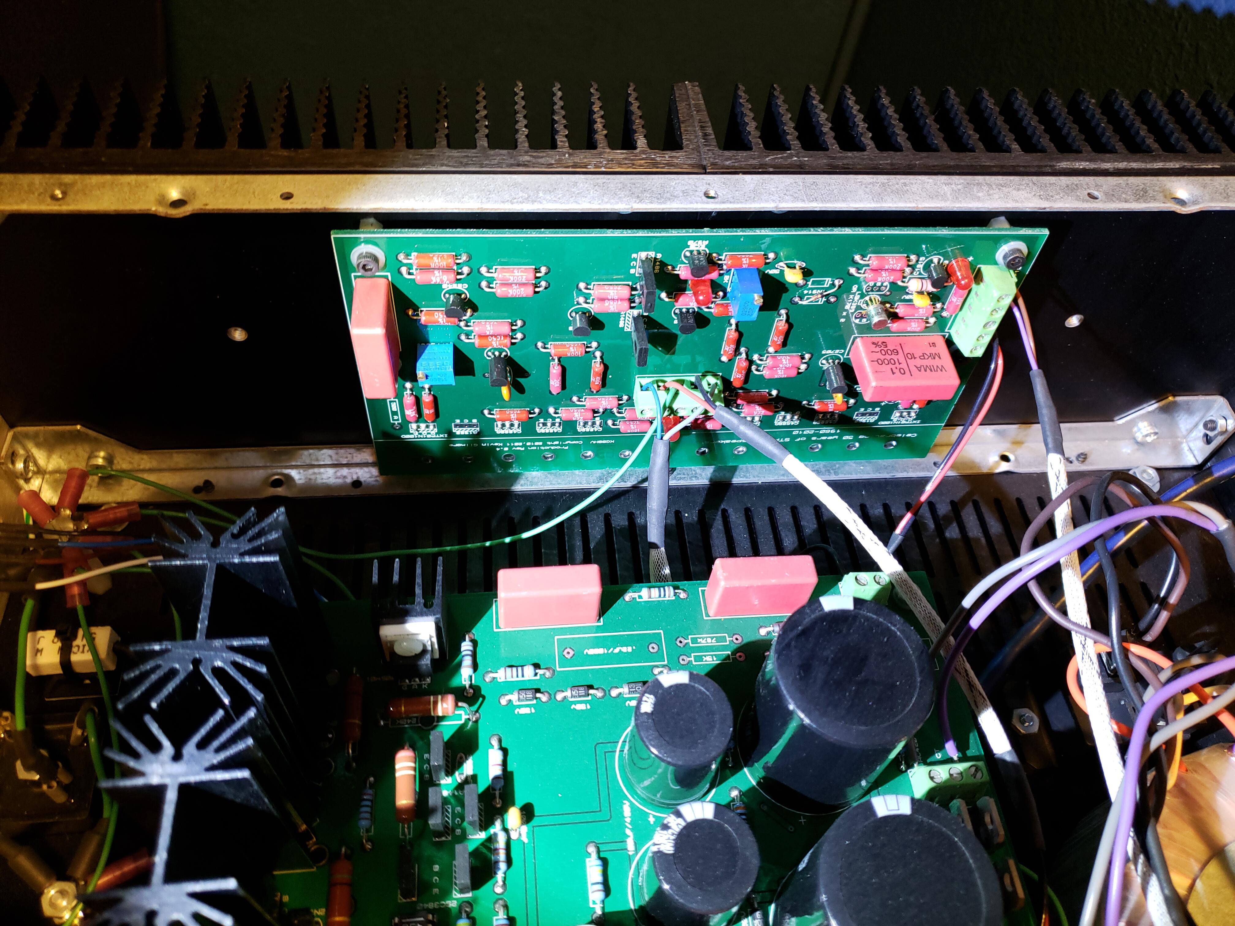

Hi all,
I have a KGSSHV (not carbon) 500V that has developed some low-level static / distortion with certain resonant frequencies on the left channel. I'm fairly certain it's caused by the KGSSHV since the static is reduced when I adjust the offset voltage to be more positive (currently at 40V offset; I believe ideal is 0V offset and 0V balance).
Would anyone have any insight into what is causing this static / distortion, especially since it is reduced when I make the offset voltage more positive?
Thanks!
  • Author
40V offset is quite high. Is this the lowest offset you can adjust to?
If your KGSSHV has offset servo, you will need to deactivate the servo before you adjust the offset. Get the offset close to 0V first (it will drift a  bit) and then engage the servo.
Edited by mwl168
On 6/2/2020 at 12:11 AM, powertoold said:
Hi all,
Thanks!
@mwl168 is right 40V offset doesn't sound right.
The static may origin from leaking resistors or bad solder joints.
Check the 175k's (r10+r11) , r14+r29 and r7+r30 ,  as well as their joints
On 6/1/2020 at 3:11 PM, powertoold said:
Hi all,
Thanks!
Have you tried swapping the channels and see if the problem follows the left channel amp or the left phone? If some leakage exists in the phone, raising the offset reduces the effective bias and hence you get less arc-overs.
Thanks all,
I can hear this type of static with both my 007 and LNS, so the problem likely originates from the KGSSHV.
I'll try to check the resistors that sorenb mentioned. I'm assuming this sort of issue isn't likely to originate from the power supply board.
My KGSSHV uses PRP metal film resistors. I don't think they have a good reputation on this board 😅
Some of us do or have used PRP PR9372 resistors in the past. Things I've noticed about them that I don't like include the epoxy or other jacketing used on the resistors is fragile and easily damaged. The 1/4W variants are rated to 300V;  1/2W and above for 500V. I would presume that actual performance meeting this rating would depend on the integrity of the jacketing?
I tested almost all the resistors on both channel boards, and the resistance on both channels are similar. However, there were some odd measurements:
The 500k resistors were each measuring 1k on both boards.
One set of 175k resistors (sorry I don't have a diagram of the R numbers) start measuring at around 100k and slowly drift to 120k. This was true for both boards.
Overall, the measurements were essentially identical on both boards. I'm using a Klein Tools M400 DMM. At this point, I'm setting the offset on both channels at around 100V and just using the amp that way, since at 100V the static isn't audible so far 😅
I just don't have the tools or know-how to replace those odd-measuring resistors, since it's an off-board KGSSHV with the amp boards glued to the heatsinks.
Edited by powertoold

From the schematic I have, the 500K resistors are from the inputs to ground, so would be in parallel with the volume pot. See if that value changes as you move the pot from 0 volume to full.
That said, measuring resistors in circuit will give you sometimes strange results as you don't know the exact interactions with connected components. Also, ohming out resistors for what is suspected to be a leakage problem won't really tell you anything.
Can you post detailed pics of the amp boards? Are the resistors lifted off of the board, or installed right on the surface? And what is the origin of this KGSSHV? i.e. who built it?
What have you used as input devices?, Were they macheted? do you have the transformer near the inputs? ....
I've used 2 different DACs and also played from several different source files. The static increases with higher volumes and is only audible during "difficult" resonant frequencies (such as reverb from guitar strings).
As far as I know, the resistors are installed on the board's surface. This KGSSHV (non-Carbon) was made by Horio / TMoney I believe. Everything seems well-built, and the heatsink is massive.
It'd be great if there was something I could try that doesn't involve replacing components (to troubleshoot or eliminate the static).
More explanation
I don't have good experience with those red resistors.  On my DIY T2, I had to take a lot of them out.  Your noise could very well come from those.
This is regarding the KGSSHV (non-Carbon) issue above:
I think I resolved the static / distortion issue. I had essentially doubled the current to ~10mA by adding a parallel 200R resistor to the 180R. I removed the parallel resistor, so the amp is now "stock." After I removed the parallel resistor, static / distortion isn't audible (yet). Thanks all.
