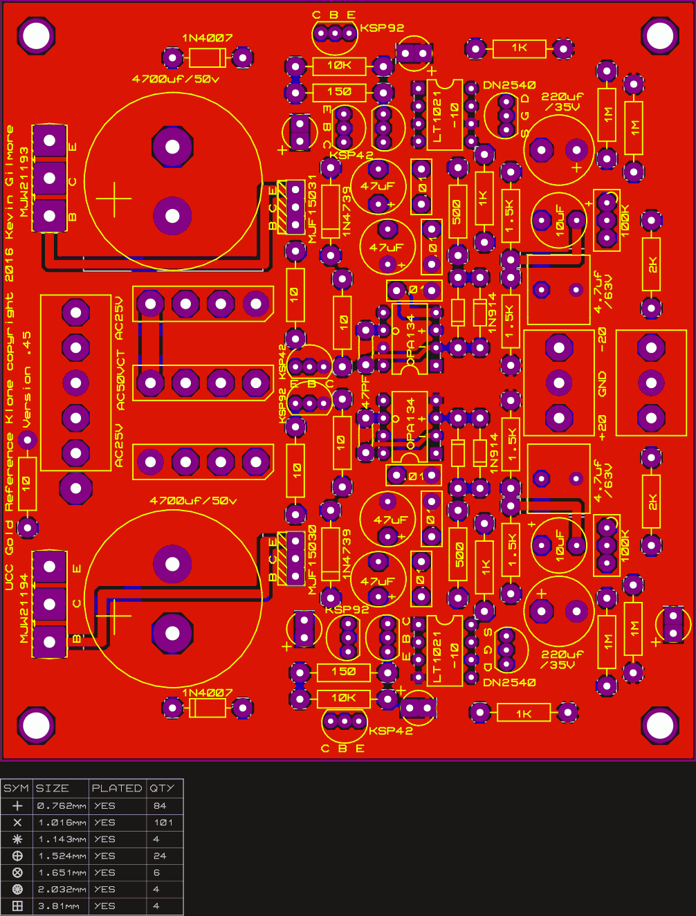

Is the GRLV version you are doing the one with the dual output blocks? This is the one I would prefer as I've had to modify a couple of mine for greater output capability. I attached the gerber file for this one (6d version). Not sure what your noted "v6 combined" in the signup spreadsheet refers to.

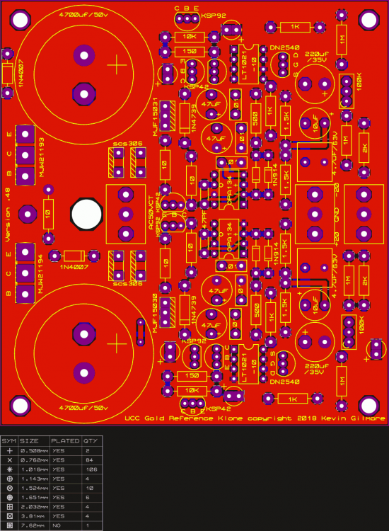

Does this version have the big caps on it?
Don't think so. The one I posted above is the same as goldenreference6, but has dual outputs.
The version with 35mm caps is goldenreferencelargecap.zip? That one has the 35mm caps, dual outputs. It is only setup for 1 bridge (center tapped) and TO-220 SiC diodes only. That one would be fine with me, but others may not want that one.

Here are gerber images of goldenreference6d:
and goldenreferencelargecap:
6d may be closer to what people were looking for. The largecap version does not support the rectifier boards, but the TO220s rectifiers it uses are SiC diodes (which are schottky as well).
Edited by Pars
  • Author
We'll go with 6d unless anyone objects
