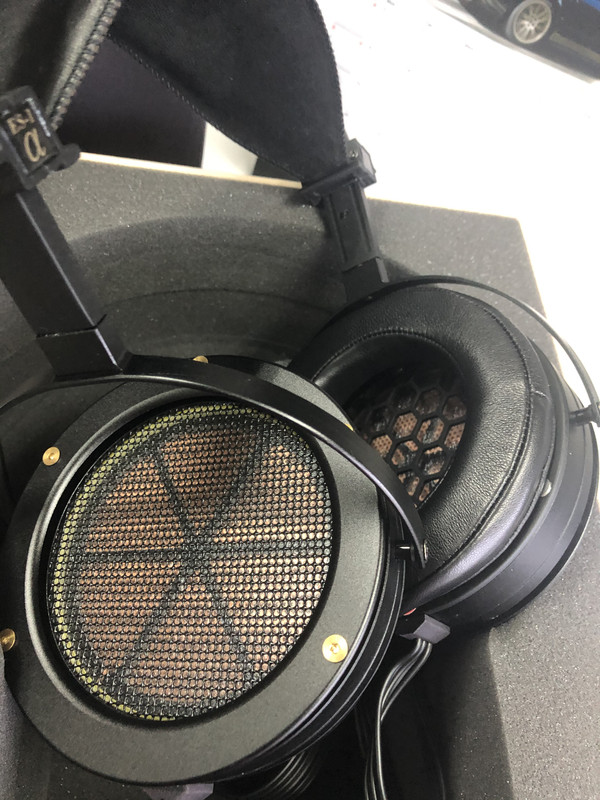

18 minutes ago, ivanrocks321 said:
If you are going to Canjam this weekend in NYC, ill be there likely most of the time over the two days. Ill have both my Kaldas RR1 and ES1a with me if anyone is interested in a listen.
already ordered a set hah.
