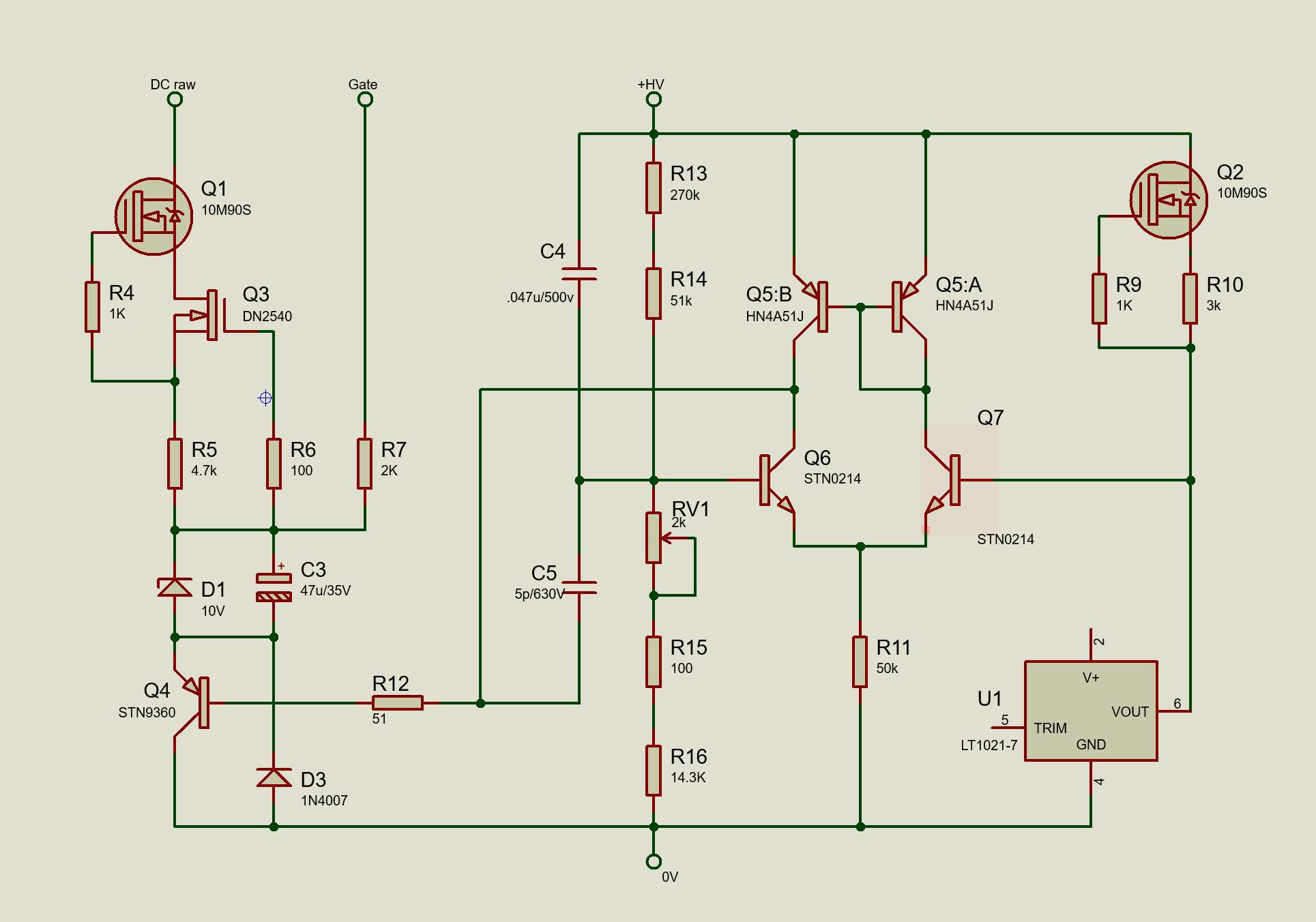

JoaMat Posted December 12, 2022 Report Posted December 12, 2022 Here a schematics. Four connections to main board. The raw DC is taken before the two 10m90s current limiters. Better would be after the limiters but no free hole for it. Works like a charm I wrote. Yes, charming it is when it works. When it suddenly stops working and give 13V instead of 150V – that is more annoying than charming. It has happened two times so far since my last post. Not sure what’s wrong but I change Q5 (dual small PNP) with a new piece and then it works for couple of hours. Now I’m just waiting for the next breakdown. Suggestions what might cause the problem are welcome! 1
Kerry Posted December 12, 2022 Report Posted December 12, 2022 (edited) The golden reference supplies work very well in the T2. I've been using it for a while now with no issues. You do need to take the raw DC after the 10m90s current limiters though. I'm using a single IXTP08N100D to limit the current for each supply. You should be able to get away with a single 10m90s for your 150V supply if you adjust the set resistor accordingly. The current draw there should be around 50mA. I've added a protection diode (1N4007) with the cathode connected to the base of Q6 and the anode connected to 0V. I also got rid of D3. Here's my T2 supply (I've been meaning to post this for a while) - all the high voltages are Golden Reference supplies (even the -60V using a negative version of the GRHV79xxx). I've very pleased with how it performs Good luck! Edited December 12, 2022 by Kerry 5 1
JoaMat Posted December 12, 2022 Report Posted December 12, 2022 Thanks Kerry. I just had to wait four hours for it break down this, the third, time. Same procedure as last time – replaced HN4A51J. Also reflowed all solder points – hot air – hope this will help...
Kerry Posted December 12, 2022 Report Posted December 12, 2022 Hope it works for you now. If not I’ve got some other ideas. 1
simmconn Posted December 13, 2022 Report Posted December 13, 2022 @JoaMat Did you measure the removed part and see which transistor and which junction failed? If it takes a while to fail, chances are the power dissipation is over spec. Something else could be leaking that causes excessive current through the part. An IR camera would be handy in troubleshooting problems like this. The STN0214 may have a different Cob than the original part KSC5026, and the closed loop gain of the regulator is also different (20x vs 40x), the compensation capacitor values may need to be adjusted to maintain stability. 1
Kerry Posted December 13, 2022 Report Posted December 13, 2022 I use PBHV2160Z instead of STN0214. You can also try STR1550. I also changed C4 to 1000pF. 1
simmconn Posted December 13, 2022 Report Posted December 13, 2022 1 hour ago, Kerry said: I use PBHV2160Z instead of STN0214. You can also try STR1550. I also changed C4 to 1000pF. PBHV2160Z is nice due to its high HFE and low Cob. I'll be using PBHV2160Z and PBHV3160Z in my upcoming GRHV build with off-board e-caps. From simulations using those transistors I learned that C5 needs to be increased to 15pf to 22pf for best phase margin, and 47n is still the preferred value for C4 that provides a low and consistent output impedance across the audio frequency range. Another interesting find is that the circuit needs about 100uF output capacitance to be stable, and increasing the value of that cap has a diminishing return in the performance, unless the cap has really low ESR (such as film caps). In case the cap's ESR is high, some additional compensation can be added to ensure stability (hundreds of pf across R7). The above findings are for the original GRHV with 400V output. YMMV if the output voltage changes. 2
JoaMat Posted December 13, 2022 Report Posted December 13, 2022 (edited) Thanks a lot for all your inputs, Kerry and simmconn. Now it seems I’m back on track (knock on wood). Since “reflowing” the board and a new HN4A51J the PSU has been working for almost 24 hours with several on/offs. Voltage is stable, decreases some tenths of a volt from cold and than bang on the intended 150V. After some struggling, I managed to measure the three faulty HN4A51J. All Q5:B are unknown components on the tester while Q5:A are PNP with hfe of 4 or 5?. Now the angels are singing on my modified T2 with EML tubes. Edited December 13, 2022 by JoaMat 4

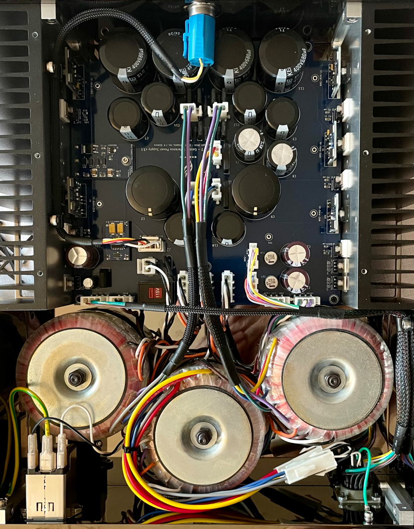

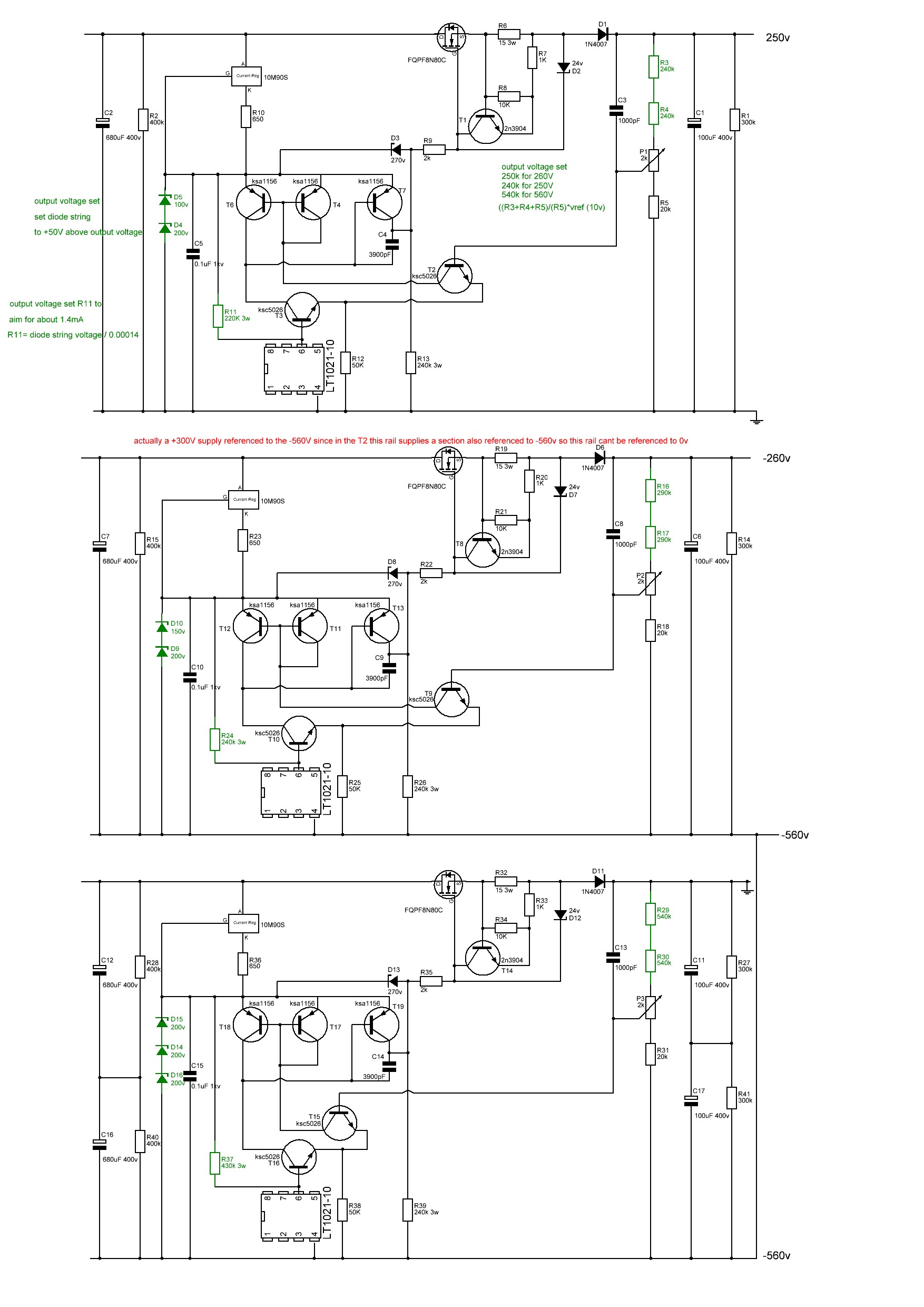

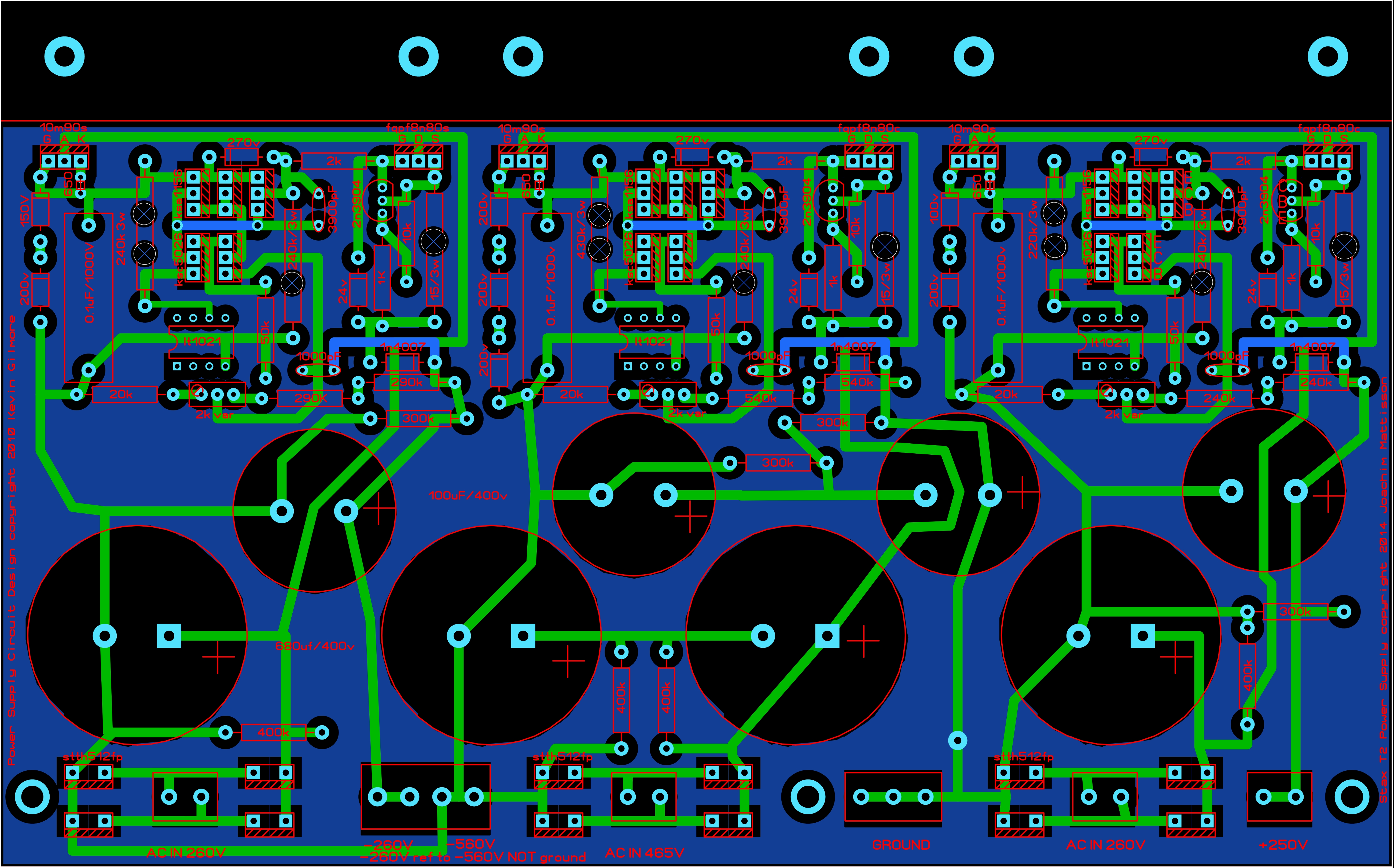

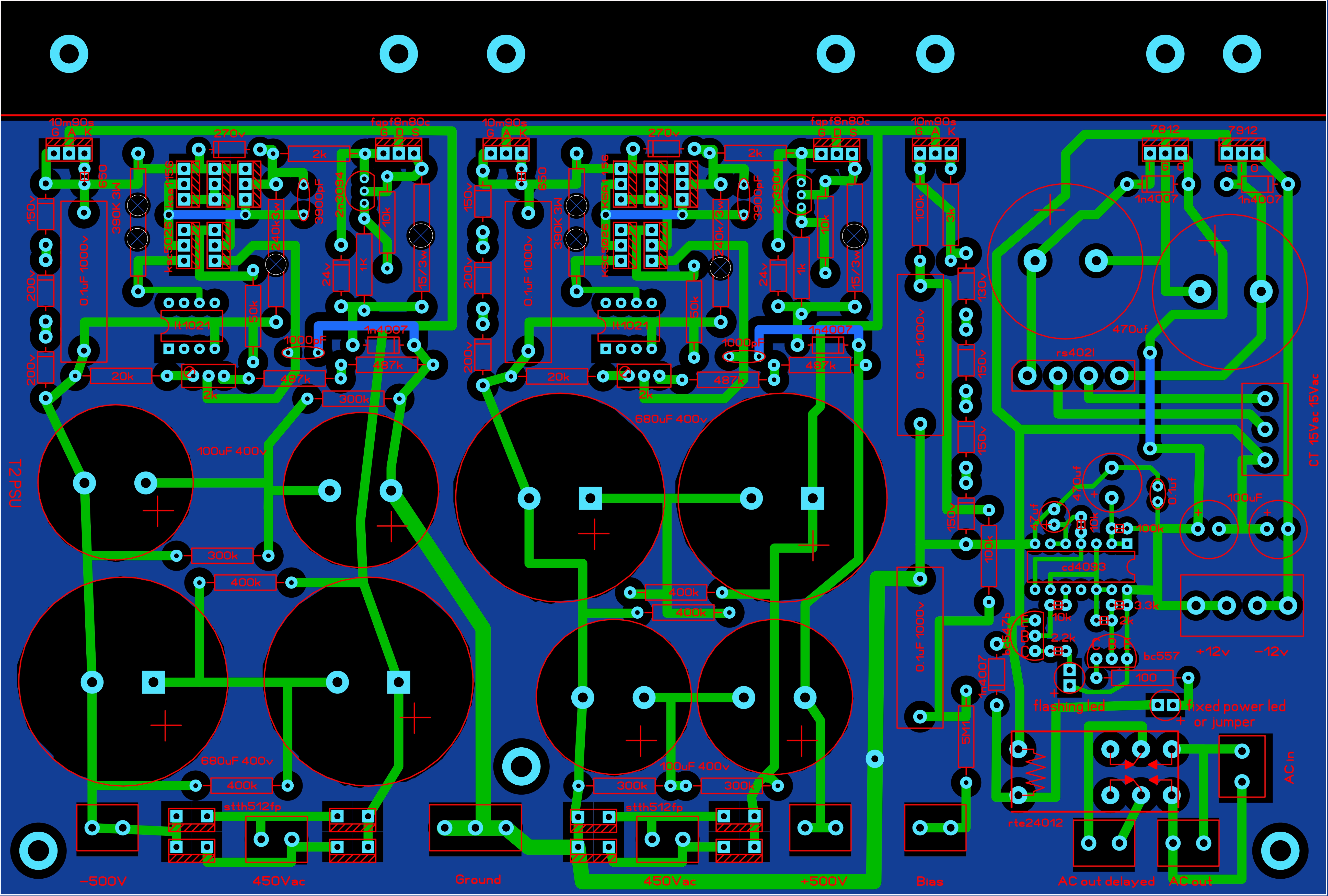

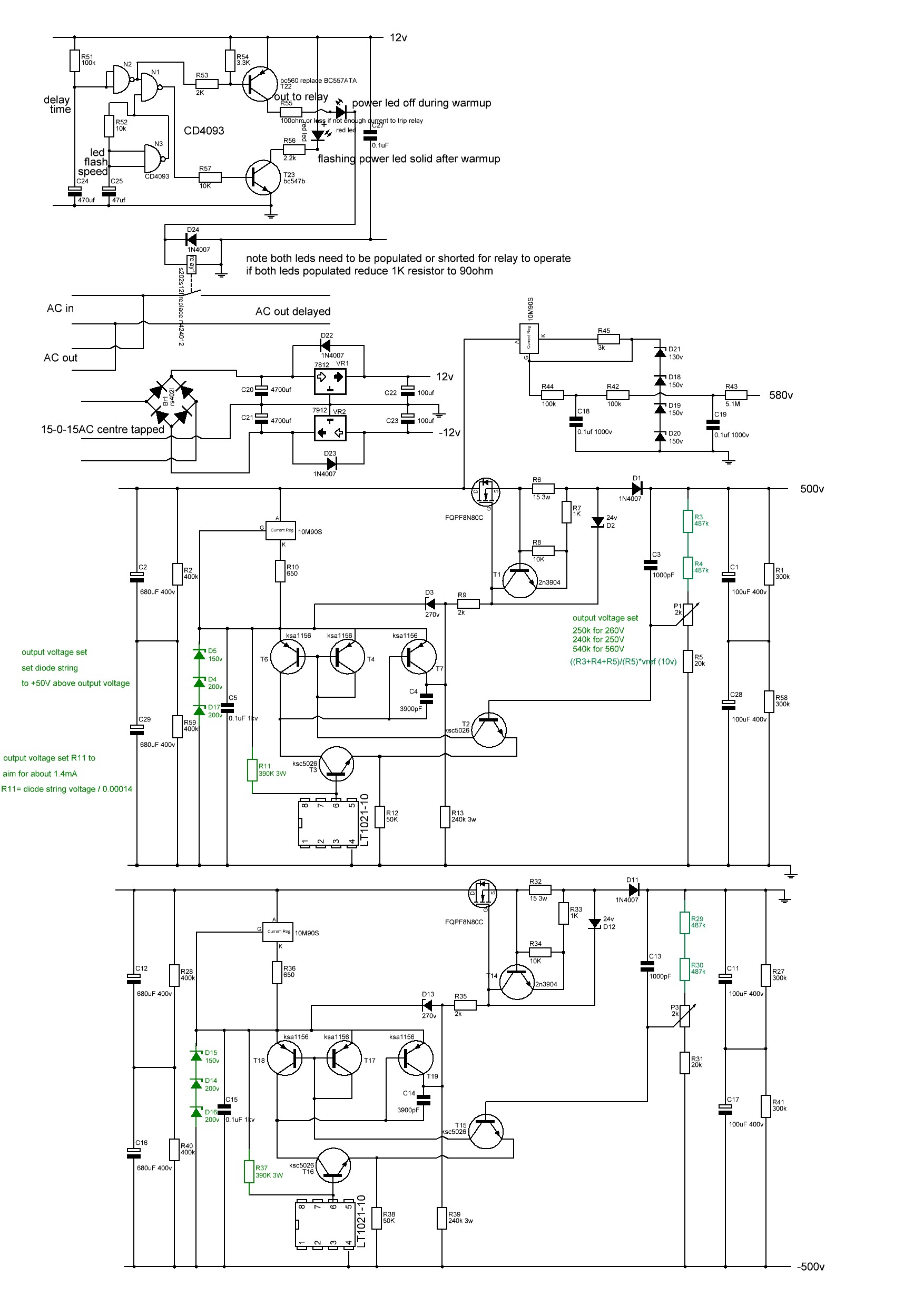

jamesmking Posted February 5, 2023 Report Posted February 5, 2023 (edited) Here the latest T2 psus, I have modified the layout to provide more space around the rather hot R11 3W resistor and added vent holes to the pcb. The pcbs, transformers etc still fit inside a 400mm deep case without issue. I noticed that the R11 equivalent resistor on the + and - 500V rails runs considerably hotter than the equivalent resistor on the other rails (which also run quite hot).... doing some quick maths, R11 is approximately 1000ohms * the value of the zener serial train /1.818 on all the psus rails except for the +and -500V... Using this formula gives 300Kohms for the + and - 500V rails but in the original gerbers I worked from only have 240K there. This results in higher current flow through the resistor and more power dissipation and hence the higher temperature. EDIT: thank you Joamat for suggesting the current through R11 should be 1.1mA or more. The R11 values here on all rails are based around 1.4mA with values available in the PR03 Vishay range or 3W resistors. Resulting in lower power dissipation on all rails and especially the +-500V The gerbers with the vents have been used to make functioning psus and can be considered tested. This pcb is 220mm wide by 137mm deep and contains the -260V, -560V and +250V rails t2 kgsshv 250v -260v -560v corrected.zip ---------------------------------------------------------------------------------------------------------------- This pcb is 220mm wide by 148.5mm deep and contains the low voltage rails, delay and the +-500V rails with the adjusted 3W resistor t2 kgsshv +-500v, lv, bias and delay corrected.zip Edited February 6, 2023 by jamesmking 3
