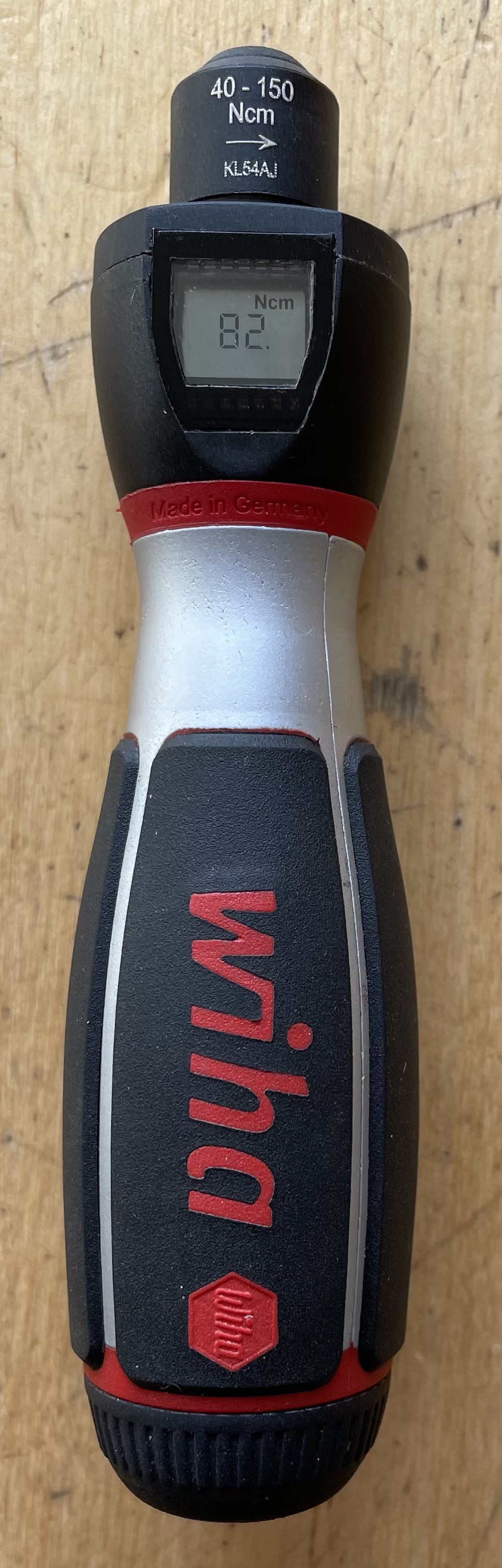

I use this setting
...and I don’t know how to convert Ncm from Nm 😢
Used above setting for a long time and haven't had any issues so far – knock on wood.

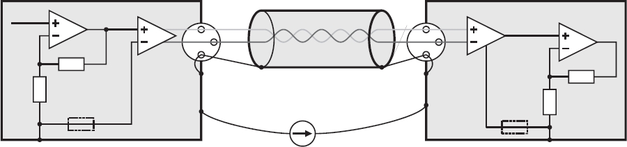

Regarding pin 1 grounding which in this context plays a role as well and was asked above, here is a pic. It goes to the amps chassis and then to the PSU chassis (remember separated chassis ground wire run) and then to PE and is (in a differential amp setup) used with metal chassis basically for shielding only.
In order to satisfy the various environments and wildly used grounding schemes and avoid loops, there is a new series of expensive Neutrik EMC XLR connectors using a cap between the connector's shell and pin 1. Here is a good read up on this.

My torque setting of 82 Ncm equals to 0.82 Nm, or?
Upper post’s 8-9 Nm must equal to 800-900 Ncm
This link is very handy. https://www.convertunits.com/from/N-cm/to/N-m 😉
Upper post’s 8-9 Nm must equal to 800-900 Ncm 😉
Yes, using 0.8Nm as you as well without issues. Looks like the above is missing a 0.
But still a bit above the spec Craig posted. Probably +0.13Nm isn't a dealbreaker if everything else is right.

A differential signal doesn't need circuit ground as return path and the XLR/RCA adapters connect cold pin 3 to RCA signal ground while the RCA jacks (chassis side) keep ground isolated from the chassis. So all good, in case of proper implementation of course.

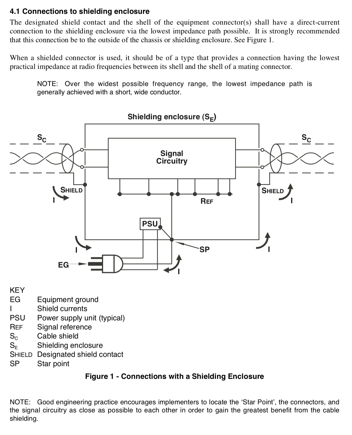

Here is a pic from the AES paper on grounding for a metal (shielding) enclosure. One box design is shown, but the idea should be clear.
Edit:
Look for Neutrik (chassis side) jacks with complete metal ring (B-series) or metal case (D/DL-series) for the best possible shielding/mating with a metal enclosure. A/AA-series use a plastic case and make a single point only connection (via the screw) to the metal enclosure.
