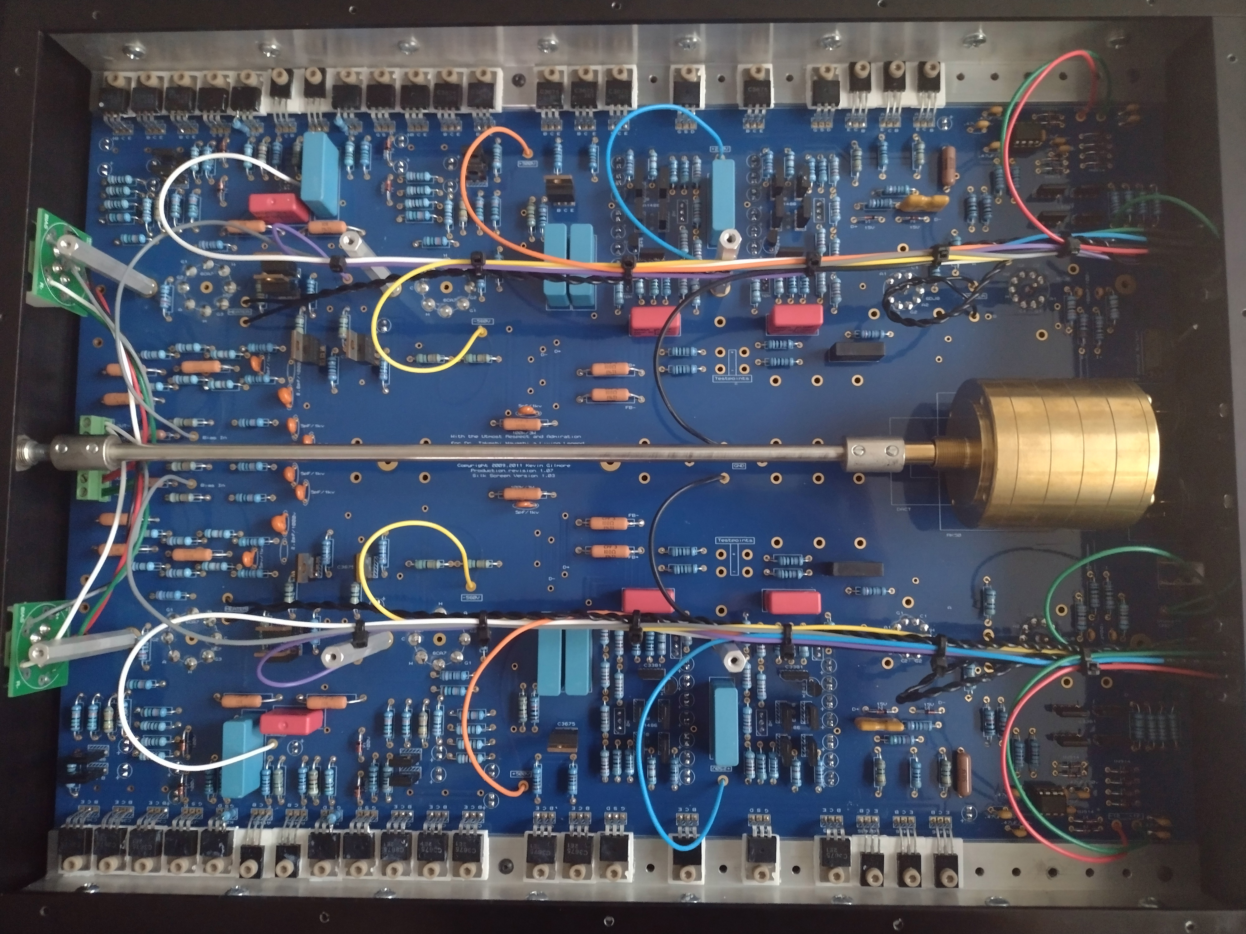

s_r Posted June 18, 2023 Report Posted June 18, 2023 Figured I may as well add a pic of the other side of the board. A few of the K216s have 500Ω resistors attached to the gate. The 3675's in the batteries all have an hfe of about 64-67 too.
demonkuro Posted June 18, 2023 Report Posted June 18, 2023 Yesterday I did a continuous 5-hour test. I found that the voltage of the battery will decrease, the voltage from -549/+206 at 30 minutes, and then to -549/+202 after 5 hours, only the positive voltage will decrease, and as the positive voltage decreases, the output voltage to GND will also change from about -5V to -20V。 why is only the positive voltage not stable? At the same time, I found that the output of the R channel to GND must be above -549/+208 to be stable, is it okay to have such a high voltage?
s_r Posted June 29, 2023 Report Posted June 29, 2023 Good news, everything appears to be working normally now. With some help from georgep and joamat I managed to track down what seems to have been the culprit: one dead 2SC3675 in one of the triplets of 2SC3675's. Probably the reason two of the LEDs nearby were dead too. I just need to plug in some stax now and have a listen... All batteries now measure +200V/-539V, and R42 measures 6.55V just as it should. 13 1 1

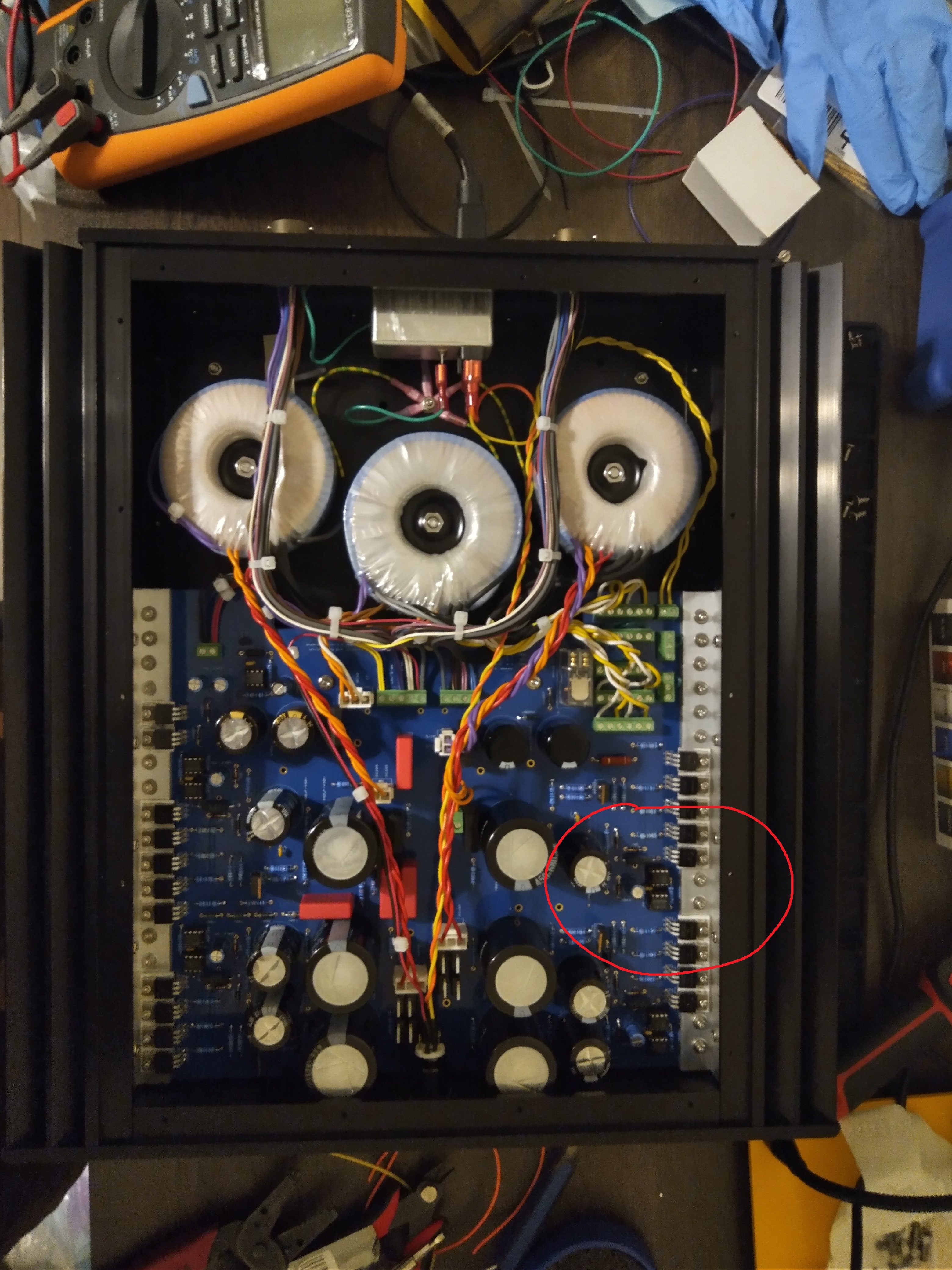

jamesmking Posted July 18, 2023 Report Posted July 18, 2023 (edited) 1 hour ago, jokerman777 said: Things I know so far: -Chassis/earth ground is now shorted to on board signal ground, either through the case of 7812 or I might have a short somewhere else. -The anodes of the 10m90s at the +500V/Bias supply side are shorted to gnd, so either one or more of these might have the case shorted to the bracket or I have dead diodes causing it. -On the other side where the sparkle happens the cases of all the transistors are not shorted to the bracket. -Disconnecting the HV trafos power on again +-12V supply still works I know this is way too little information to find out what went wrong other than I have one or more things shorted, I will take it apart further inspect this wknd When testing without load is it ok to run the PSU without heatsinks installed? As that will save quite some effort since I likely need to do multiple iterations of trouble shooting. if the +-12V rails work (with no load some voltage regulators will not regulate properly and most have current and thermal limiters built in) then its highly unlikely the 7812 or 1912 voltage regulators are shorted to ground. with no load I don't see why a working psu cannot be run without heatsinks for short periods of time... however if you have a short on the output side of a HV rail then the pass mosfet/transistor could be trying to output a lot of current and be running hot even with a heatsink... if you have a thermal probe you could CAREFULLY measure the temperatures of the heatsink transistors and see if any are getting excessively hot. when the psu has fully discharged you could run your multimeter in diode check mode on each of the diodes in the psu (both directions). I assume your negative HV rail is working ok. If your psu is symmetrical then the negative HV rail is basically exactly the same as the positive rail in basic topology then you can start making comparative tests between the two. (for my T2 build I did not use the same pcbs or psu as you have so I don't have any direct experience of your psu) Edited July 18, 2023 by jamesmking 1
jokerman777 Posted July 18, 2023 Report Posted July 18, 2023 10 minutes ago, jamesmking said: if the +-12V rails work (with no load some voltage regulators will not regulate properly and most have current and thermal limiters built in) then its highly unlikely the 7812 or 1912 voltage regulators are shorted to ground. with no load I don't see why a working psu cannot be run without heatsinks for short periods of time... however if you have a short on the output side of a HV rail then the pass mosfet/transistor could be trying to output a lot of current and be running hot even with a heatsink... if you have a thermal probe you could CAREFULLY measure the temperatures of the heatsink transistors and see if any are getting excessively hot. when the psu has fully discharged you could run your multimeter in diode check mode on each of the diodes in the psu (both directions). I assume your negative HV rail is working ok. If your psu is symmetrical then the negative HV rail is basically exactly the same as the positive rail in basic topology then you can start making comparative tests between the two. (for my T2 build I did not use the same pcbs or psu as you have so I don't have any direct experience of your psu) STTH512FP is fully encapsulated and so has no exposed metal LIVE tab so no change of spark between the tabs of the diodes (since there is a rather high voltage difference between the tabs and they are spaced fairly close together) Thanks for the suggestions! I will take it apart and do connectivity & diode test first, then maybe reconnect rails one by one for measure. 7812 the case is ground pin so if that's shorted to the bracket it will short signal ground to chassis ground and circuit will still work, this is the only reason I can think of rn that can short the two GNDs. Negative rails was working fine until I see the spark which happened on the negative supply side so I'm not sure now, something might have gone up to smoke. great tip that if I have one leg of the rails working I can use it as reference 🙂
sorenb Posted July 18, 2023 Report Posted July 18, 2023 59 minutes ago, jokerman777 said: Oh I got parts referencing a BOM where it says stth1512D that is obsolete and I used STTH15S12D instead, I suppose not going to make a difference? STTH512FP is ready available and fully insulated. If you look through the KGSShv thread, some had troubles with un-insulated rectifier tabs shorting.
jamesmking Posted July 18, 2023 Report Posted July 18, 2023 8 minutes ago, sorenb said: STTH512FP is ready available and fully insulated. If you look through the KGSShv thread, some had troubles with un-insulated rectifier tabs shorting. yep, there is a lot of voltage differential across those tabs. I only use STTH512FP so far zero failures zero issues with them.

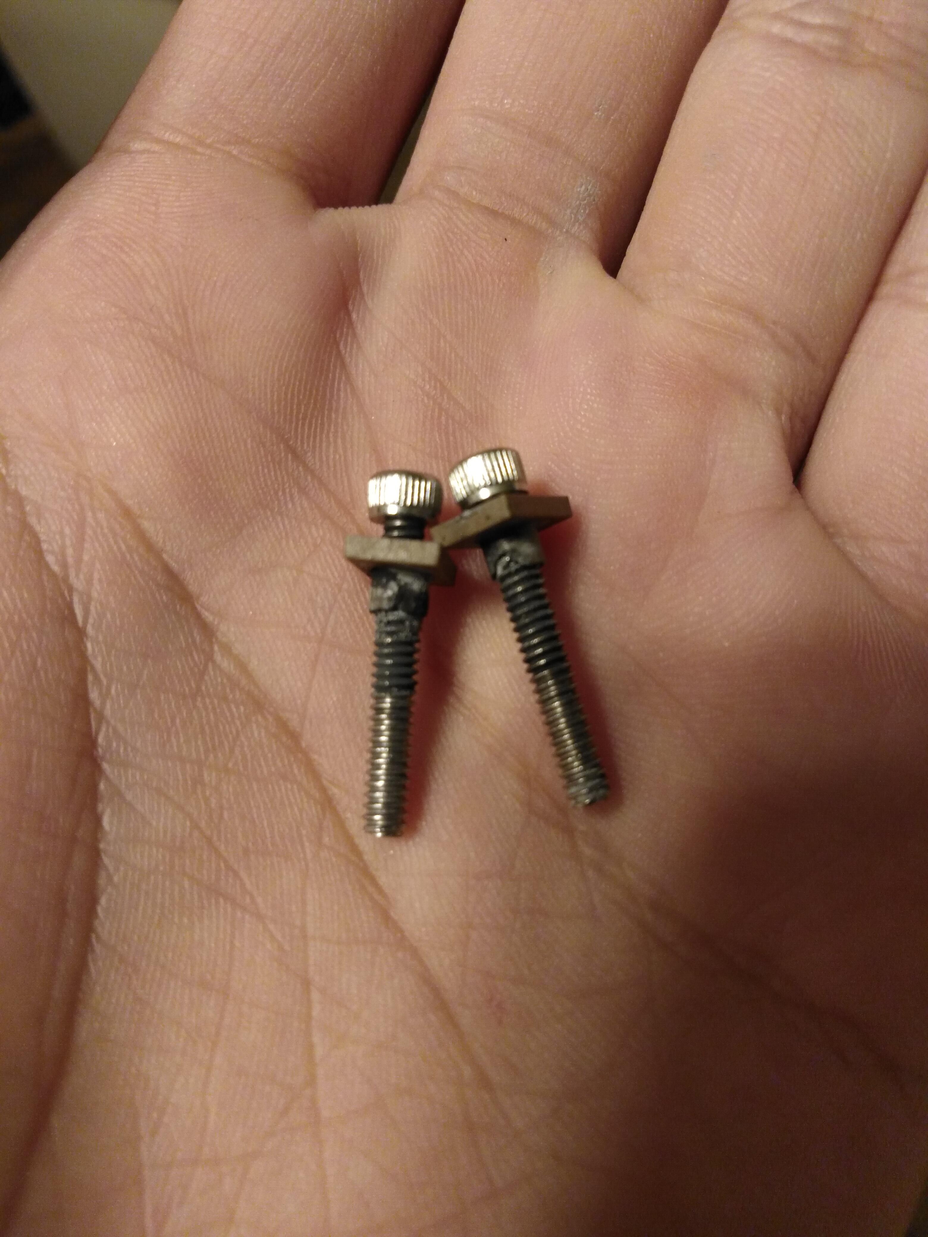

jokerman777 Posted July 19, 2023 Report Posted July 19, 2023 I took the PSU apart today for simple checkups. On the positive supply side it was the case of 7812 and Q3 10m90s both shorted to the bracket, burning up the insulation. I think I initially had applied force to drive the screws incorrectly such that they bite into the insulation washer and damaged it. They been measuring fine for shorts until I mount the board into chassis and heatsinks and also move it around which probably eventually break the limit. Diodes all measured fine after eliminating shorts but I also ordered 512s for backup. Think I'm going to replace all the 10m90s at the 500V/bias rail later on and see how it goes. Still don't know what was with the spark on the other side of the board.
sorenb Posted July 19, 2023 Report Posted July 19, 2023 (edited) @jokerman777 The thermal compound looks kind of grey'ish ... do you use some exotic compound? The screw needs to be able to slide into the 7721 without any force, otherwise it is too big. Maybe you found the cause of the HV transformer buzzing with "no load" ... Edited July 19, 2023 by sorenb
jamesmking Posted July 19, 2023 Report Posted July 19, 2023 57 minutes ago, sorenb said: @jokerman777 The thermal compound looks kind of grey'ish ... do you use some exotic compound? The screw needs to be able to slide into the 7721 without any force, otherwise it is too big. Maybe you found the cause of the HV transformer buzzing with "no load" ... personally I use Arctic Silver Ceramique 2 it is non conductive is not metal based and I have had no issues with it so far.
jokerman777 Posted July 19, 2023 Report Posted July 19, 2023 1 hour ago, sorenb said: @jokerman777 The thermal compound looks kind of grey'ish ... do you use some exotic compound? The screw needs to be able to slide into the 7721 without any force, otherwise it is too big. Maybe you found the cause of the HV transformer buzzing with "no load" ... Thermal compound I used this: https://www.amazon.com/dp/B09VDLH5M6?psc=1&ref=ppx_yo2ov_dt_b_product_details I believe pretty generic kind for CPU mounting in PC. For those 4/40 screws yeah fitting is probably marginally fine, most of them slide in and out of the 7721 freely, some minority samples I feel resistance try to slide them in and I don't use those, I suppose excessive thermal compound filling the gap doesn't help neither.. What did you suggest that could potentially be the cause of trafo buzz? I'd think it's not bc of shorting since over the wknd everything was fine with no shorting and I still heard a buzz. (my trafos are at smaller size and I was given a VA rating of 84, I think SumR/toroidy uses 100VA rated bigger core). Thx!
Craig Sawyers Posted July 19, 2023 Report Posted July 19, 2023 You also need to be careful on tightening torque. For correct assembly, the torque is surprisingly low. I bought a torque screwdriver for exactly this purpose. What insulating bushes and washers have you used? Have a look at https://www.onsemi.com/pub/Collateral/AN1040-D.PDF Basically overtightening can distort the semiconductor package and compromise thermal transfer, and that you have split the insulating bush suggests you are massively overtightening the fixing screw. Craig 1
