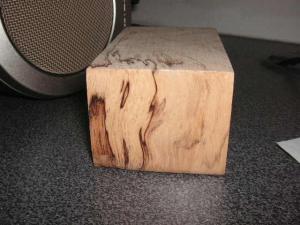

Victor Chew Posted April 9, 2012 Report Posted April 9, 2012 (edited) It needs a wood knob! Making an ebony knob that big without cracking could be quite a challenge. I will try with wood block pictured. Don't know what wood it is but is's so hard that when I cut it at the carpenter's shop smoke started appearing between the blades and the wood even though I was not pulling hard at the cutter travel. Don't know if I will succeed. Edited April 9, 2012 by Victor Chew
