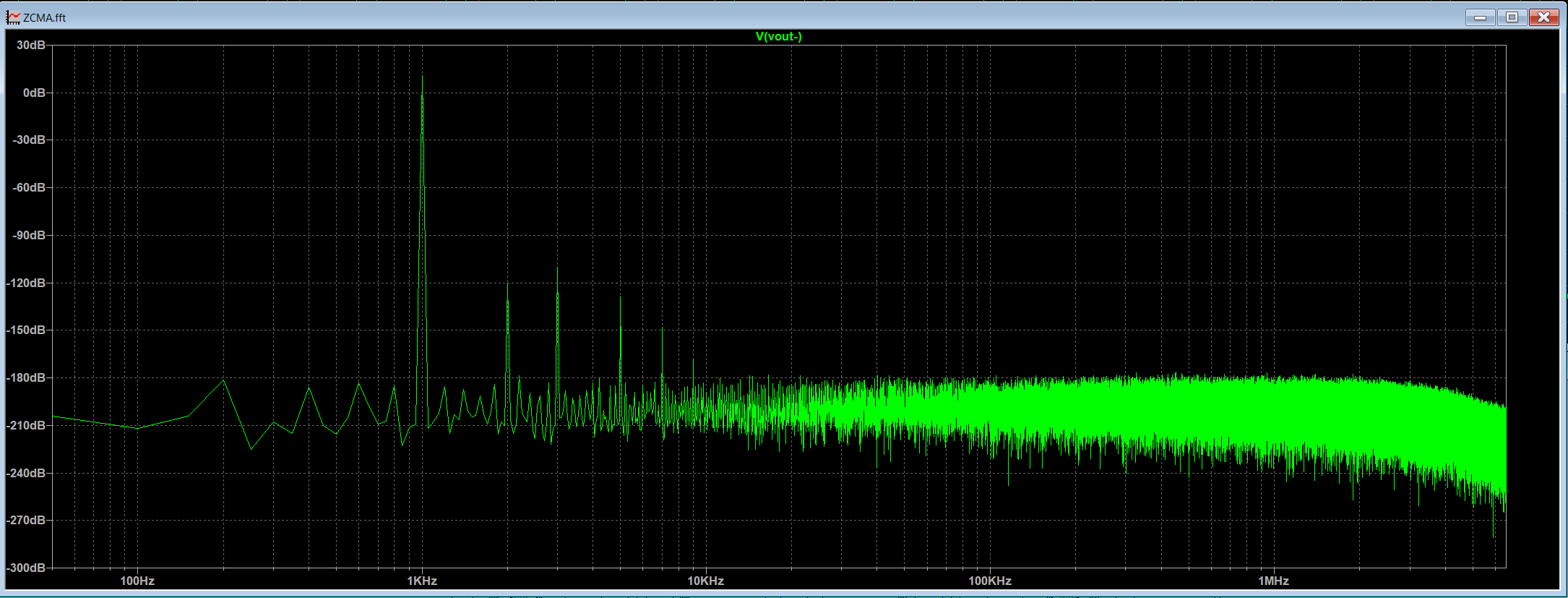

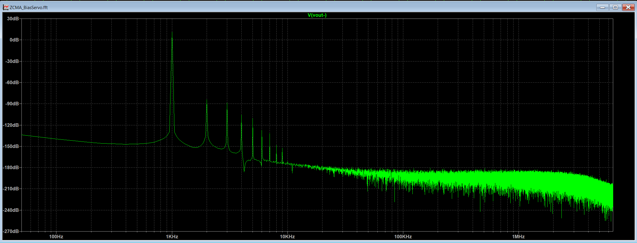

my bad could've just read the previous page more carefully... I did a quick sim on Joamat's "new bias servo", 5Vpp on one side into 32ohm load, ofc not the same amp circuit, not opa445, and not assuming sim == real life behavior, but probably enough to convince me it's not gonna be free lunch. Below is before and after (also tried 300ohm load and difference is much smaller though). Now there is also KG's optocoupler version but between adding another 8 x opa445 and more and just doing thermal coupling right in the first place, well... 😃 And many thanks for the advice and detailed explanation! Yeah I'm aware of the generous amount of feedback used here, much like the original CFA2 right? where CFA3 is changed to open loop design with optional feedback config. I didn't "choose" to go with this way on purpose and haven't built/listened to enough stuff to form a particular preference on the camps between no feedback/some feedback/a lot of feedback (which kinda has a bad reputation). I'm pretty much just randomly exploring options now, for possibly a smaller scale project than CFA3 for my need. Might still jump back on doing the original if I got enough messing with spice -

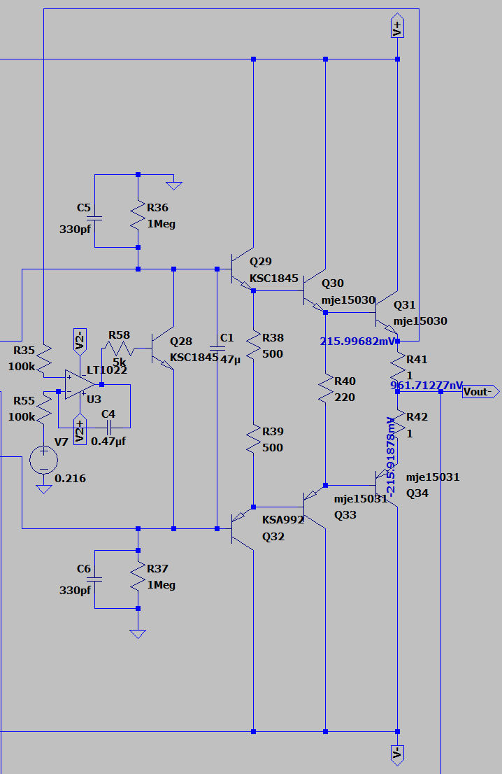

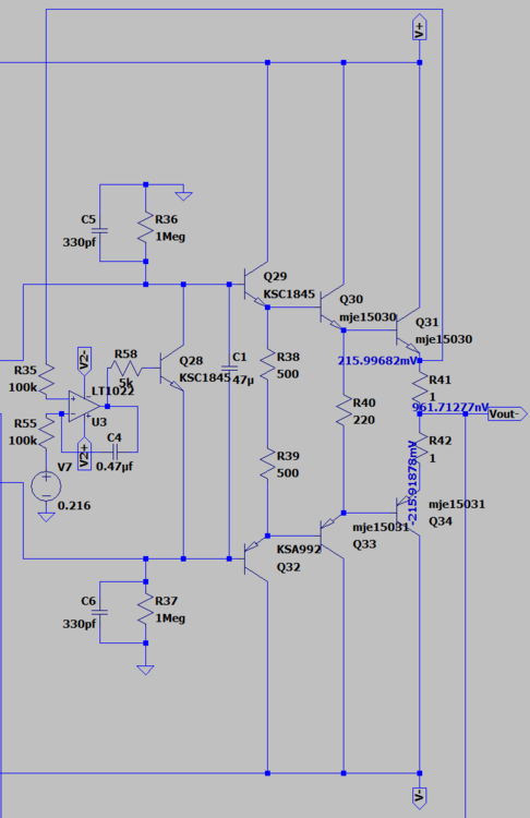

I don’t see how the bias servo could have worked. You have the + input of the opamp connected to the amp output terminal, which means the integrator has a dancing reference that it has no rejection of. Furthermore, a divided down version of that amp output signal is shared with other servos, an interesting way to create crosstalk? -

Thanks @JoaMat, this data is really helpful. From your measurement it does look like I really needed either bias servo or do it like the original for hopefully less drift. Nice soft start behavior too -

I’ve a smd version of CFA3. Only output transistors on heat sink. Bias is servo controlled. Works all right. Output stage with servo looks like this… -
