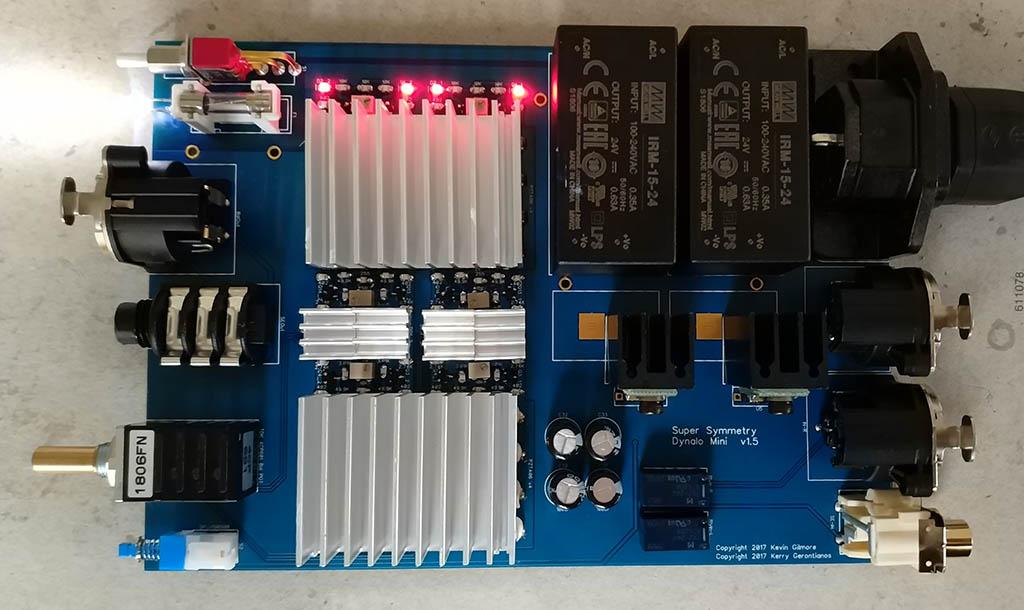

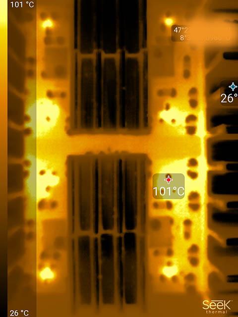

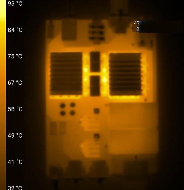

  1. Another smd Dynalo is born, verry happy that i could manage that. First time hand soldering so much smd parts und my eyes getting older. Was not easy but worked out and the sound is great. Gets very hot with the 422 402 ohm, same heat as the one from pars. I use my seekpro form some thermal pictures after 45min, for me ok when i use it but wouldn't give it away with this heat. For the Heatsinks i used thermal adhesive, due the different ems from raw alluminium the thermal camera show the temp to low, they are hotter then the pcb but not over ca 80 c. Hottest parts are the small transistors. Tip to measure raw alluminium with a heat gun stick a black adhesive tape over it. Thanks for the group buy of the pcb, the group buy of the case and all the support i get from this great forum.
