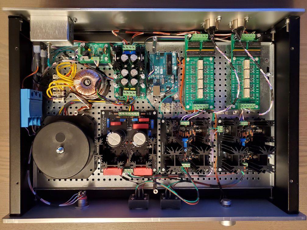

  12. I use a Bourns PDB181-E420K-103B - a bog standard, dirt cheap, linear taper 10K. Completely power off, no standby involved. You can use an audio taper pot easily, you would just have to be more creative with the volume/pos mapping. Can't help you out with the latest version, I'm just a trained monkey building boards that Kerry organised! Just don't get the different versions mixed up. I built and tweaked code for the original v1 with the PCF8574A/ULN2803A combo. The v2 is a completely different chip (MAX4820) and software approach.
  13. Well I'm using a pot for control, and it reads the pot value on startup. Wherever the pot is, it jumps to that volume pretty much immediately, which is the expected behavior. Most implementations with an encoder do save and restore the volume. But I've really gone off encoders for this sort of application; don't like the physical feel, don't like not knowing the volume at a glance.
