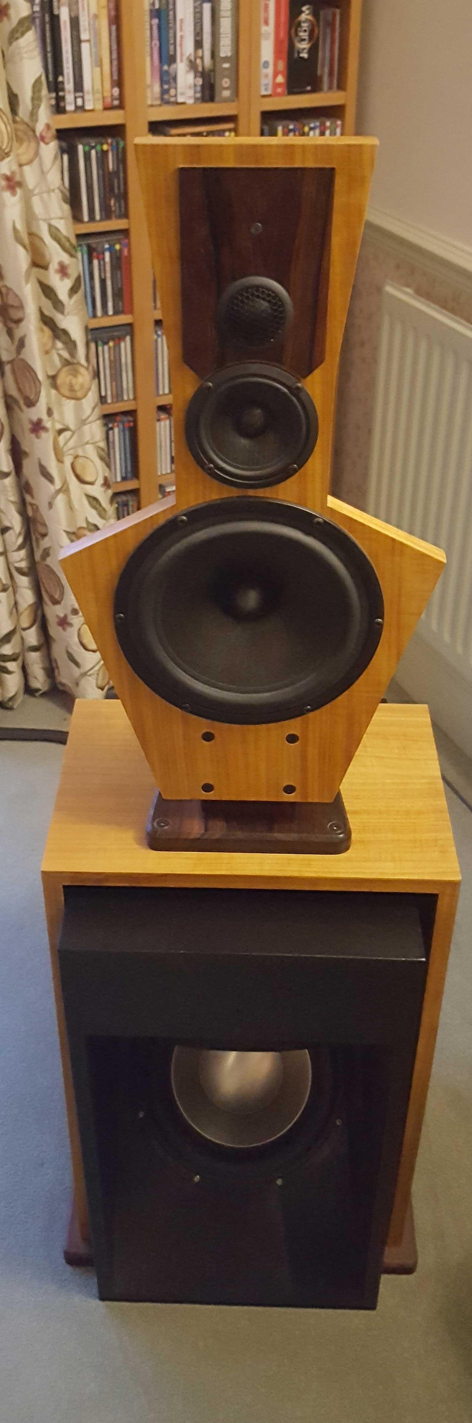

Dusty Chalk Posted May 5, 2020 Report Posted May 5, 2020 You actually own that? Nice. Dig that baffle. 1
Craig Sawyers Posted May 5, 2020 Report Posted May 5, 2020 Not only own - built from first priniciples. The bridge and baffle are traditional hammer veneered using hide glue, and then French Polished. The dark wood around the forward tweeter and the baffle support is Cocobolo, and the bridge feet are Goncalo Alves. The bass unit is spray painted satin back, and then coated in buffed in wax polish. I was going to just paint the whole thing black, but Mrs S said she'd like wood finish - so I used that as an excuse to learn traditional veneering and French polishing. 7
recstar24 Posted May 5, 2020 Report Posted May 5, 2020 8 minutes ago, Craig Sawyers said: Not only own - built from first priniciples. The bridge and baffle are traditional hammer veneered using hide glue, and then French Polished. The dark wood around the forward tweeter and the baffle support is Cocobolo, and the bridge feet are Goncalo Alves. The bass unit is spray painted satin back, and then coated in buffed in wax polish. I was going to just paint the whole thing black, but Mrs S said she'd like wood finish - so I used that as an excuse to learn traditional veneering and French polishing. Much respect to the hide glue. Old school construction, kudos. 1

Craig Sawyers Posted May 5, 2020 Report Posted May 5, 2020 16 minutes ago, recstar24 said: Much respect to the hide glue. Old school construction, kudos. Thank you! Using hide glue is actually a darn sight easier if you make a mistake - plenty of water and a clothes iron (I have 2 really cheap ones in the workshop) re-liquifies the glue and the veneer can be peeled off. If you use regular white wood glue, the only way to recover is to sand the veneer off with a belt sander. If you look closely you'll see the veneer is book matched too. That involves making an invisible seam right down the middle of the baffle. That is standard everyday practice for a professional cabinetmaker. It is more of a difficulty for me as a trained amateur who veneers infrequently. 1
recstar24 Posted May 6, 2020 Report Posted May 6, 2020 20 hours ago, Craig Sawyers said: Thank you! Using hide glue is actually a darn sight easier if you make a mistake - plenty of water and a clothes iron (I have 2 really cheap ones in the workshop) re-liquifies the glue and the veneer can be peeled off. If you use regular white wood glue, the only way to recover is to sand the veneer off with a belt sander. If you look closely you'll see the veneer is book matched too. That involves making an invisible seam right down the middle of the baffle. That is standard everyday practice for a professional cabinetmaker. It is more of a difficulty for me as a trained amateur who veneers infrequently. Yes! My biggest familiarity with woodworking is through luthier friends, I have a bud that makes cellos and another that is an accomplished guitar maker. The guitar guy uses hide glue construction exclusively, and typically his solid tops and backs are perfectly bookmatched to ensure that nice consistent look. Cheers! 2
