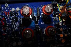

kevin gilmore Posted March 23, 2010 Report Share Posted March 23, 2010 (edited) I only have the 5 pin stax jacks at the moment.... http://gilmore.chem.northwestern.edu/t2burnin.jpg its my new home office system... So it turns out that the servo has a wiring error. Which is REAL simple to fix... Remove and cross R81 and R82... The schematic is right, and the board is wrong... Which is why i was hearing some pumping last night. All gone now... Going to add troubleshooting voltages to the schematic in a few minutes. Got to find some decent tubes (well something reasonably priced before i put $600 of real mullards in there) The dynamics of this amplifier really shines. Edited March 23, 2010 by kevin gilmore Quote Link to comment Share on other sites More sharing options...
Knuckledragger Posted March 23, 2010 Report Share Posted March 23, 2010 Kevin, as a photographer, I humbly suggest you either open up the aperture (two full stops would be good) or crank up the ISO. That latter option is probably better, as the Nikon D3 is the best high ISO performer in the DSLR market, except for the new D3S (which is largely vaporware at this point.) I also think I see a box for a monopod in the background there. [/photo nerd] Quote Link to comment Share on other sites More sharing options...

kevin gilmore Posted March 23, 2010 Report Share Posted March 23, 2010 (edited) Kevin, as a photographer, I humbly suggest ... When i shoot with the lens wide open then other people complain about the lousy depth of field. When i shoot with the lens at maxium depth of field for that lens, people complain about color et all. No matter what i do, everyone is a critic. I have a number of tripods. including the one from the rca tk706. (my favorite 3 TUBE ntsc studio camera) (sadly toast) (and useless anyway) If people think they can do a better job taking pictures at CJ, then they are welcome to borrow my camera. (after they sign over everything they own) There is also a big difference between doing something handheld in the dark, and setting up the tripod and using the remote trigger. I'M LAZY OK... I decided to skip dinner and listen to new music instead. Listening to 11:11 (rodrigo y gabriela) just came in today, wow... The amplifier has stablilized temperature wise, to a very friendly warm. The power supply runs much cooler. I left the infrared temperature meter at work will make sure to put it in my pocket first thing tomorrow. Still, its nowhere near as hot as the original. It is going to be a tight squeeze in my corvette for CJ010 T2 amplifier and power supply sony sacd player cables and power strip stack of music Camera with 2 lenses, tripod, regular and tripple ring flash 35+ bottles of booze clothes for 3 days If i have to, i'll give up the extra clothes And yes i have 4 yorkies. They are yappy. Isolde passed away. Giovanni has cataracts and is mostly blind. carmen is the barker. Insert massive pile of rampant burnin bullshit here. The punch and dynamics of this thing blows me away. That 1900 VPPSS really does wonders for the transients. Edited March 23, 2010 by kevin gilmore Quote Link to comment Share on other sites More sharing options...

Knuckledragger Posted March 23, 2010 Report Share Posted March 23, 2010 When i shoot with the lens wide open then other people complain about the lousy depth of field. When i shoot with the lens at maxium depth of field for that lens, people complain about color et all. No matter what i do, everyone is a critic. Indeed they are. I still say push your camera to ISO3200 or even 6400 (you're currently using 400 it looks like.) The performance of the D3 at ISO6400 is better than many DSLRs @1600. I'll shut up about this now. If people think they can do a better job taking pictures at CJ, then they are welcome to borrow my camera. (after they sign over everything they own) I wish I were going to CanJam precisely so I could take pictures of all the equipment. With my camera or any other. From what I've gathered, meets are really not a good venue to get to listen to equipment but man could I get some gear porn. It is going to be a tight squeeze in my corvette for CJ010 T2 amplifier and power supply sony sacd player cables and power strip stack of music Camera with 2 lenses, tripod, regular and tripple ring flash 35+ bottles of booze clothes for 3 days Something stands out about that, I'm not sure what. Quote Link to comment Share on other sites More sharing options...
