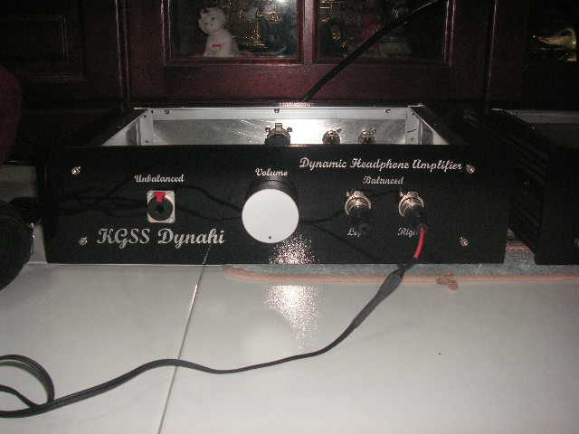

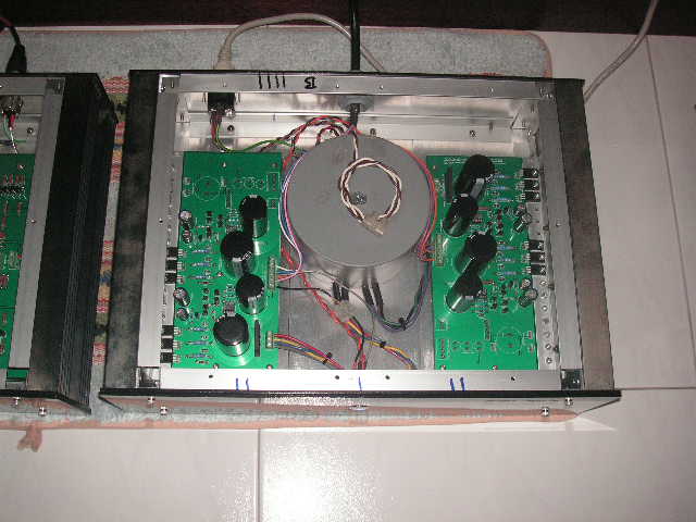

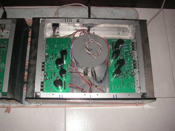

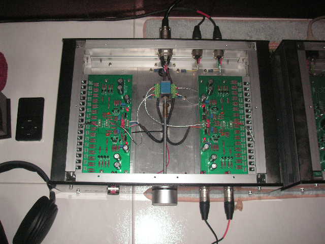

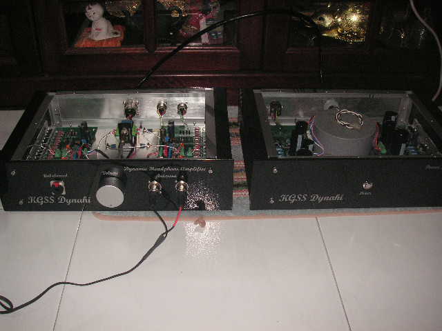

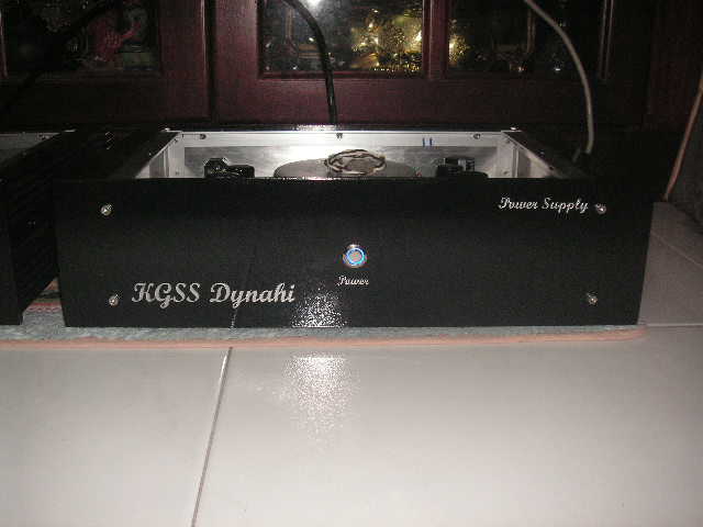

  • Finished my Dynahi this week, a big thanks to Kevin Gilmore making this project possible. Was a more or less ;-) troublefree build, thanks to this forum i get the needed information, thanks to all. I
Picture of my almost completed Dynahi. Top plates still have to be painted and lacquered. It sounds lovely. Thank you Kevin for this lovely design.

Looks good. Did you get the offset down to more manageable levels? I try to get the offset to within 1mV on dynalo/dynahi before I put the servo opamp in. Not sure if anything has changed on these boards with respect to that versus the old single boards or not? I'm aware of the input section being true balanced now vs. the previous mono boards. I wouldn't expect that to change anything.
Thanks Pars. Manually, I was able to get it to about +-3mv for the dc offset. Patience was the key. With insertion of the opamps the dc offset achieved 0mv. Was also able to get balance to 0mv.
Good to hear. Yes, patience is required :lol:
Thanks John.
