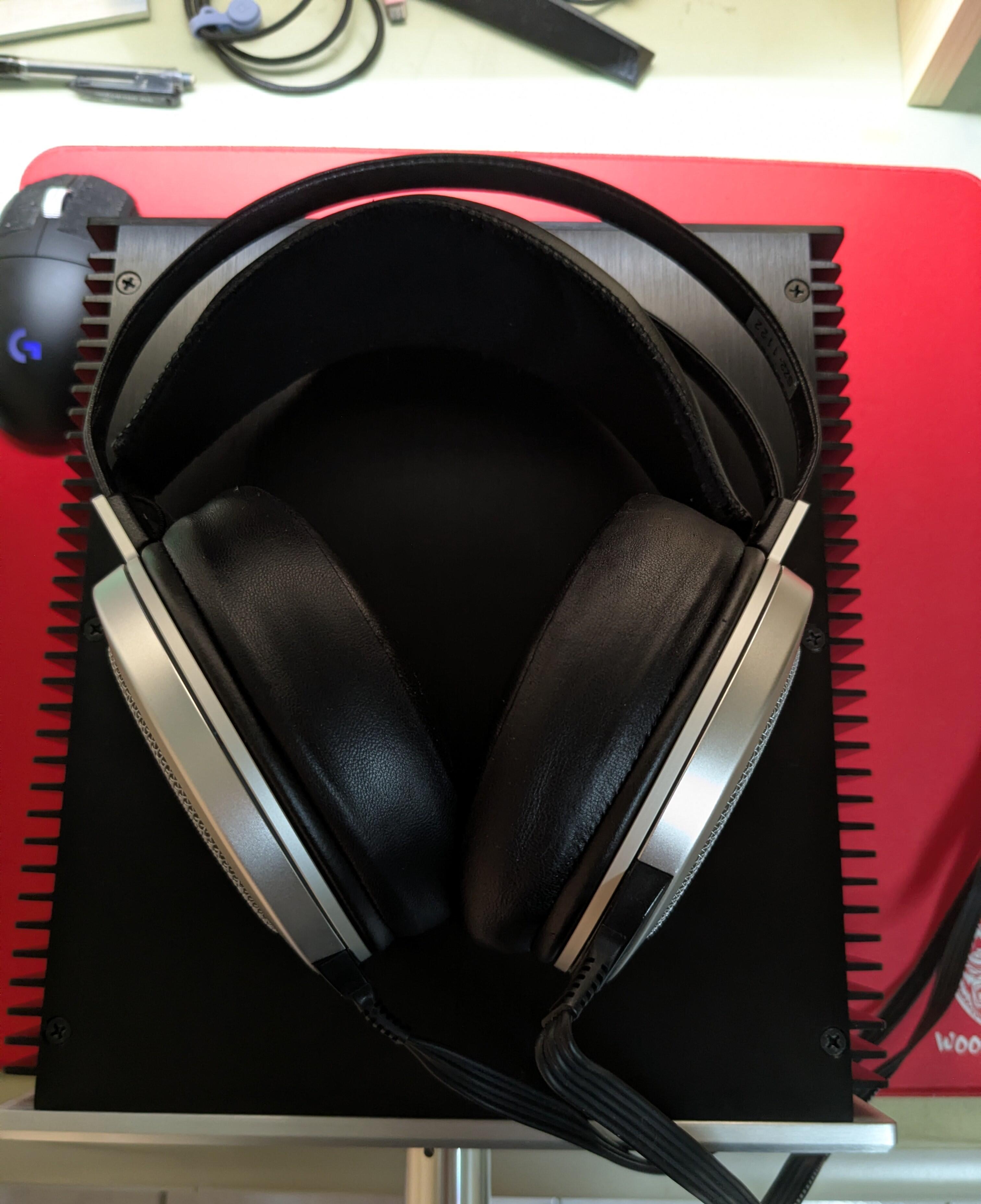

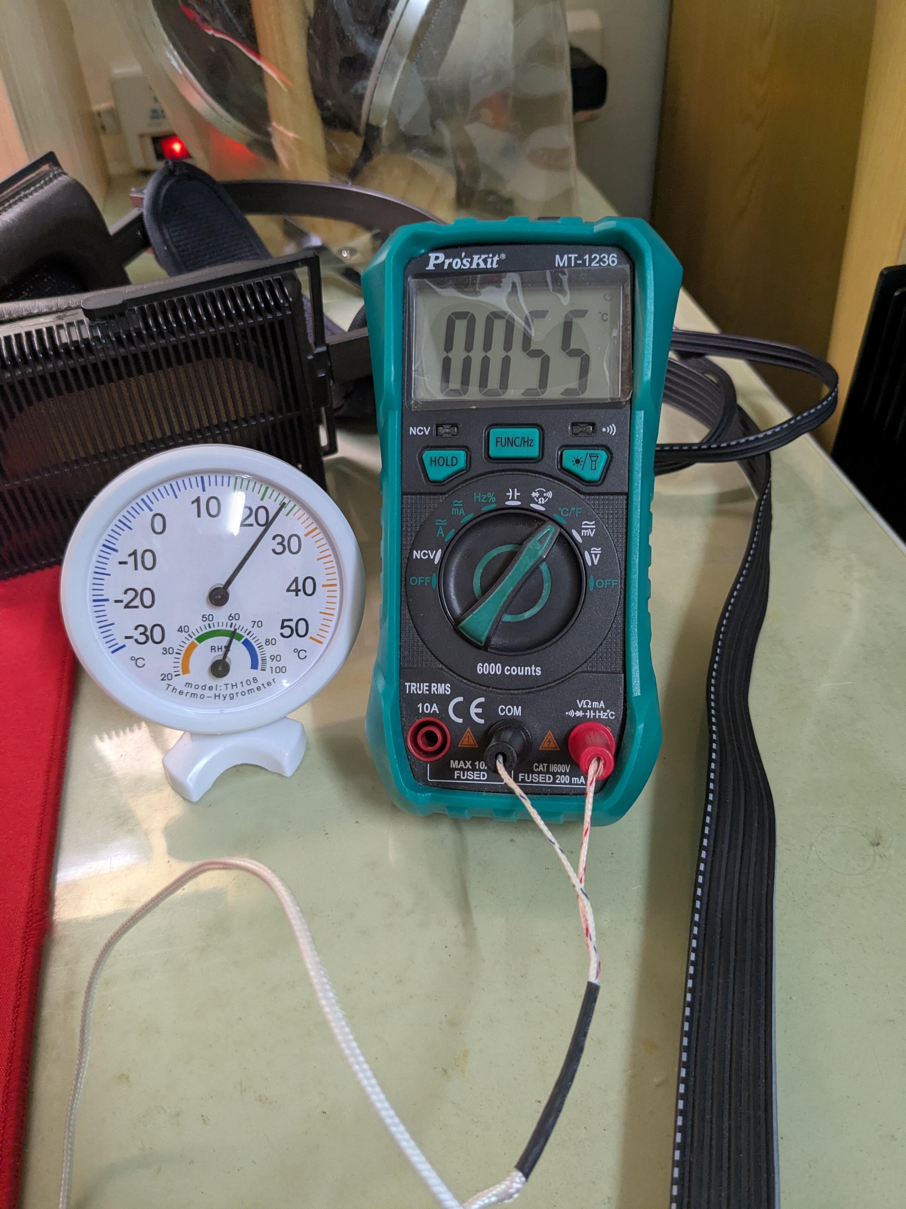

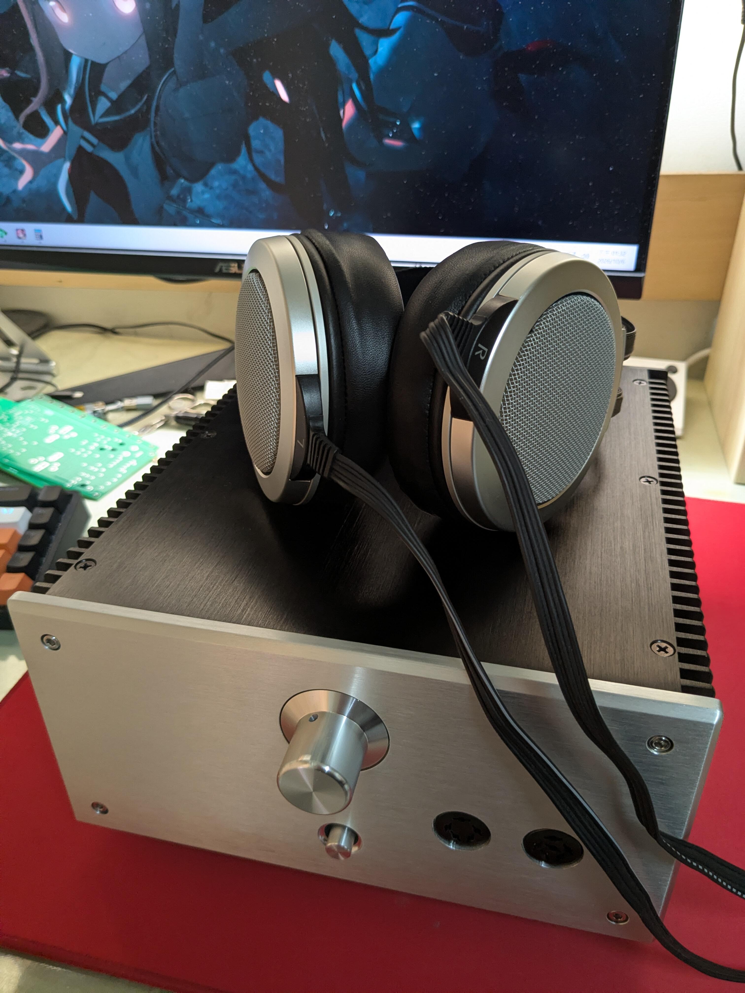

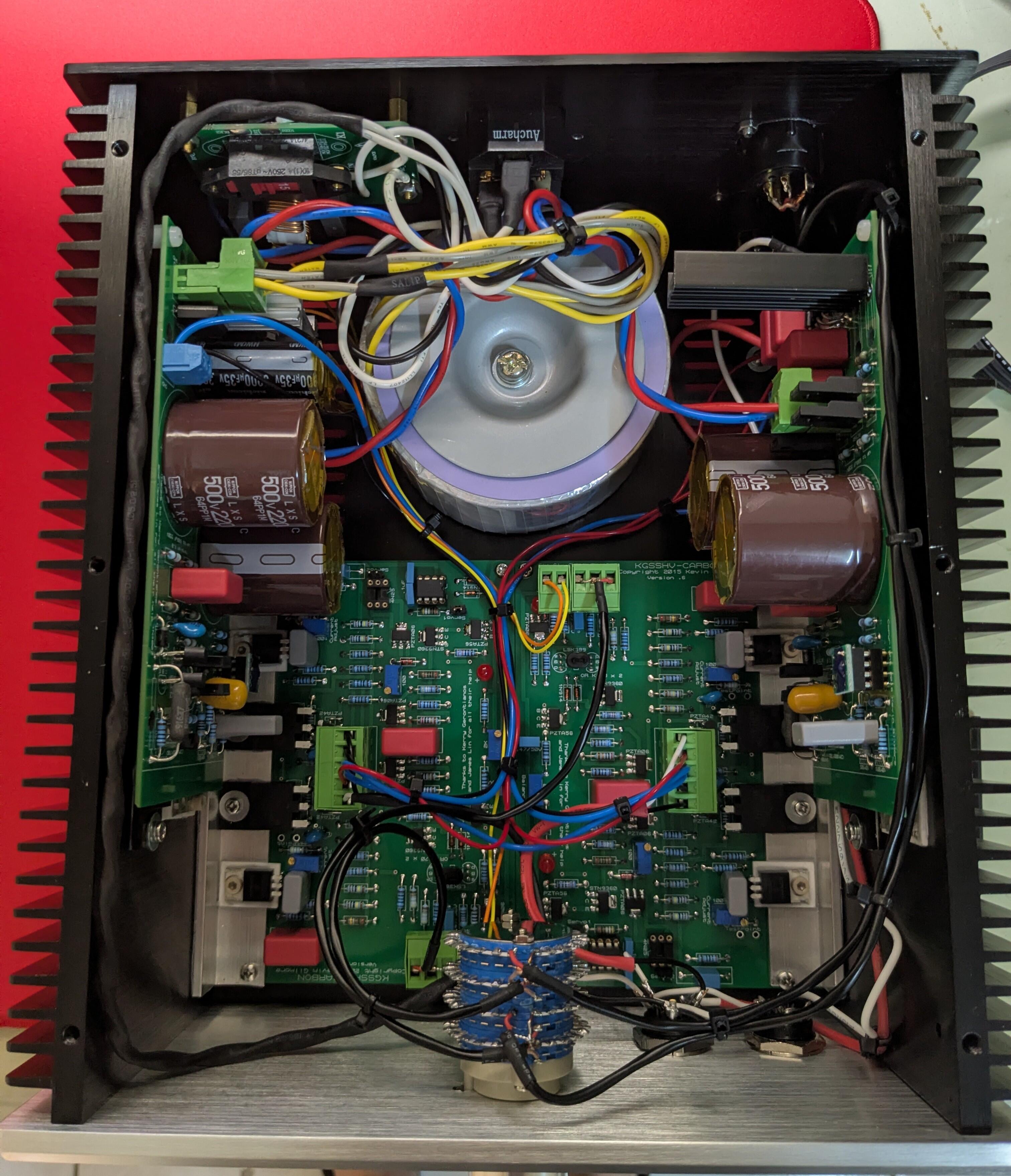

  2. First post here, just want to share pictures of Carbon I built. My goal is as small as it can be. Use c3m0900170m instead of c2m1000170d (to-3pf version of c3m0900170d), lm4040-10 instead of lt1021-10, ksc5042m instead of ksc5026m, 2sc2705 instead of pzta42 (easy to buy from local shop). Two output sockets from Stax for pro bias and normal bias. It runs at 400V, 20mA. Heatsink temperature is about 55°C after an hour (ambient temperature is around 24°C). No short, no magic smoke, everything seems fine. 🙂
