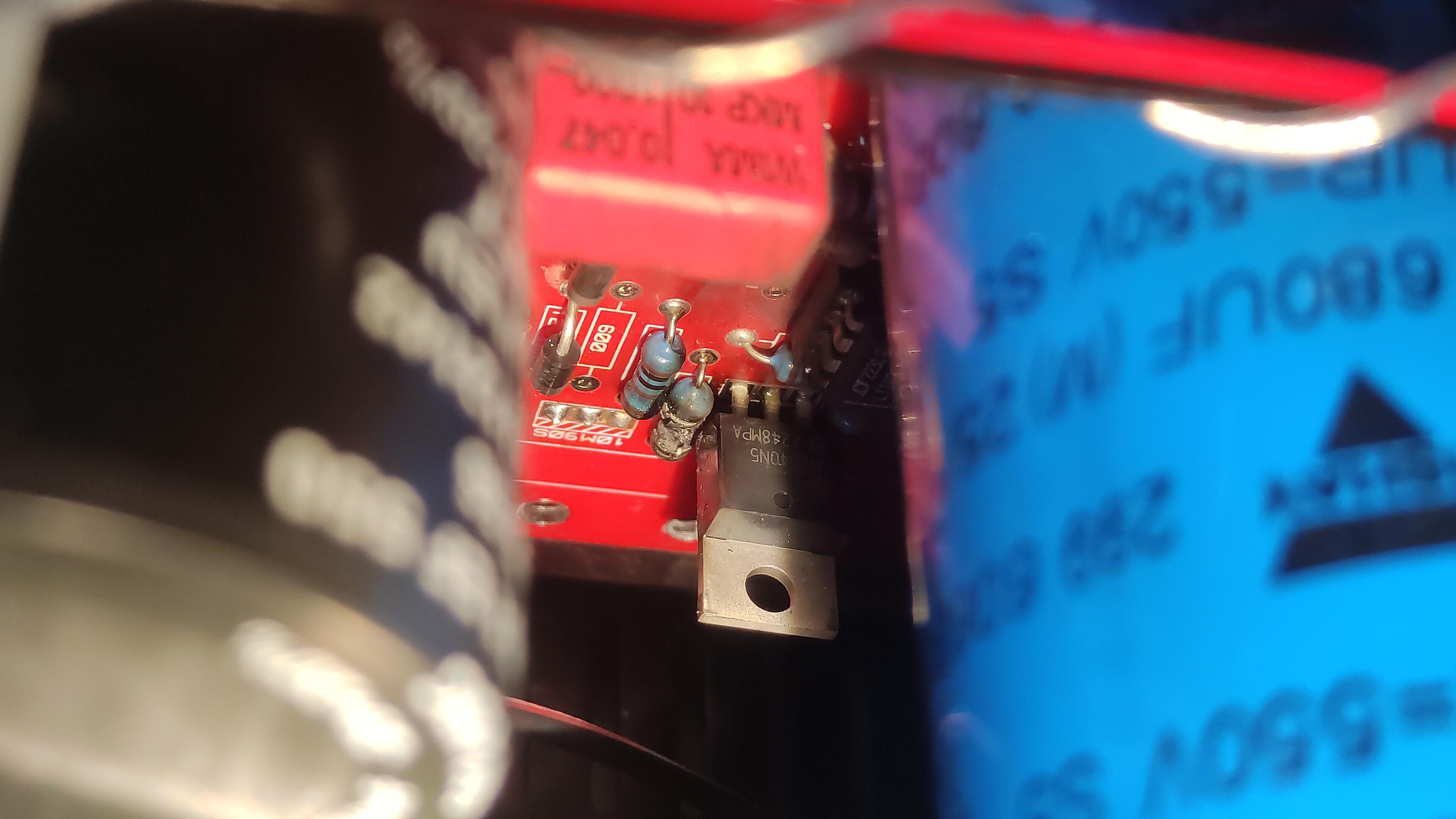

And so, yesterday was the great day of final close in the enclosure, it played flawlessly for a couple of hours, I came back at it for some music after dinner and PAM! A resistor burnt down with sparks and a flame in the region of DN2540 in the B+ board. Me sad . Have to tear it down again to investigate about arcing or whatnot, a nice picture of the event, so that you can smell that burnt chicken flavour 😁 More importantly, forgot to say that that PAM took along my DAP, as if a 450V discharged to ground suddenly, and my Fiio player (5 yo thanks God) broke down, not to restart anymore. One more thing to repair. 😒 I've seen someone experienced something similar, but mainly in the amp board, never on the HV one. Possible cause?
