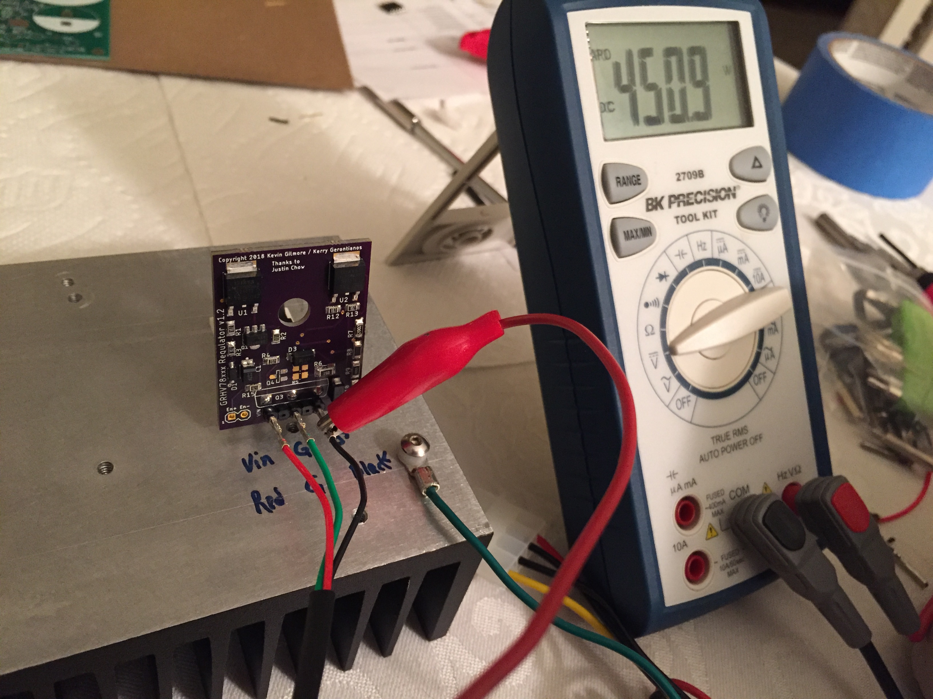

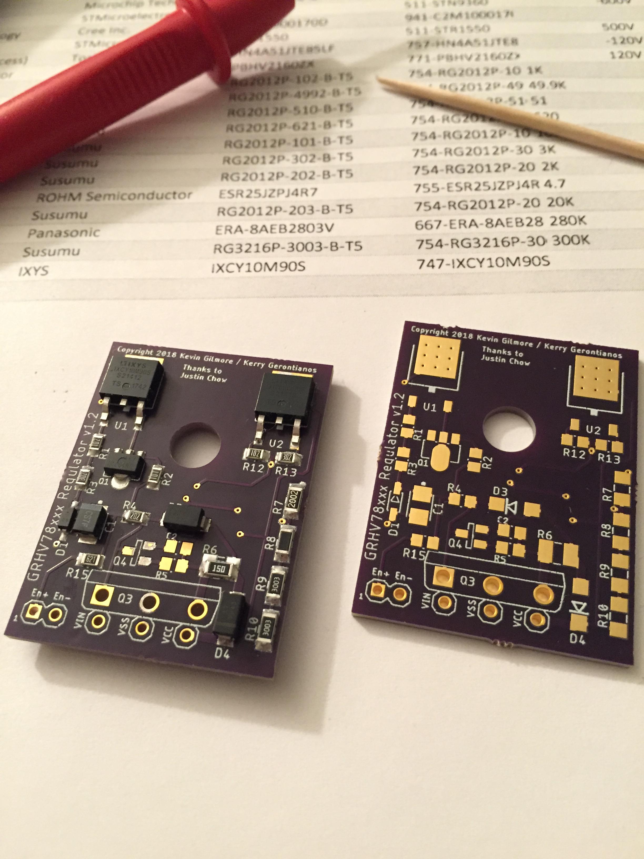

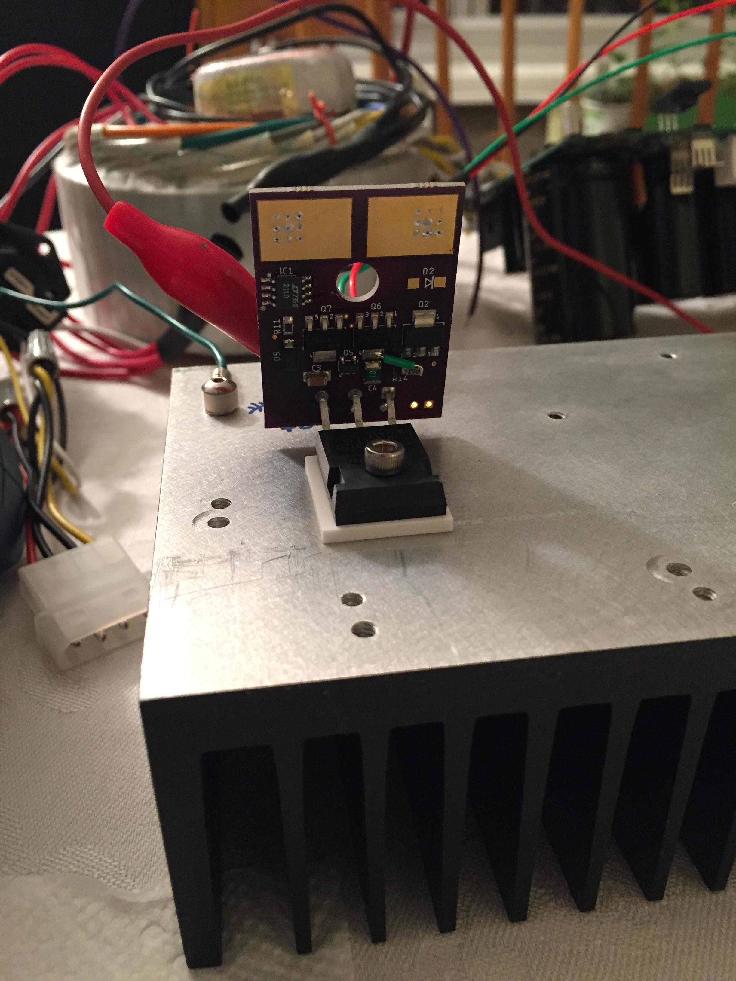

  2. I was able to get the 450v supply up and running. I did have one error on the board. The current source feeding the 10v reference gets up to 150 degree F, but I can add more copper around it. I think it will be just fine. I was running this with a 110mA load.

  10. Here's the HV version set to 450v. Have to test this one still.
