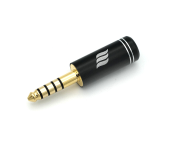

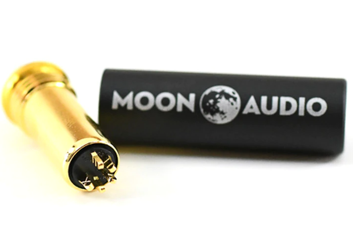

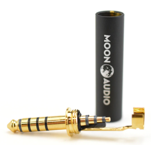

After hearing what these high-end DAPs can do it was an easy choice for me to make. Desktop systems always going to sound better, but something like the iBasso DX220 MAX and slightly modified Sony NW-WM1A/1A have really push the boundary on what portable/transportable DAP can do. It isn't that far behind the mini Dynalo and you can take it with you every where. AT cans are easy to power hence my recommendation. Agreed about buying used. However, one can buy the Black Dragon in bulk at $14/ft or buy DIY litz from Norne (better quality). I usually go with the Black Dragon (BD) because it is easy to work with and the BD does wonder on brighter sounding headphones such as the HD800S thanks to its warmer tonal balanced. Moon Audio also make many nice connectors (not cheap) but they are easy to work with. I also have a good success with Effect Audio 4.4 mm connectors. https://www.moon-audio.com/moon-audio-4-4mm-female-connector.html?gclid=EAIaIQobChMI67PDu-m77AIV9YJbCh1A3gIEEAAYASAAEgI2WPD_BwE https://www.moon-audio.com/moon-audio-4-4mm-trrrs-balanced-connector.html https://www.effectaudio.com/accessories/ea-4-4mm-connector.html https://www.moon-audio.com/black-dragon-headphone-cable-bulk.html https://www.moon-audio.com/furutech-fp-705m-r-4-pin-balanced-xlr-connectors.html?gclid=EAIaIQobChMIoIzl5-u77AIViuzjBx0QCAMKEAAYASAAEgI5QvD_BwE http://www.norneaudio.com/litzheim/Norne-Audio-22-awg-occ-ohno-continuous-cast-ultra-pure-cotton-core-copper-diy-headphone-cable-wire-cables-wires-solder-ciem-iem-full-size-aftermarket-up-7-n-6-upgrade

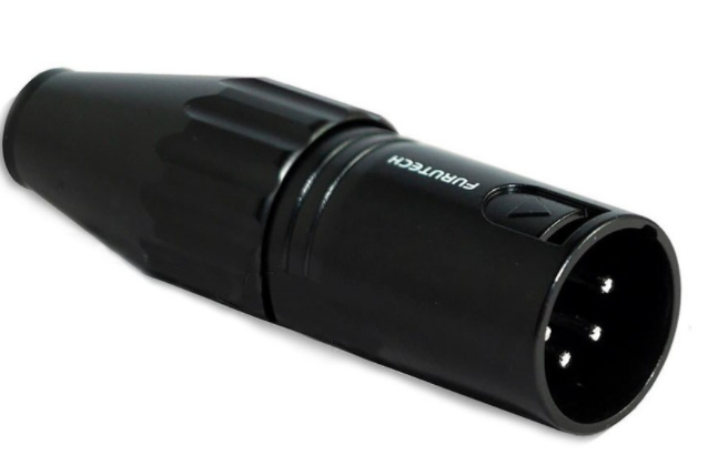

I was once a member of a team 4 pin XLR, but earlier this year I reterminated all of my headphones from 4 pin balanced to 4.4 mm balanced. Many top end DAPs are approaching a really good desktop system hence my suggestion plus the L3000 is super easy to drive. You can always make an adapter going from 4.4 mm back to 4 pin XLR or whatever. Furutech makes really good 4.4 mm plugs and Moon audio make a high quality male and female 4.4 mm as well...same can be said for Eidolic. I think you guys will think the same once you give a 4.4 mm balanced a try. Even my HD800 is reterminated with a 4.4mm Furutech balanced jack. Sony NW-WM1A DAP actually do a good job driving the HD800.

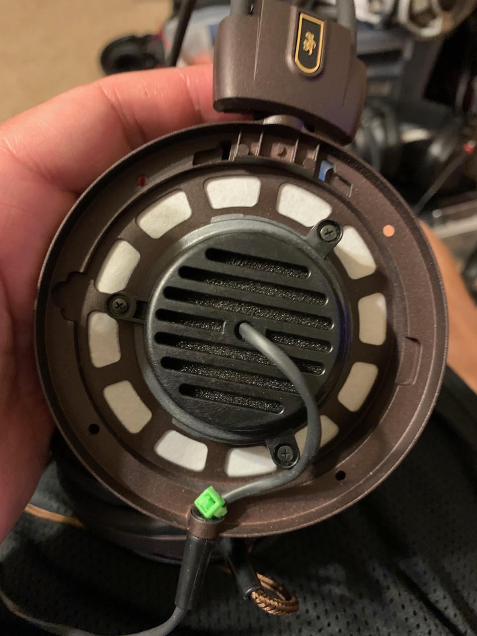

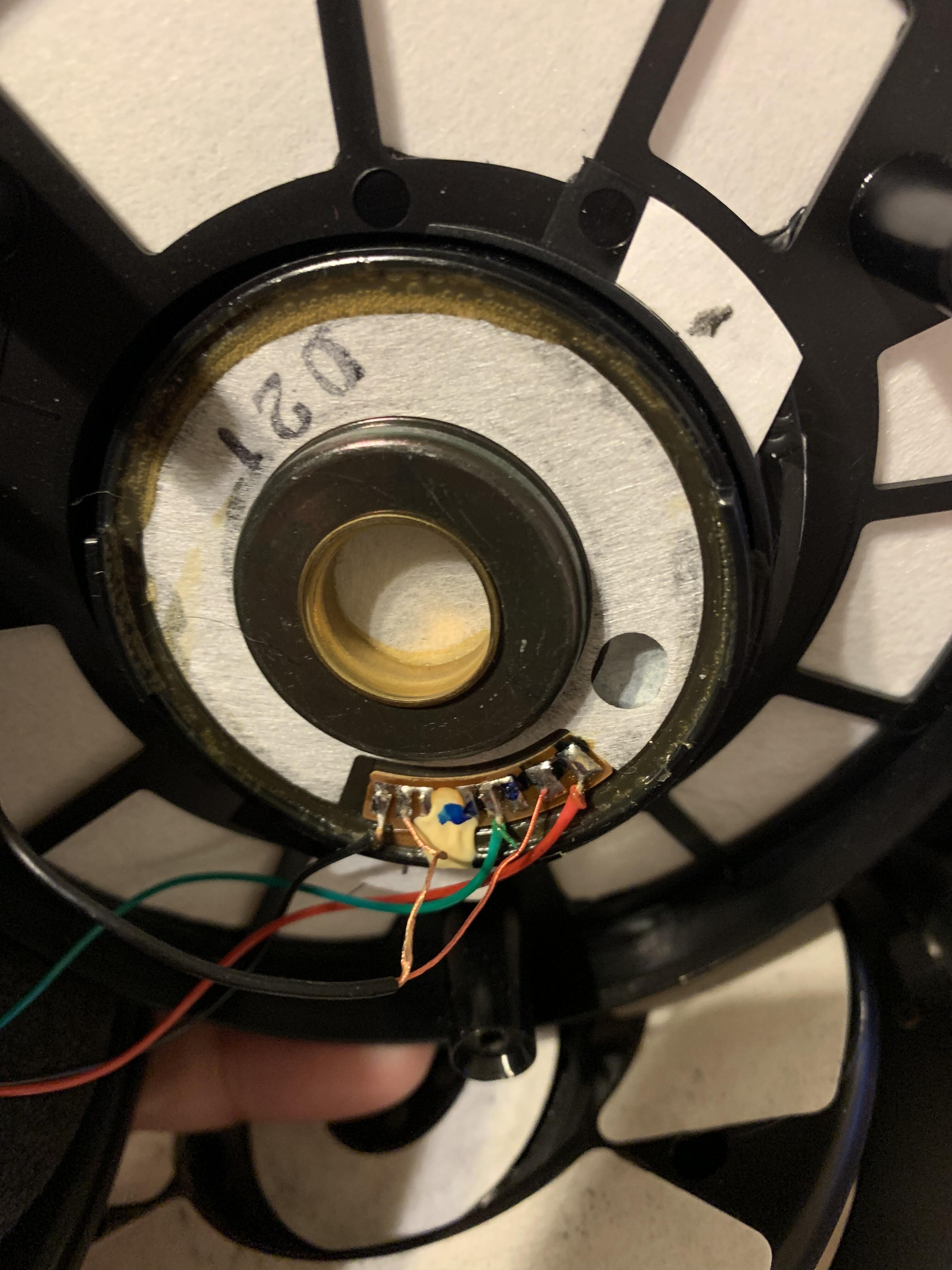

Not difficult to recable the L3000 at all. Remove the earpads, screws (4 screws holding the earcups and another 3 holding the driver assembly in place), and you should get to the driver. I suggest a high quality silver cable to enhance the resolution, open up the soundstage, and tighten up the bass impact. I recabled my old pair with Moon SIlver Dragon Gen 1 but this was probably around 7 - 8 years ago before I sold it to a local friend. I recently recabled my 3000ANV with the left over SIlver Dragon and the work was not difficult at all. If you are handy with soldering iron, it can be done ..... just take your time and be careful. Take pictures before and after removing the driver holder assembly...you want to line up everything the same way. Here are some pics of my W3000ANV that I recabled last week. The internals are more or less the same as the W2002 & L3000. You can do it. While at it, get them reterminate with a 4.4 mm balanced connector. The L3000 isn't that difficult to drive and many top end DAPs of today can do wonder with these headphones. Plus, they do sound considerably better driving from a a balanced amp. They sounded spectacular out of my Balanced Gilmore Reference amp at that time.
