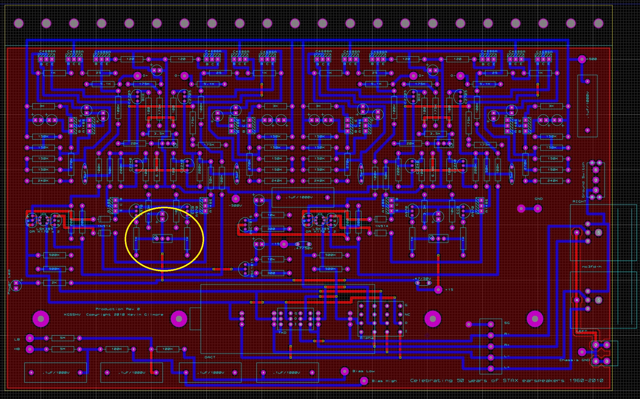

  1. C1 and C2(5pF) missing I forgot, the 170/389 silks and stuff look good(I can't read the DGS but regardless it's correct by the silk)
  2. You are right. What about RV2/R44/R45? Is Rev 0 the correct board? EDIT: correct amp board

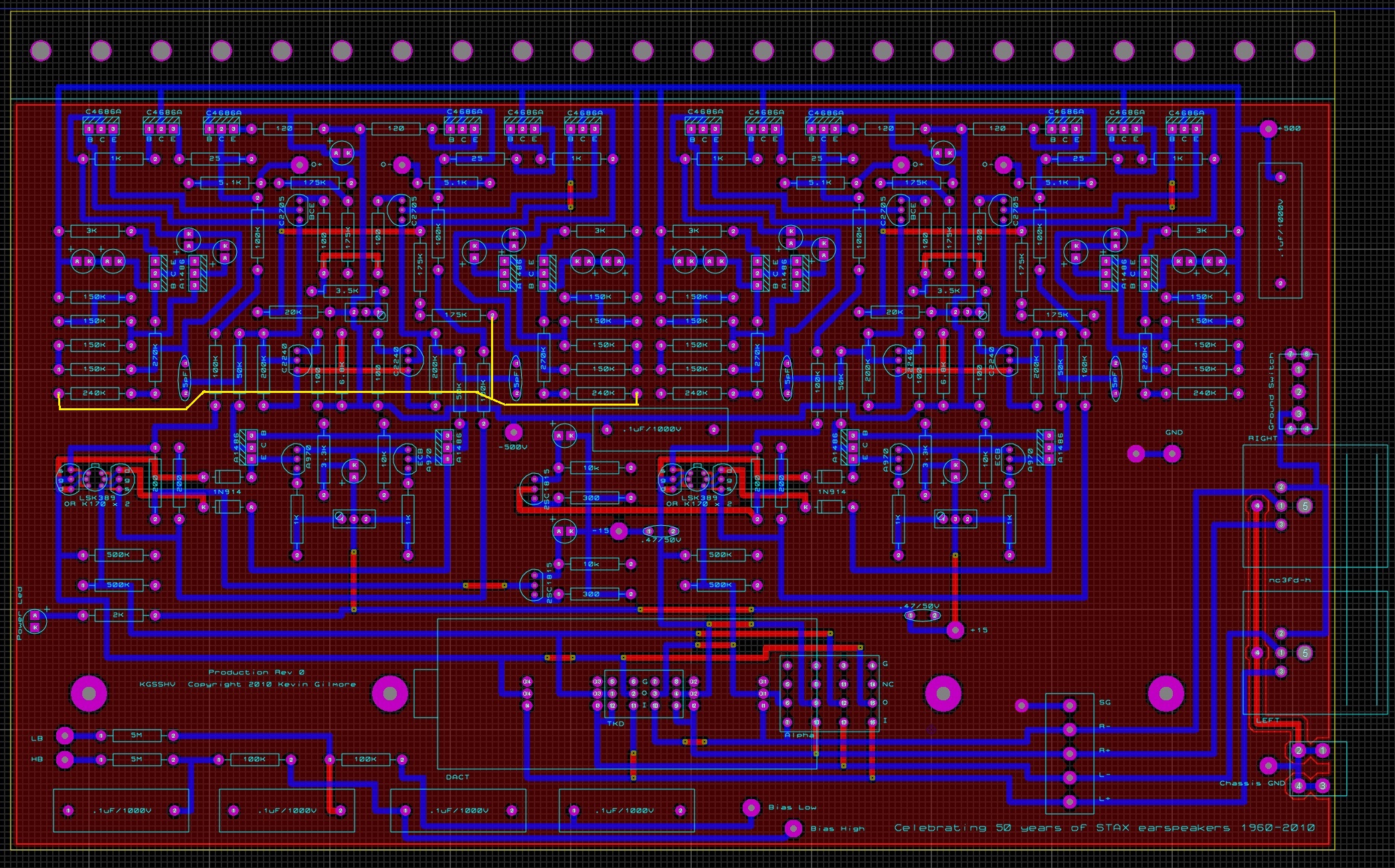

  3. ...and tied to ground somewhere.
  4. Wiper should be connected to -500. Same for both channels(same for last post above also)

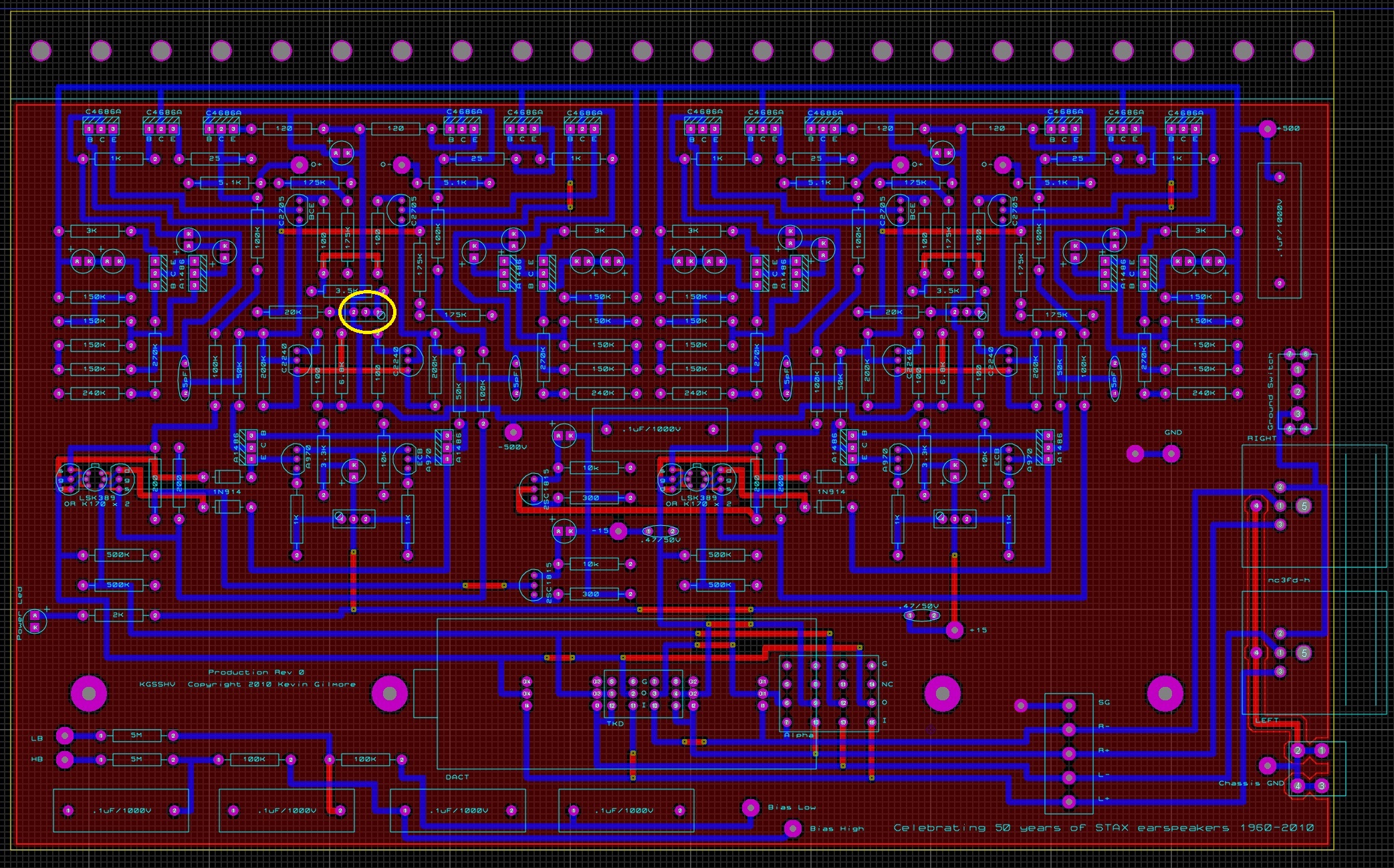

  5. I only circled one channel. All of the ECB/jfet pin designations look correct to me.
