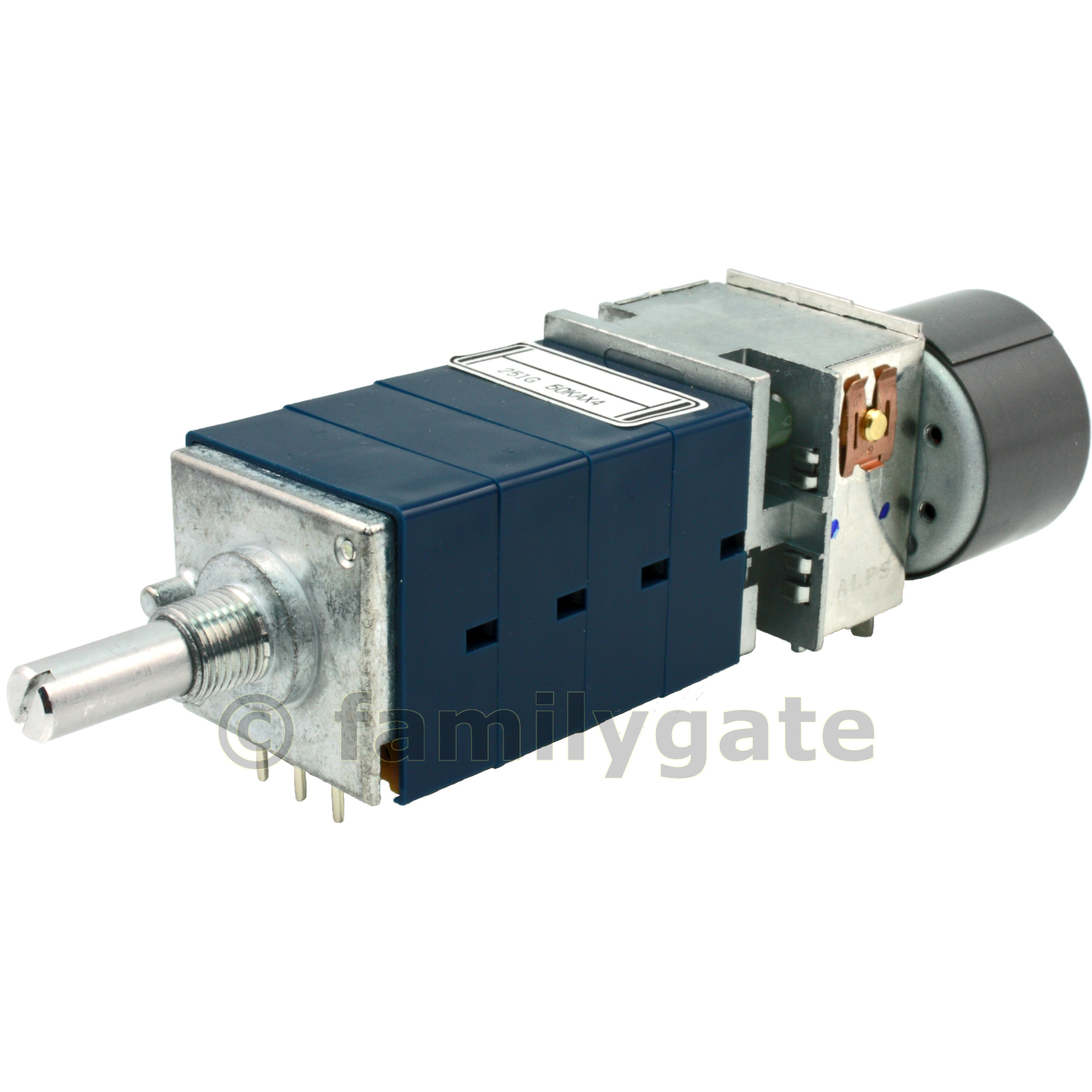

It looks like this other than mine has the flatted shaft:

Found that there is nothing wrong with the pot. When I saw that the measurements of each section at a particular rotation weren't really far off, it didn't jive with what I was hearing.
I found some connection issues; 2 crushed pins on the L out from the pot, and 2 broken wires on the input cable from the L jacks (that were still making some connection). Once fixed, it sounds much better now.
