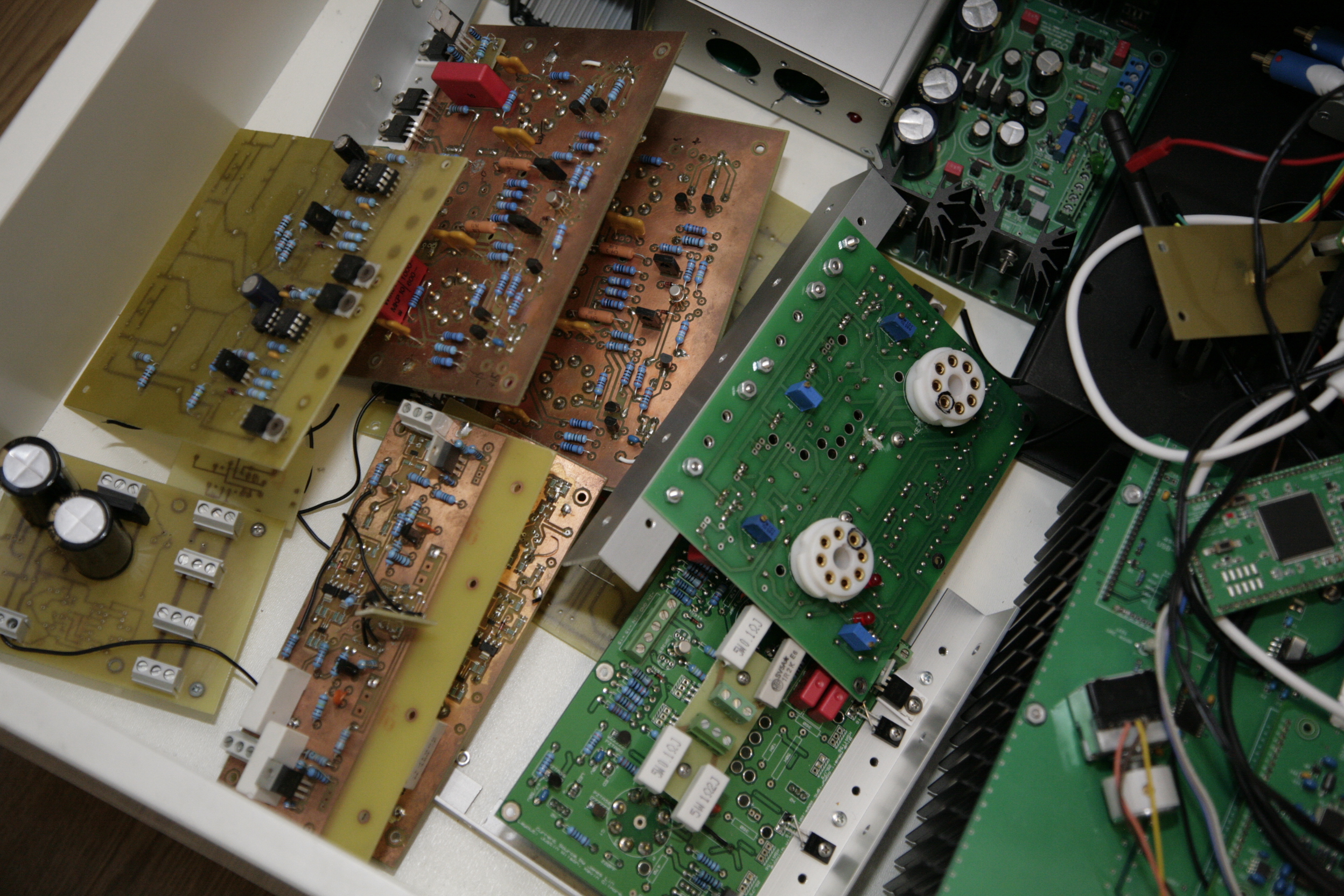

    Finally done! I regrettably sold my previous KGSSHV Carbon a while ago, this one’s not going anywhere soon. This is a 400V, 19mA version, using the ground plane amp board, Sumr transformer a
  • My own Carbon, not going anywhere... IMG_6585 IMG_6590 IMG_6592 IMG_6593 IMG_6595 IMG_6596 IMG_6597
1 hour ago, Pars said:
Same here. Single sided sandwiched with double sided blanks? I'll give you an A for creativity! I personally will stop at 2-layer, and commercial houses are so cheap anymore I don't bother with those :rolleyes:
Yes, single plus double. I’ve a CNC machine. Drilling the board is easy, fast and precise. Milling. Boards are done in a couple of hours. Making the vias  and building the two boards together went very smooth. My first attempt - maybe beginners luck.
