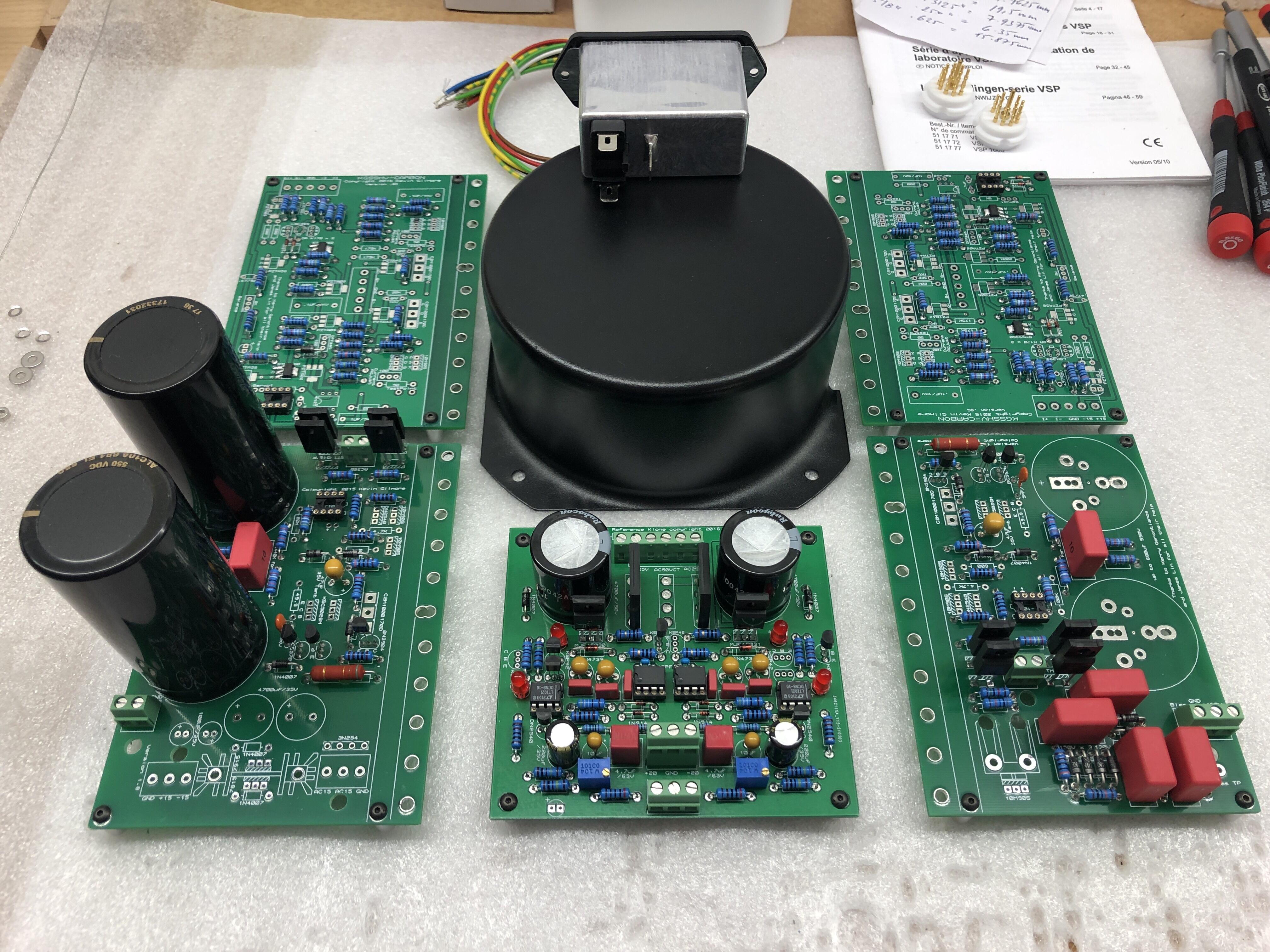

Stuffing some Carbon boards over here while waiting for parts...

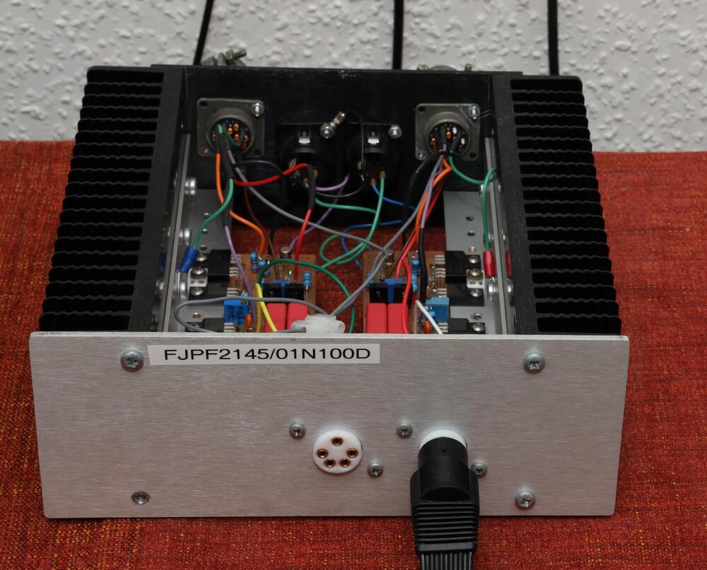

On 3/31/2021 at 10:24 PM, JoaMat said:
Here is a version with FJPF2145 in stead of 2SC4686 and 01N100D replacing 2SA1968. The file name is xxx_Mouser to indicate components are available at Mouser.

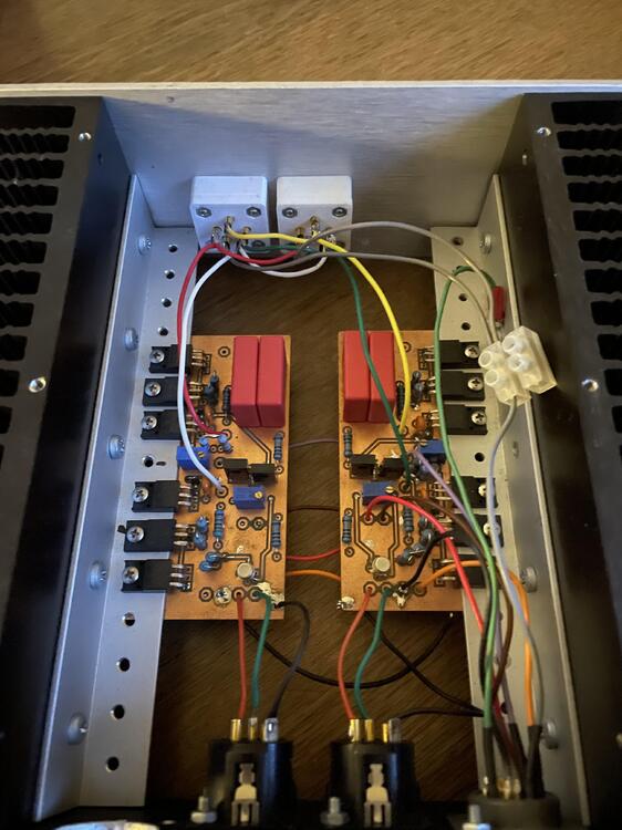

Yesterday I completed the left side board and I’m listen to it this very minute. I’m very pleased with the outcome.
Has been in service for a few months now. Sounds alright.

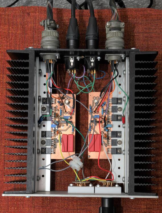

Is this a Carbon with external PSU? Looks awesome, JoaMat!
Edited by starcat
Thanks guys.
Yes, external PSU (T2 PSU with some addons). Maybe one can’t call it a Carbon since output stage is formed by NPN BJT - but else it’s similar.
I think current is like 10mA. 300R emitter resistor and two LEDs in series. With +/-400V the heatsinks are “hand warm” and you can probably double the current.
As most other DIYers I use Teflon Stax connectors with a small PCB. But on below amplifier I use 3D printed connectors with female golden contacts from Neutrik 3 pole XLR. And they seem to work really well.
On heat sinks are 4 groups of c4686/a1968/c4686.

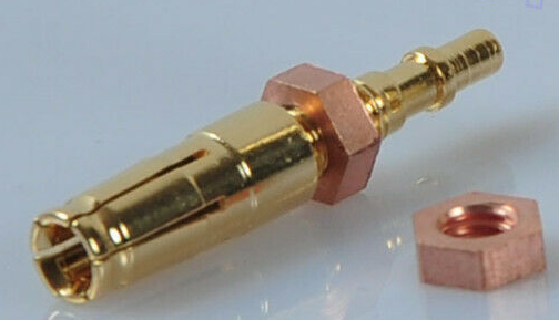

1 hour ago, mwl168 said:
This is what I used for the socket pins: https://www.ebay.com/itm/143522733990?hash=item216a9f1fa6:g:chUAAOSwga9eN~R4
They are intended for tube sockets but work very well for Stax sockets too.
Yep, those tulip pins were the ones used in the jacks I got from luvdunhill about 10 years ago. A bitch to solder, but they haven't let me down yet!
