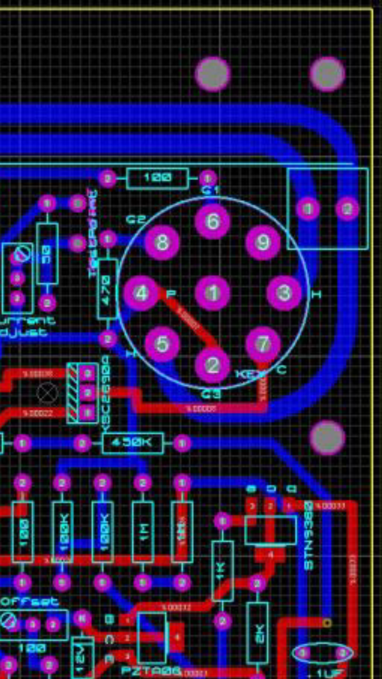

Another couple of questions on grid connections in the output sections’ triode wired EL34s in the GG.
1) Per the GG PCB, and also the KGBH schematic, G3 (the suppressor grid) is tied directly to the cathode.This is the conventional connection for a grounded cathode circuit. In a grounded grid circuit where the cathode is driven, wouldn’t the added G3 parasitic load be harder/non-linear to drive?
2) In the DIY T2 and T8000 Sandwich PCBs, G3 is directly connected to the Plate. circuit. Is the suppressor function really needed in a grounded grid triode? Seems like driving the cathode only would be optimum in a grounded grid circuit.
3) Does the STAX T2, or DIY T2 have a history of being harder on the output EL34s’ G3, than a KGBH? I searched and could not find any mention of this.
4) Any advantage to cutting and modifying the traces on my GG PCB to try out the G3 to Plate connection?
Thanks for any advise offered.

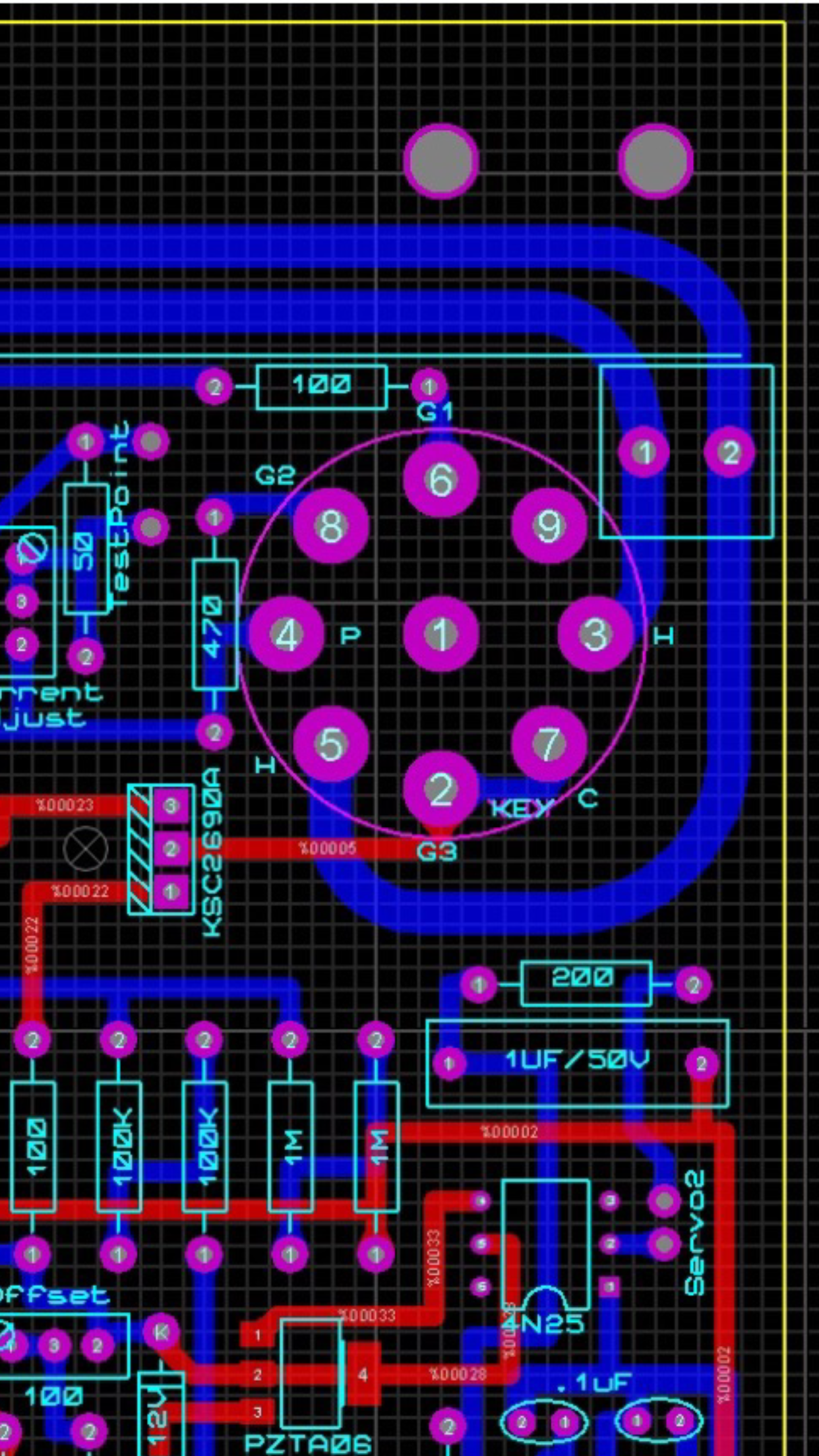

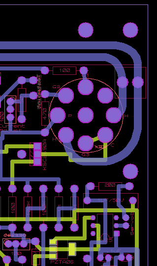

@Laowei: Just curious, what GG board file are you using?
What I'm looking at has slightly different traces layout (was posted 20160224). Can you check yours if its newer?
The graphic is from earlier in this thread where the PCB was first posted. It matches the traces on my PCB. Both appear similar and no printed Revision level is found. I bought my boards from another member, so probably the first.
Kevin quickly drew up the GG (a tube version of the Carbon) to humor us vacuum tube Luddites.
Your example looks like a later version. Basically the same, just tidied up a bit. The amazing thing is, even the quickie electrostatic amp designs that Kevin publishes, are simply incredible sounding. He is an irreplaceable source of inspiration for us DIYers.
