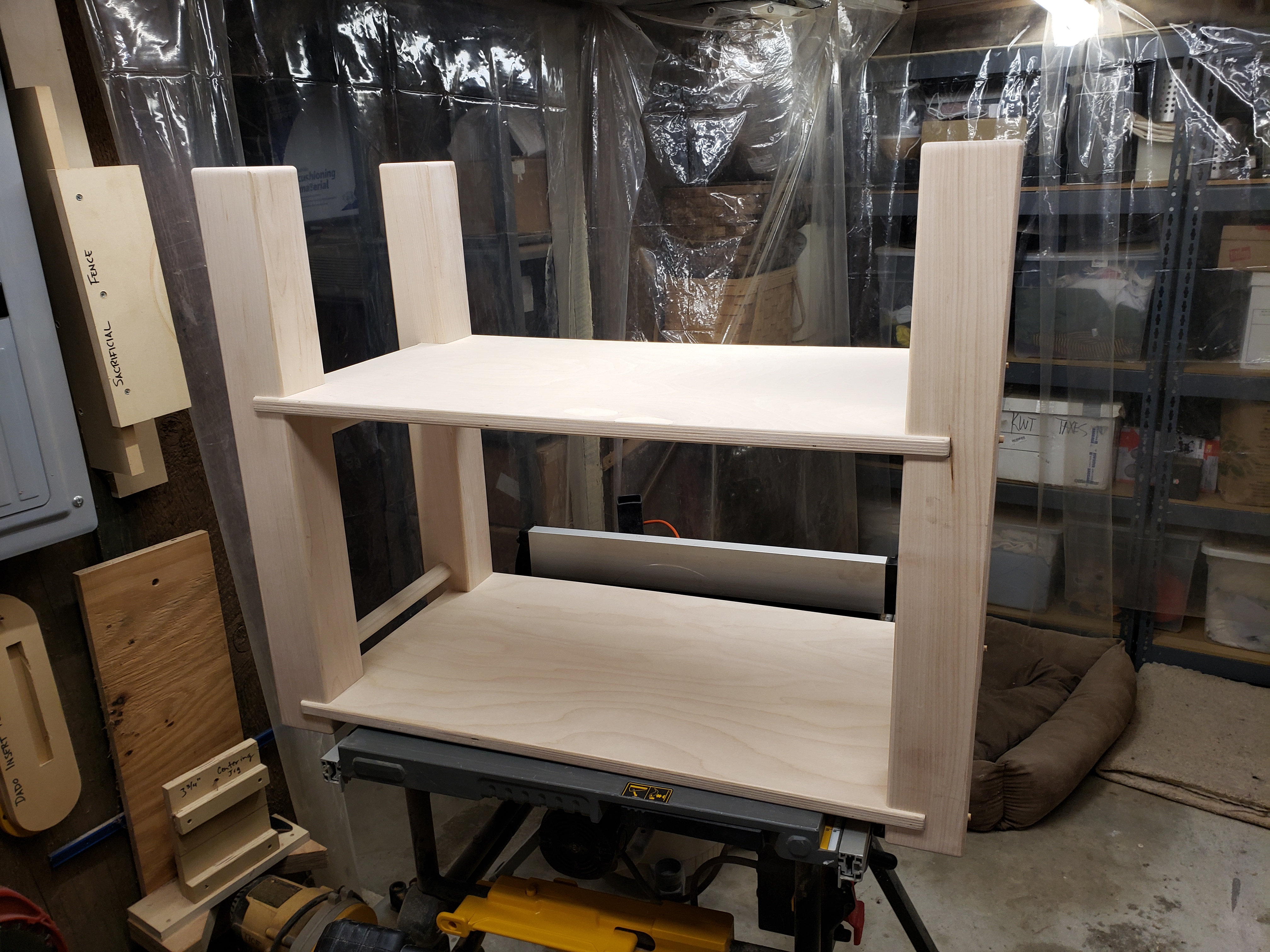

swt61 Posted December 1, 2020 Report Posted December 1, 2020 Jeff, the Purple Heart is really hard, and very prone to burning when cut and routed. Use a very sharp blade! As for me, got more work done on the Colossus stand. 10

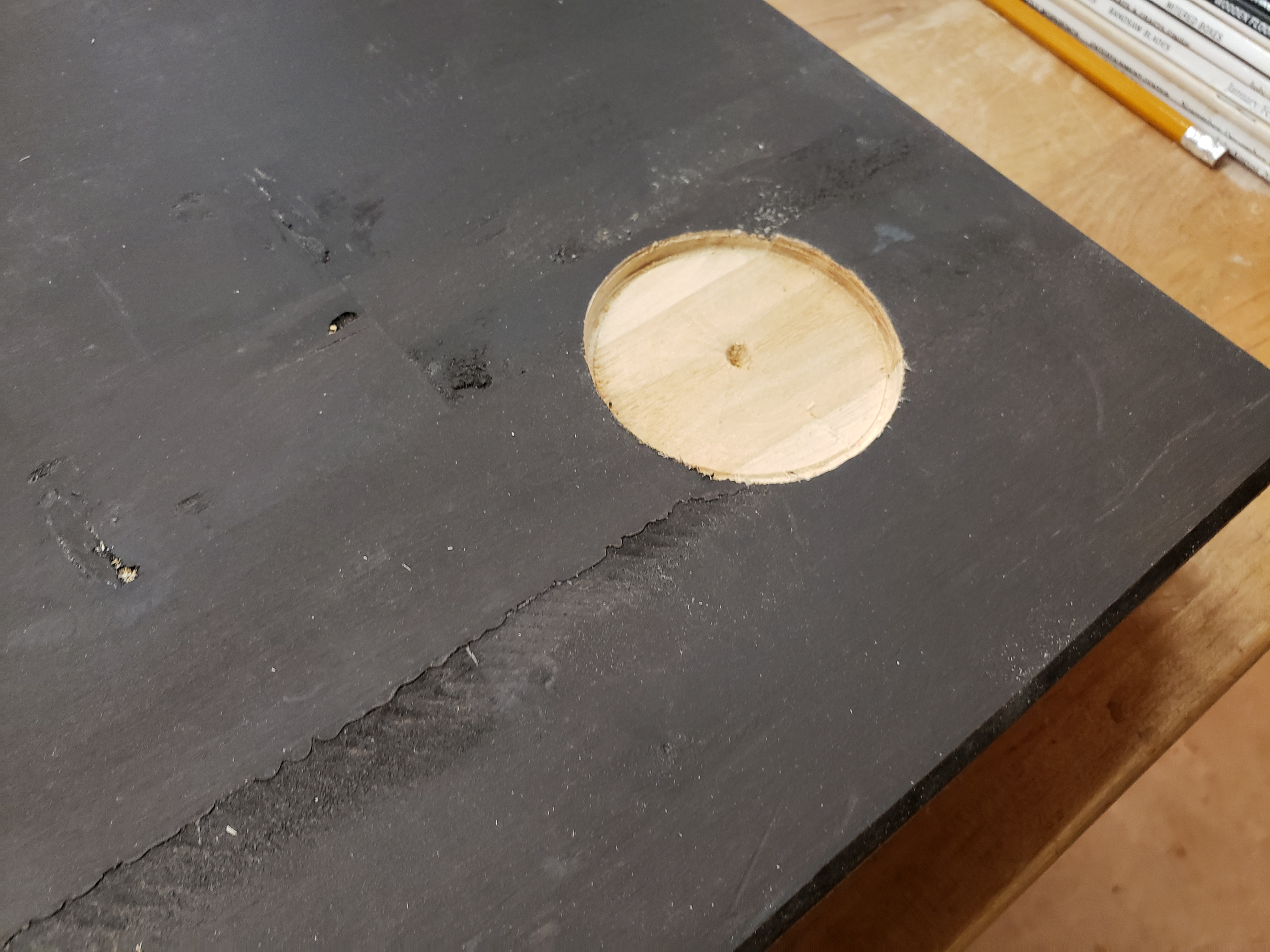

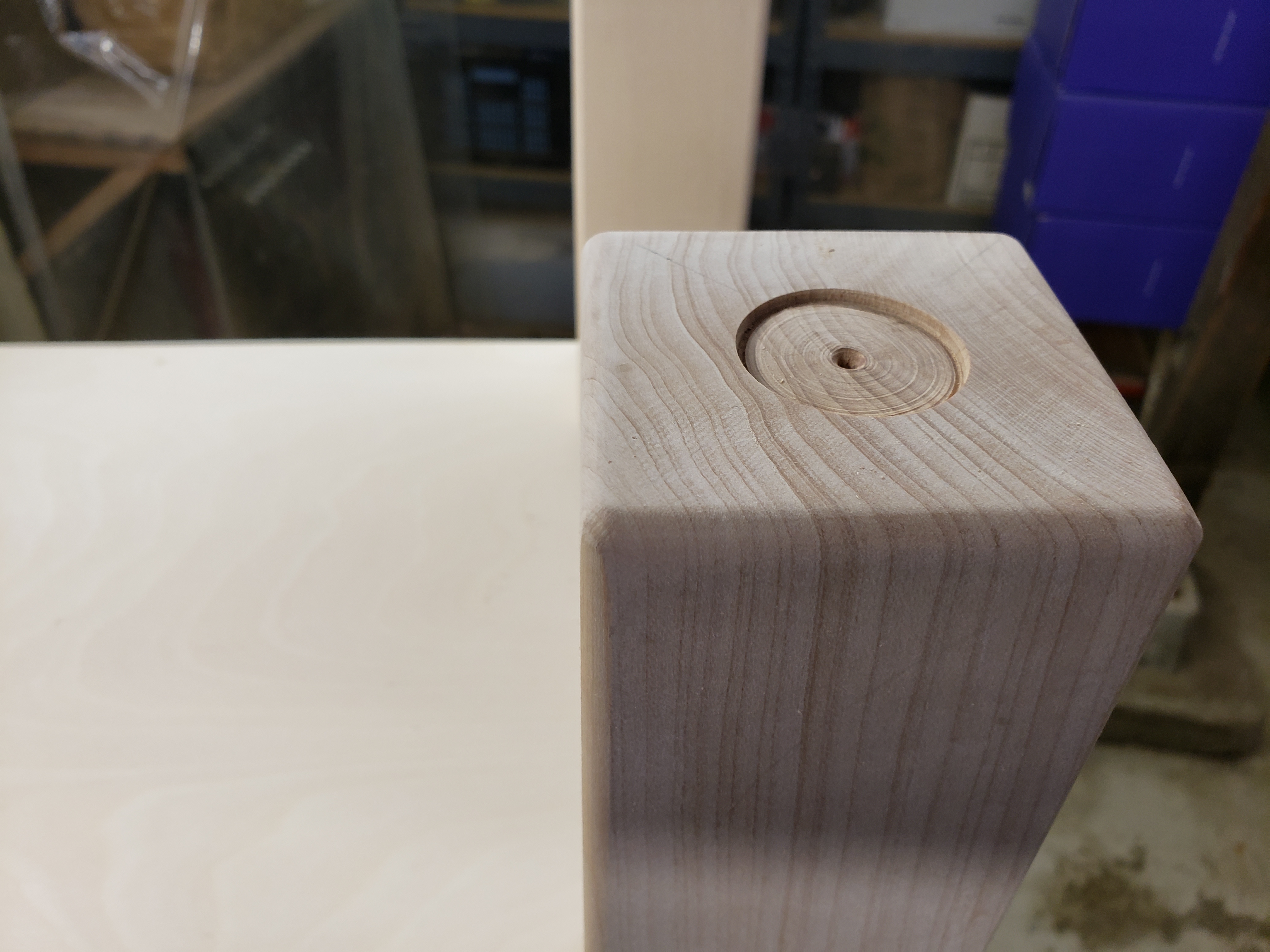

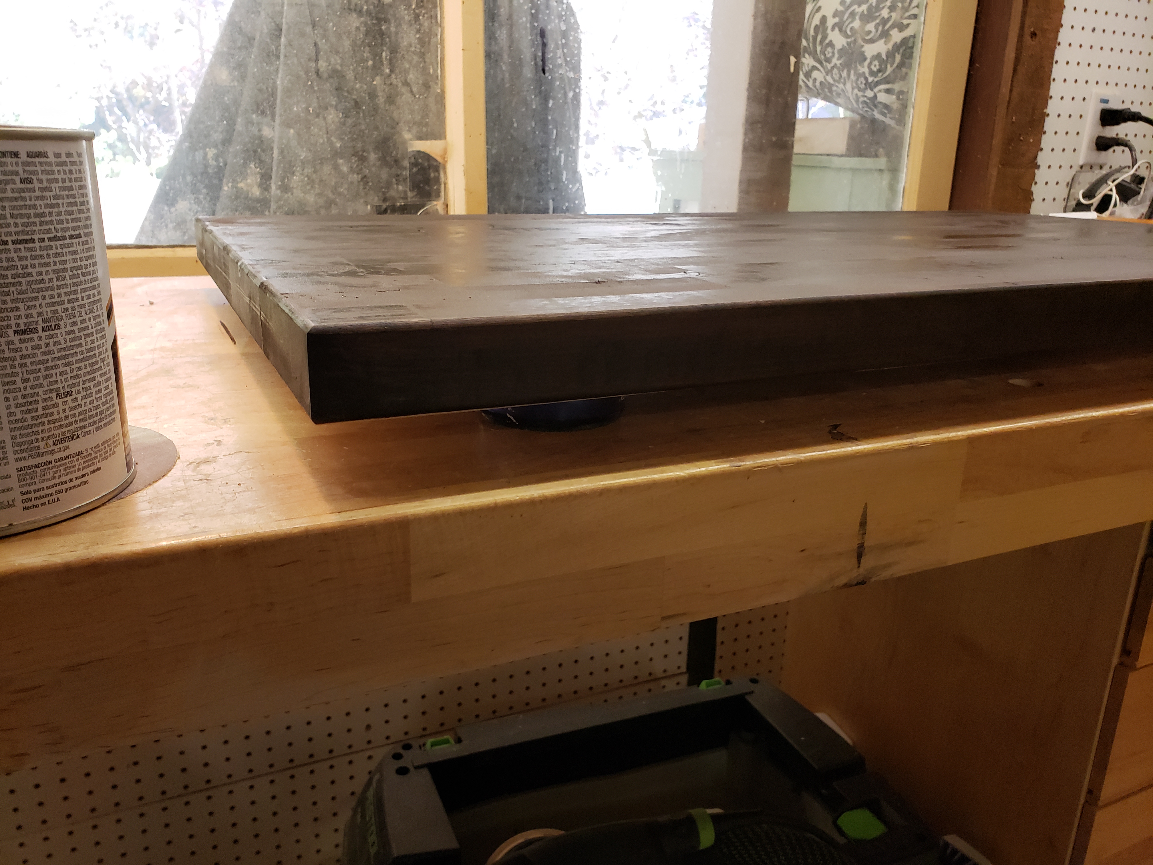

swt61 Posted December 1, 2020 Report Posted December 1, 2020 The round inlays on the top of the post are there for the isolation feet to register into. I still have a few stretchers to add to the stand base, and I think I'm going to use Golden shellac on the Maple. Probably polyurethane on the stained butcher block top. 2

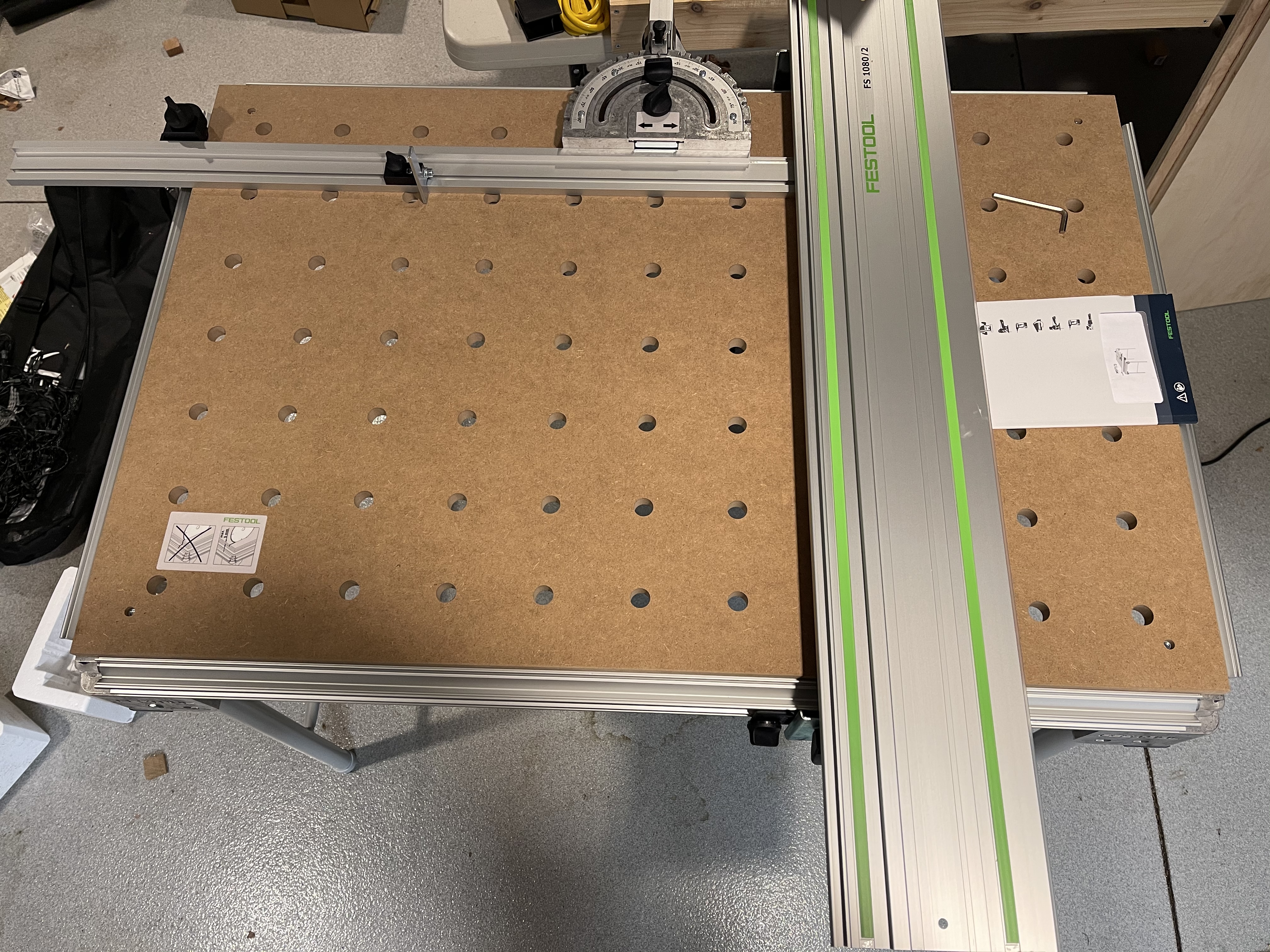

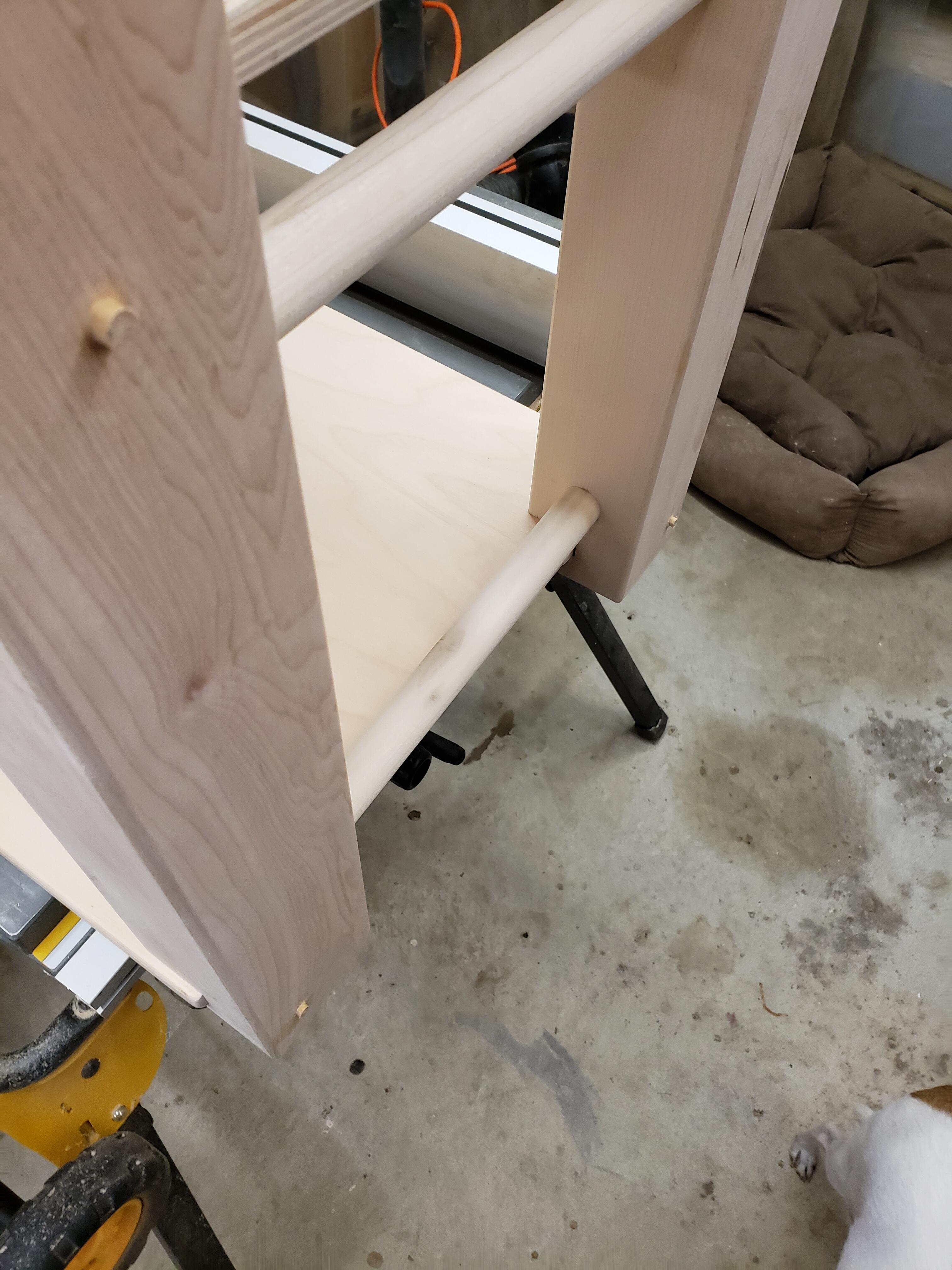

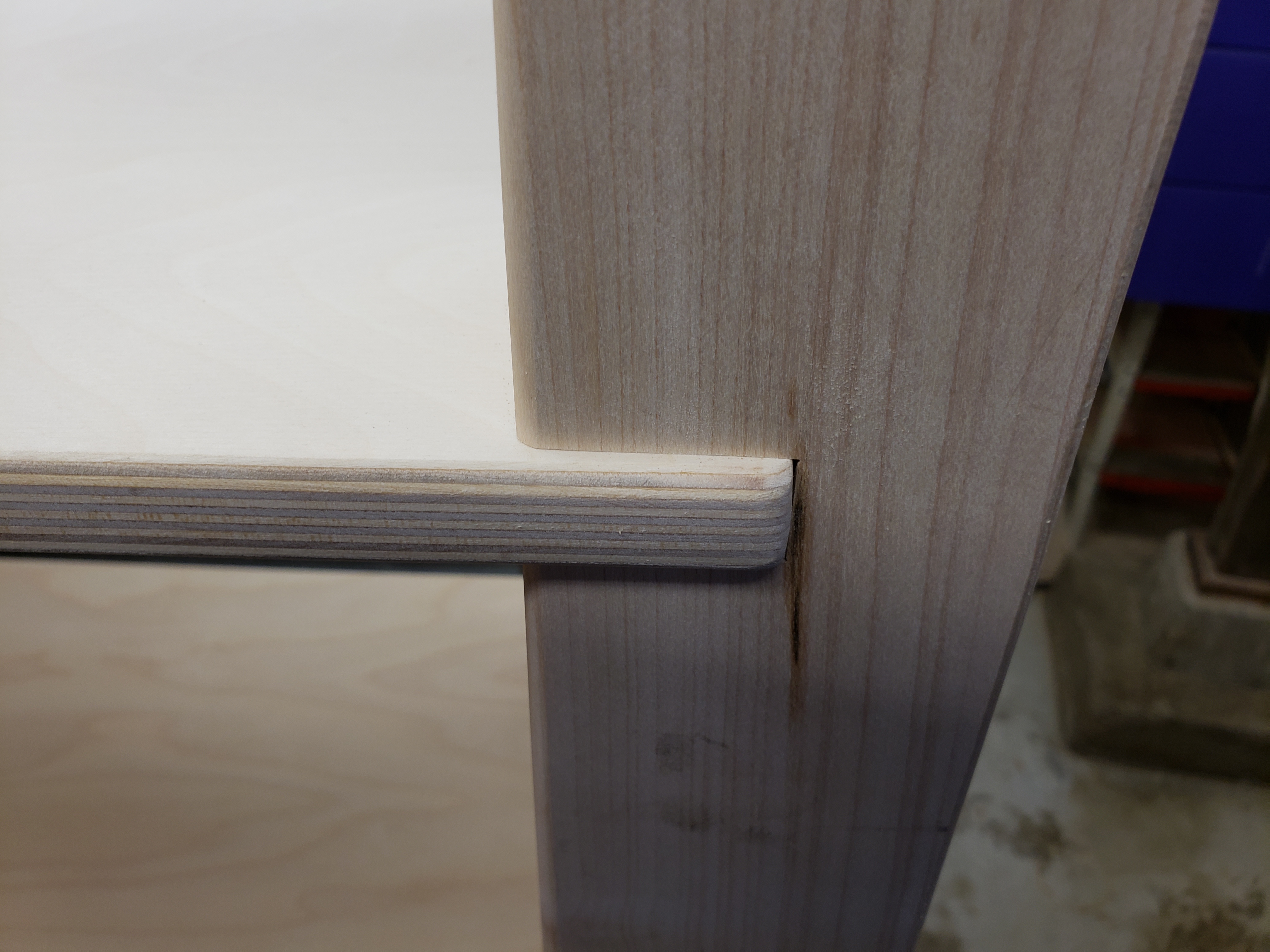

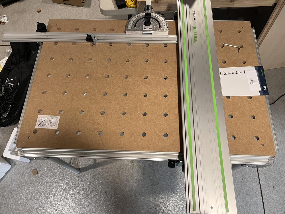

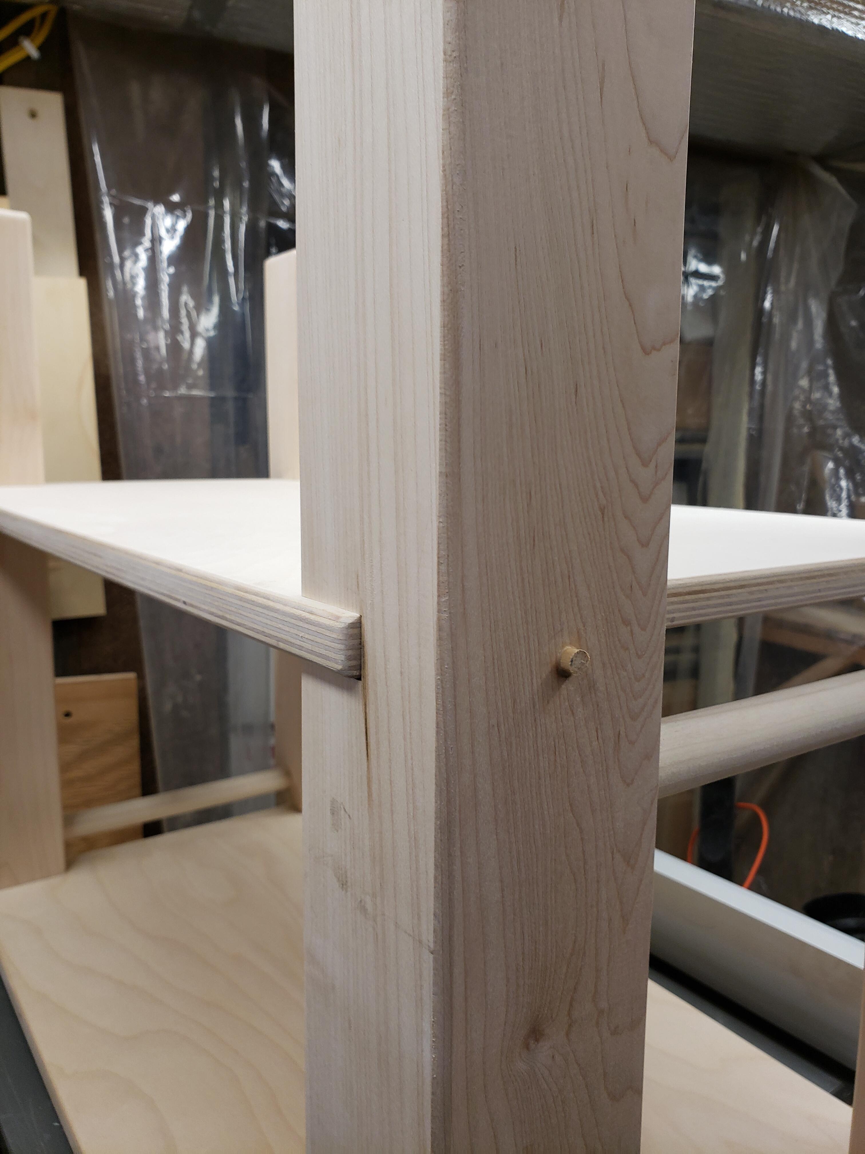

VPI Posted December 2, 2020 Report Posted December 2, 2020 The only blade I have is the one that came with the Festool track saw. Steve, do you cut out the posts to slip the shelves in there, or is that an optical illusion? I decided to upgrade to the full MFT or whatever table from Festool and got it set up tonight.
swt61 Posted December 2, 2020 Report Posted December 2, 2020 (edited) If it's a relatively new blade it'll be sharp enough. Yes, I used a dado blade stack to cut a channel (dado) into the post. This looks good, but also adds a lot of strength. That's a sweet table! Edited December 2, 2020 by swt61
VPI Posted December 2, 2020 Report Posted December 2, 2020 It comes with a fine tooth blade, but a universal or panther blade could be procured.
luvdunhill Posted December 2, 2020 Author Report Posted December 2, 2020 It comes with a fine tooth blade, but a universal or panther blade could be procured.The top is made to be used as a waste board. You can buy replacement tops. It’s a pretty handy piece of kit. 1

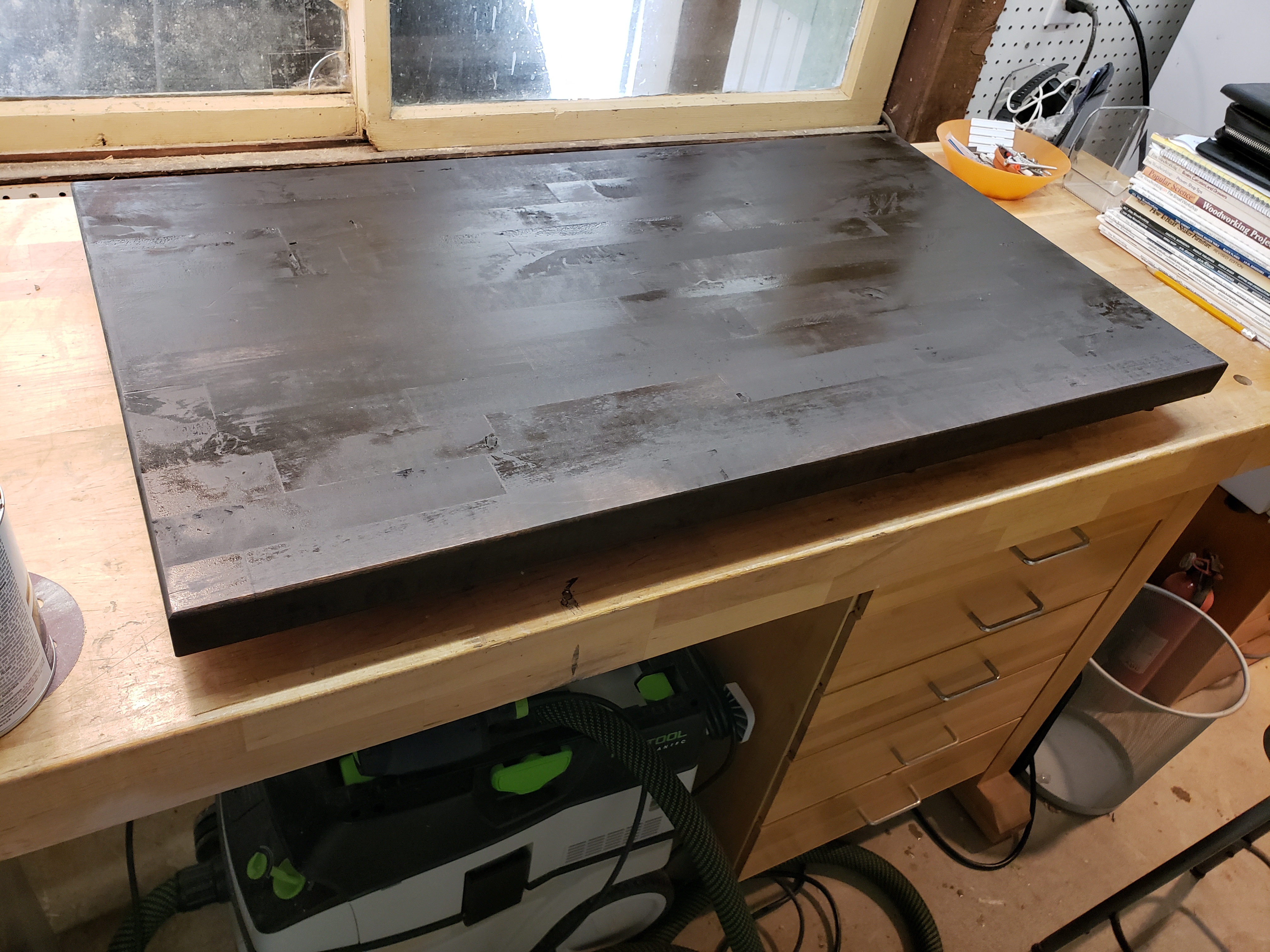

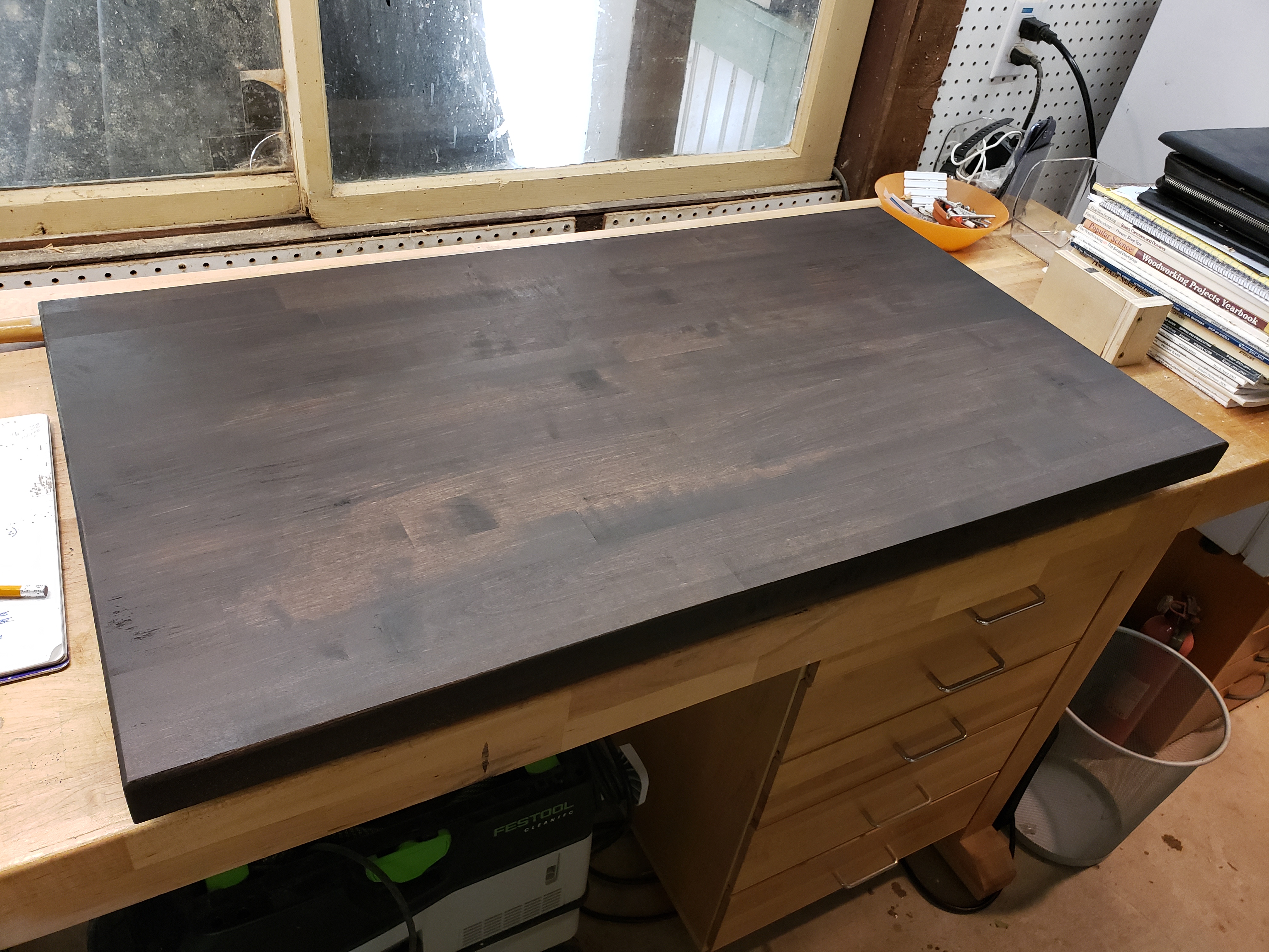

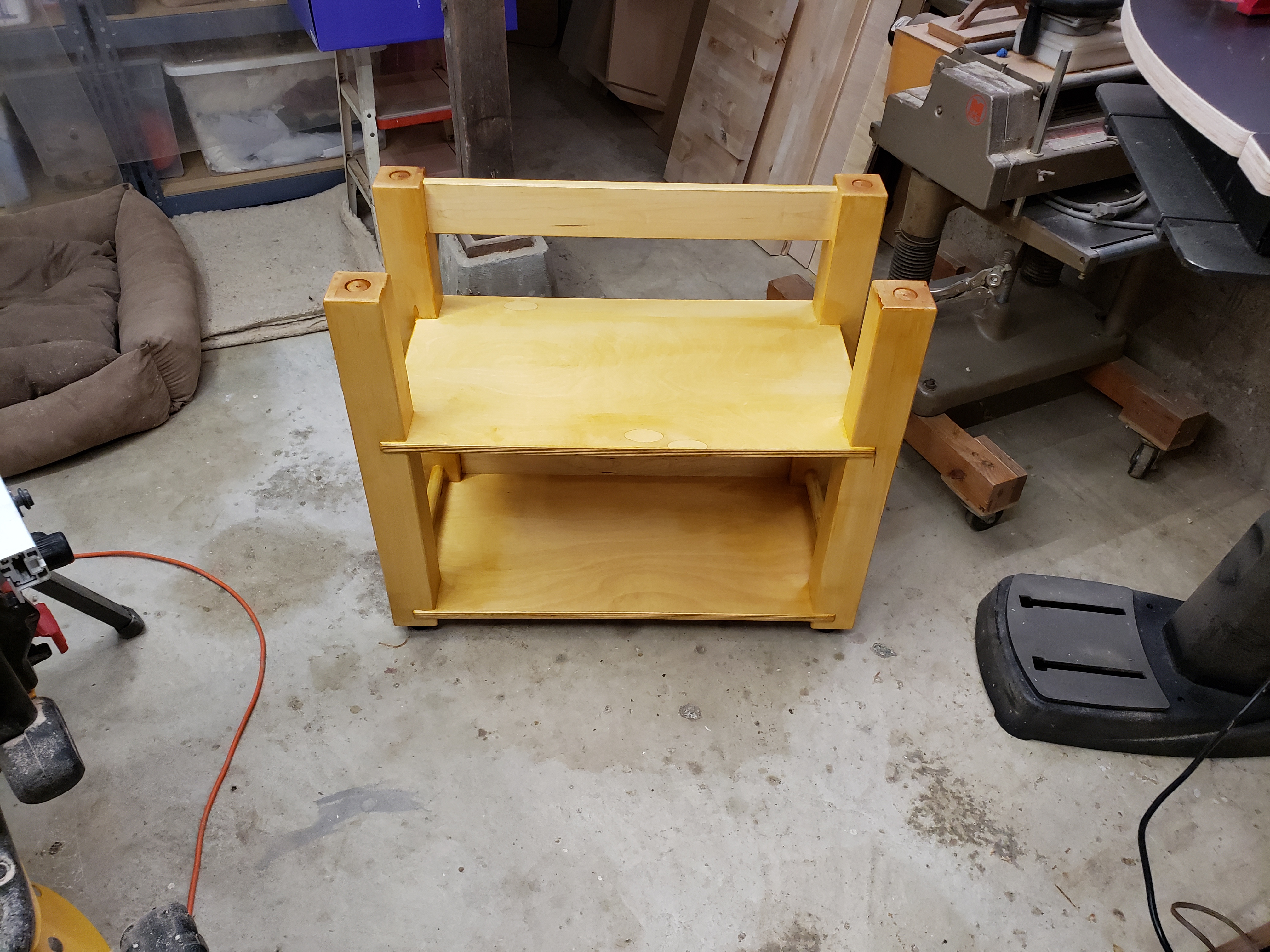

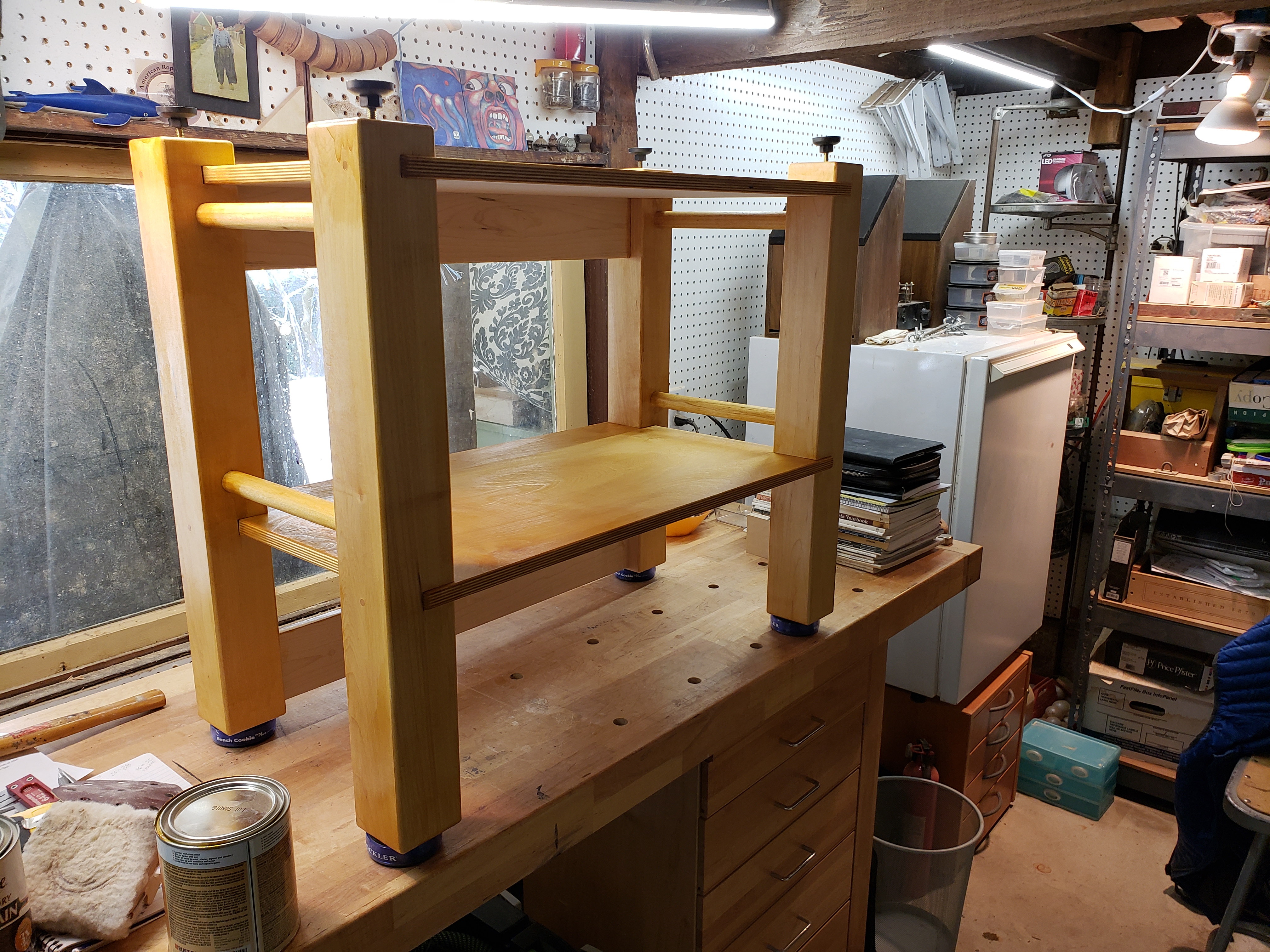

swt61 Posted December 2, 2020 Report Posted December 2, 2020 Construction is done, stretchers installed. The bottom stretcher strengthens the bottom shelf, strengthens the side structures from racking and stops the albums from being placed too far in the shelf. The top stretcher just helps with racking. Bottom of the butcher block top has recesses milled for the isolation feet. The isolation feet are the only connection between the base and the top. Top of the butcher block is stained, and the base has the first coat of Amber shellac. And leveling feet installed. The last picture of the base is right side up. Last thing to build is a riser for my motor pod. 3 3/4" tall. 9
ironbut Posted December 2, 2020 Report Posted December 2, 2020 Looks awesome! What kind of leveling feet do you use?
swt61 Posted December 2, 2020 Report Posted December 2, 2020 These are new to me, as they needed to be a litter bigger, as to not look lost under the 3" x 3" corner posts. I found them on Amazon. You can see them in the second pic, althought they're on top, because the base is inverted. 1

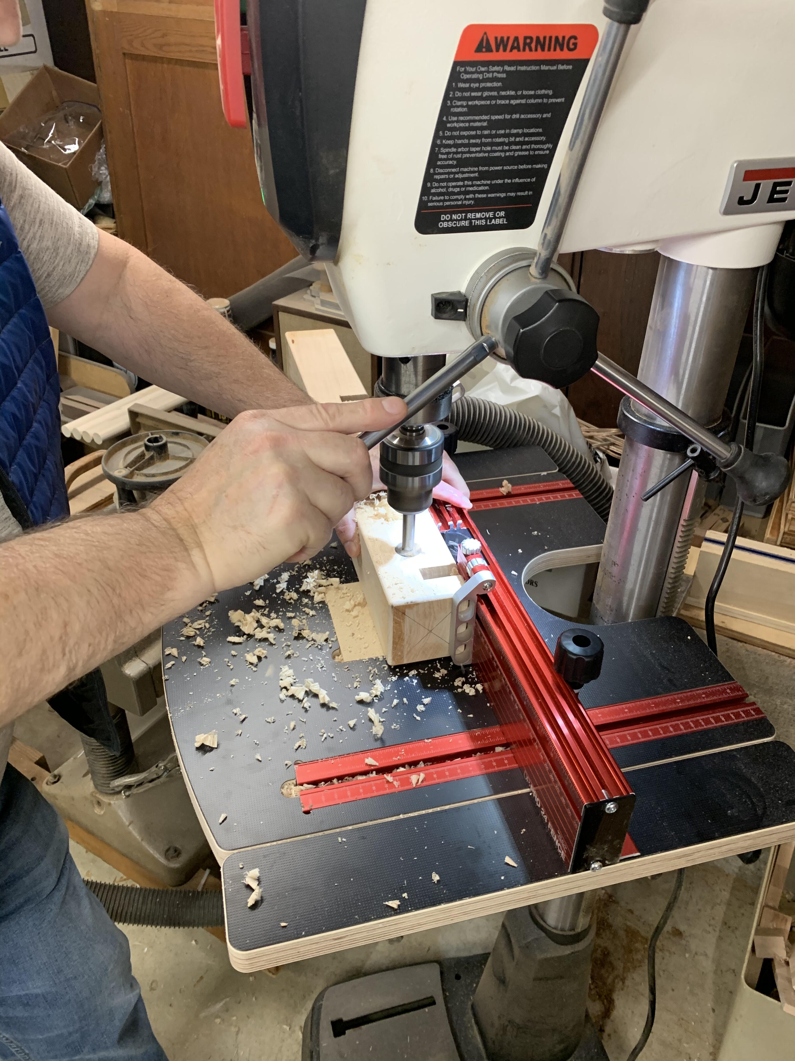

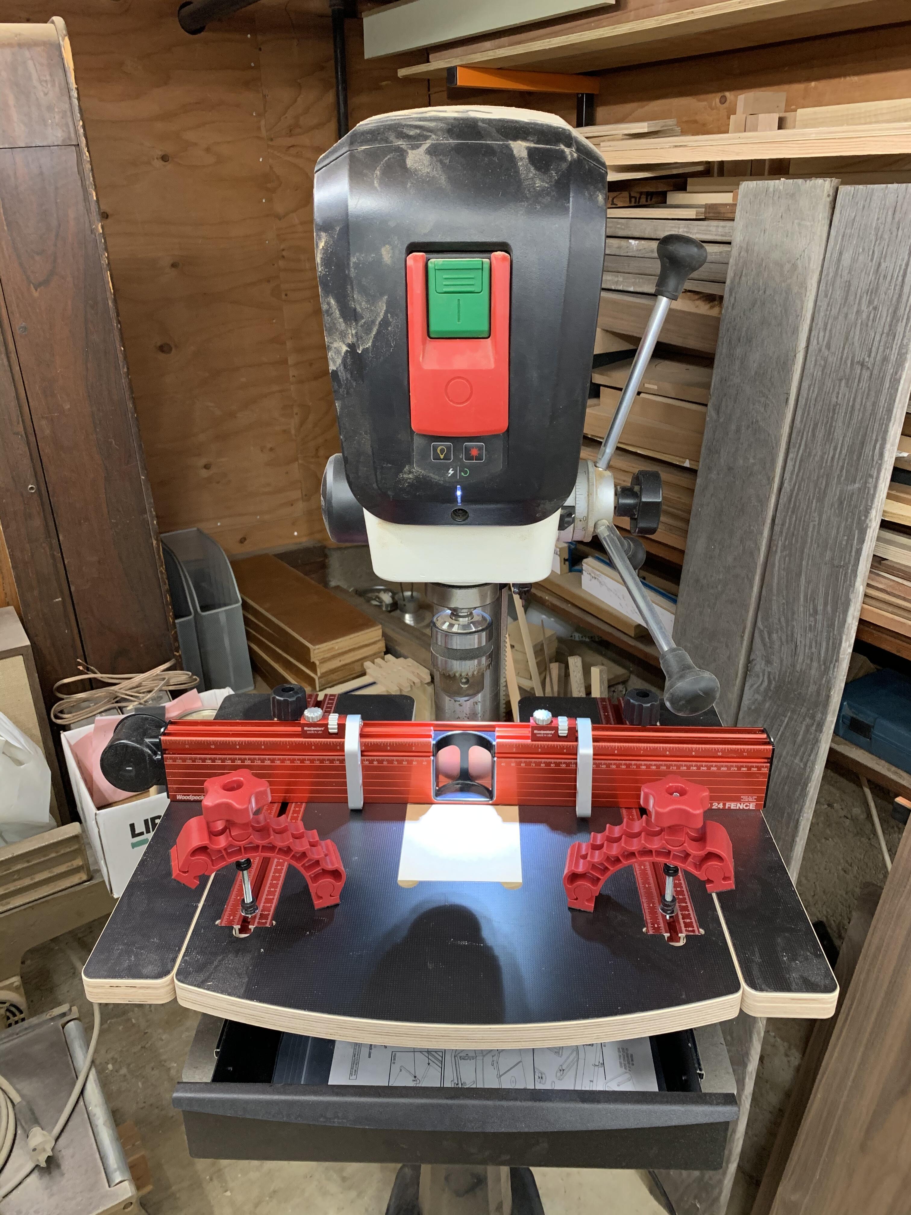

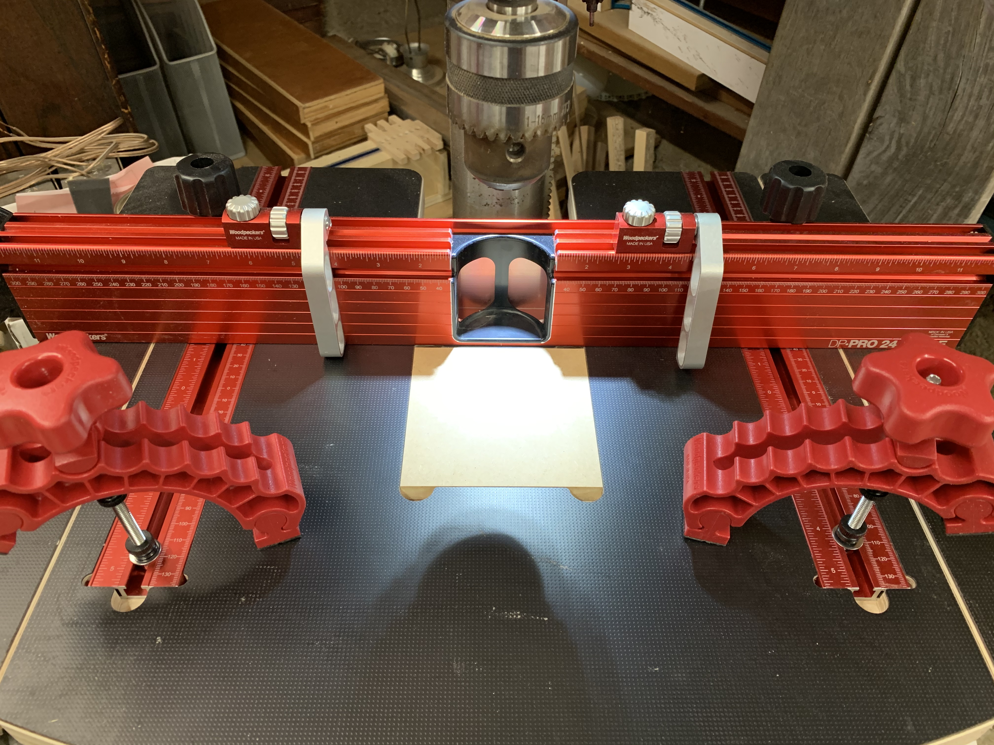

Voltron Posted December 3, 2020 Report Posted December 3, 2020 Luckily for Steve, my new Woodpeckers Drill Press Pro table arrived right before he started the Colossus Counter project. It made the dowel holes a breeze, with no measuring. The fence and the fence tracks are marked in inch and metric markings, there are two flip stops, the fence is hollow and attaches to a shop vac, and those knuckle clamps are going to be helpful. The sides extend to 36" total and there is a drawer underneath. Good stuff. I'm seriously considering the Woodpeckers router table Super Fence, but I am not certain it is as big of an improvement. 5
swt61 Posted December 3, 2020 Report Posted December 3, 2020 (edited) No Parasound gear. Just the Colossus, motor pod, Pass Pearl phono stage and the speed controller. Maybe some record paraphernalia, like anti static brush, stylus brush, record cleaning brush and fluid. Then albums on the bottom shelf. The dowels are also stretchers, to keep the stand from racking front to back, where the 1 x 4 Maple stretchers keep if from racking side to side. It's overkill of course, but the turntable weighs about 75 lbs. Edited December 3, 2020 by swt61

swt61 Posted December 3, 2020 Report Posted December 3, 2020 (edited) The riser for the motor pod will be free standing, separate from the TT stand. I need to raise the motor pod 3 3/4". I'll put small rubber feet on the bottom to keep it from shifting easily. I'm thinking of making it from Walnut to match the turntable, since I already have some on hand. That drill press fence system is phenomenal! Milo and Otis are available for consulting jobs. 🙂 Edited December 3, 2020 by swt61
naamanf Posted December 3, 2020 Report Posted December 3, 2020 12 hours ago, Voltron said: Luckily for Steve, my new Woodpeckers Drill Press Pro table arrived right before he started the Colossus Counter project. It made the dowel holes a breeze, with no measuring. The fence and the fence tracks are marked in inch and metric markings, there are two flip stops, the fence is hollow and attaches to a shop vac, and those knuckle clamps are going to be helpful. The sides extend to 36" total and there is a drawer underneath. Good stuff. I'm seriously considering the Woodpeckers router table Super Fence, but I am not certain it is as big of an improvement. I see one of those in my future. Built in dust collection? Take my money!
swt61 Posted December 3, 2020 Report Posted December 3, 2020 The dust collection works really well. 5 hours ago, Fitz said: "DP Pro" huh? 😏 DP Pro? Sounds like a very limber gay porn star. Oh, you were referring to the drill press table/fence. Sorry, I guess I had other things on my mind this morning.
dsavitsk Posted December 3, 2020 Report Posted December 3, 2020 17 hours ago, swt61 said: That drill press fence system is phenomenal! Good to hear. I have had what might charitably be called mixed results with various woodpecker things I have bought. I could definitely use a real fence for my drill. 17 hours ago, Voltron said: I'm seriously considering the Woodpeckers router table Super Fence I've been eyeing the JessEm fence. My current fence, from Rockler, is functional but not great. I also have an incra positioner which is nice, but the incra fence part feels like an afterthought.
swt61 Posted December 3, 2020 Report Posted December 3, 2020 I really liked the Woodpecker Drill Press Pro. It just made repetitive work a breeze. Seems quite solidly built, well thought out and the integrated dust collection is a no brainer. 1

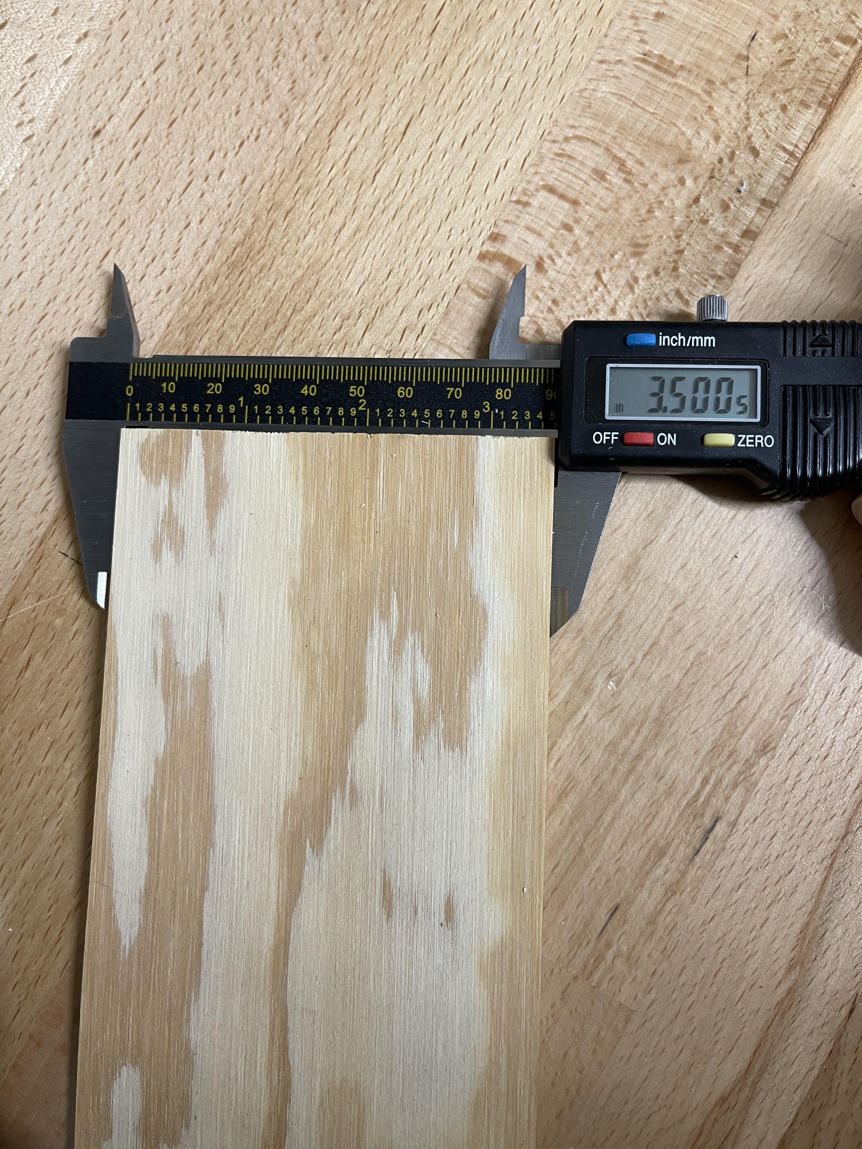

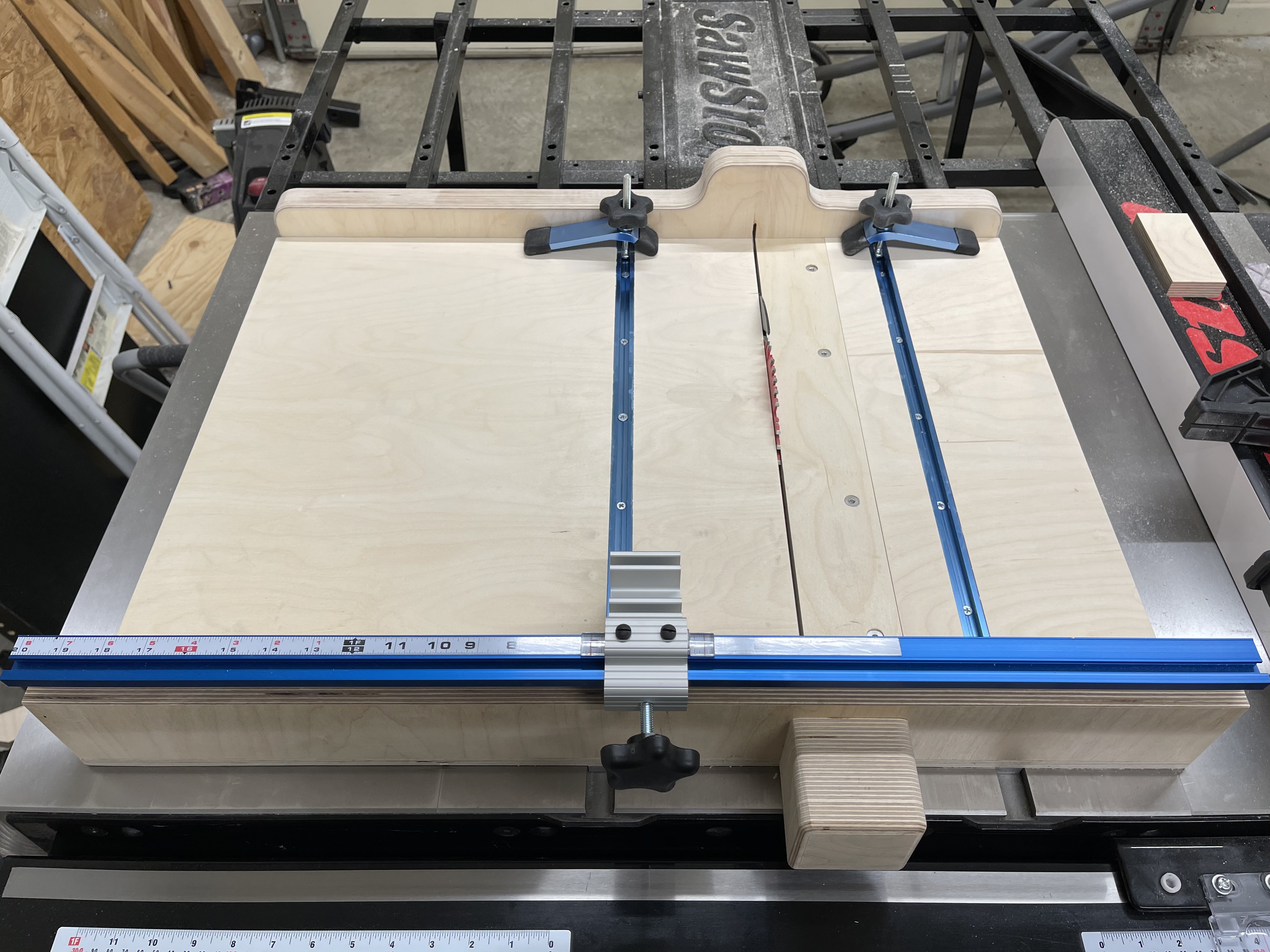

naamanf Posted December 3, 2020 Report Posted December 3, 2020 Aligned up my fence. Close enough for me. Put together a cross cut sled. Square to .00022 per inch. 6
