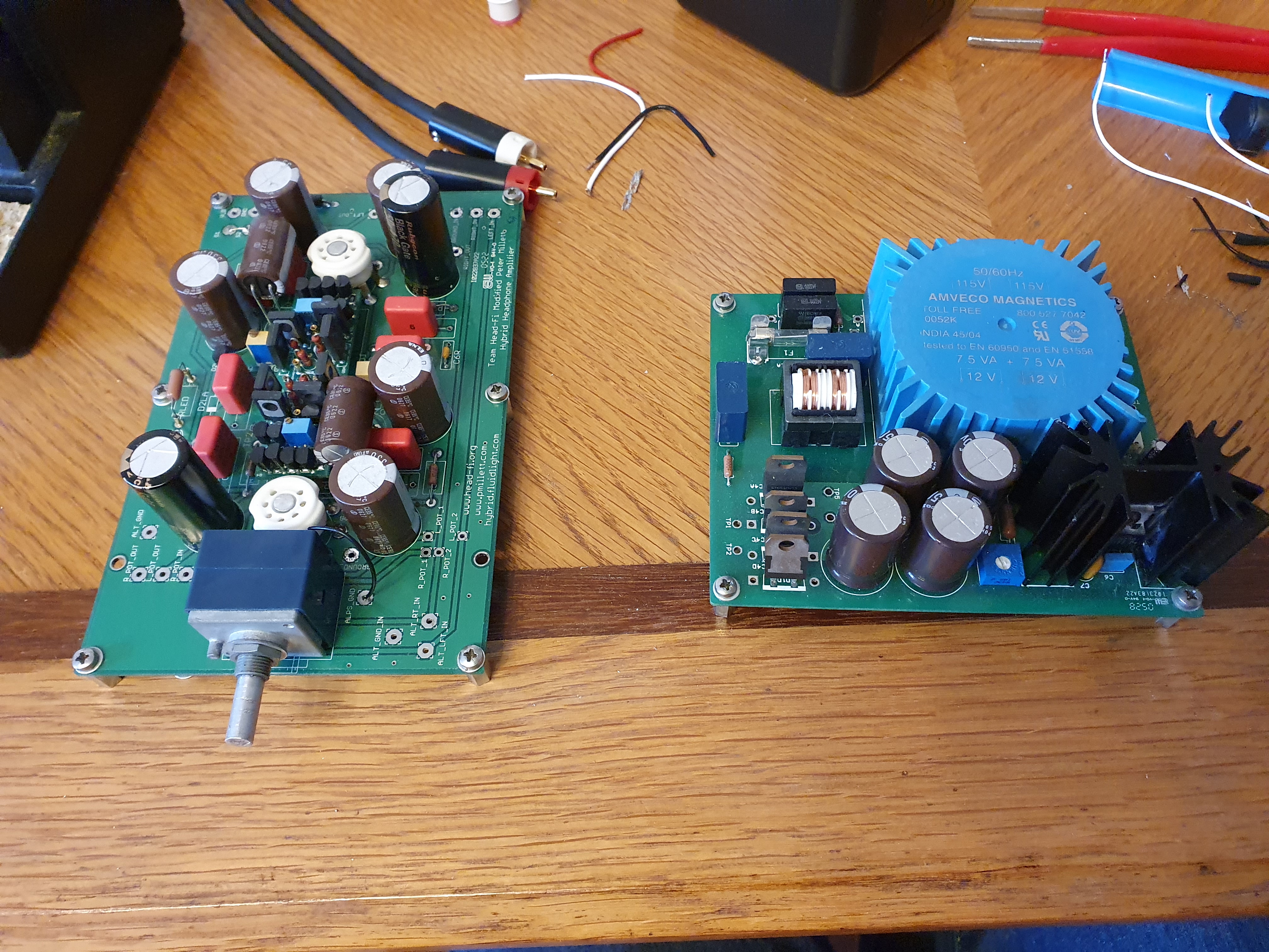

Refurbishing my old Pete Millett hibrid. The electrolitcs are over 15 years old, Should I replace them all or might they still be good?
Building a new wood and aluminum case.
I'd wager they are all still just fine. I'd use it in good health.

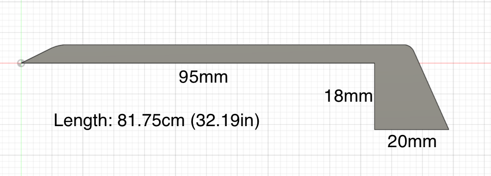

Image with dimensions attached. I figured it should be easy, and I only brought up CNC because it's a simple solution IME for turning CAD files into parts. Doesn't mean it's the right way to build this thing. That's a great tip to find someone through a makerspace, but they're all closed in my area because of covid-19. :(
Thickness?
I'm also trying to figure out if there is perspective in that drawing above or whether or not I'm looking at a flat plane (hence the graph paper background).  Is that a section cut through the threshold? The view from the top? Side?  Basically, I need more info.
That's a flat plane, as you surmised, showing a section cut through the threshold. I'm attaching a picture with perspective. Thank you for looking into it!
Personally I think this is very easily accomplished on a table saw. I would think that it could be cut and ready for sanding in less than an hour. But then again I have no experience with computer controlled milling.
I agree with Steve. This is easy on conventional tools. I also think it is really difficult on a CNC. My concern is how thin it is. Most wood will warp.
Dead easy if you make it from two pieces. Make the join a feature with a row of really nice countersunk brass screws.
Make it from two contrasting woods.
Or, if you want to hone your traditional skills, contrasting woods dovetailed together.
Or a finger joint.
You also need tough woods given this thing is going to get walked on and scuffed. So for contrasting tough wearing woods that won't warp - hornbeam for the flat bit and iroko for the vertical bit. Nicely contrasting too,
Based on my experience, that threshold can be built with only a measly $17k in tool investments. Make sure you buy every accessory as well and the full Woodpecker catalog so everything comes out straight. Easy. 😁
I'm with Doug, there's no good or easy way to do this with CNC and it's definitely not required.
I drew this up in CAD real quick just to rough out some of the missing dimensions (thickness, heal and toe angles) and I think you could make this out of a single piece of rough sawn lumber.  I'll defer final species recommendations to others but finding 6" wide 5/4 oak might not be a bad place to start and not horribly expensive.  To me the hardest part is figuring out how to do the bevel on the heal - best thought there is with a router after using a dado blade to hog out the underside.  But with a finished thickness of ~6mm (1/4") it's going to want to flex/deflect.  I'd have to play around with it in real life to figure out any better solution.
About the CNC solution - the real challenge is the two-sided nature and true 3D requirement.  A lot of machines and affordable software are really good at 2.5D (translation in purely the vertical when cutting in the Z direction) but struggle when it comes to shapes like what you have described in your image.

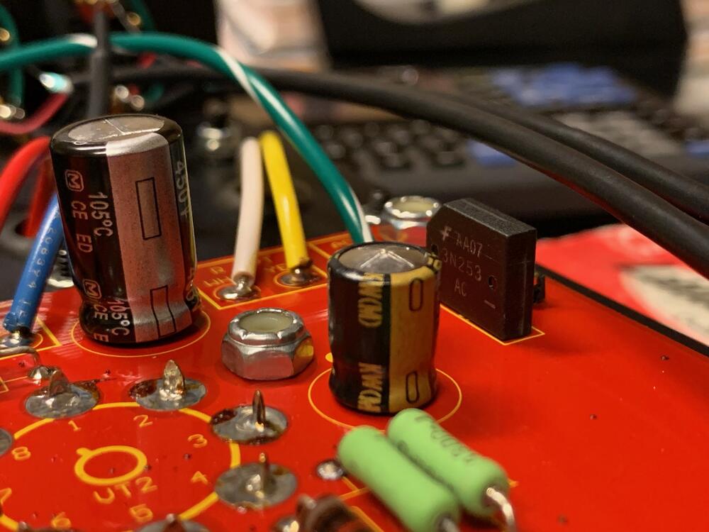

Me - I'm working on fixing my Jonokuchi which had developed a problem with one channel.  I opened the chassis hoping to easily spot the problem and did.  Two caps in serious distress (one blown) and two resistors torched and failed open.  Replacement parts ordered last night due to be delivered tomorrow which will likely get deferred to Friday but hopefully repairs can be accomplished this weekend. I've spoken with Pete and we don't think there's likely anything else at play other than one of the resistors drifting driving current and voltage up in an escalating fashion that resulted in the cap expelling its magic fluid filling.
Thanks for all the advice! Guess I’d better go learn to use a table saw.
