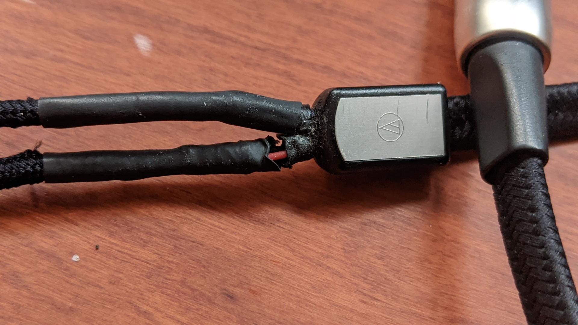

I have had my beloved ATH-L3000 for many years now.
It has developed a frayed cable around the split:
I am seeking advice as to possible next steps. Right now, it is not causing any performance issue (has not broken connection). As a safety measure, I have wrapped the entire junction with some blue painters tape to hold it all in place - not ideal.

Not sure Mikey. I'm not really up on any of the current cabling guys like Moon Audio (see some hits for these phones with Silver Dragon cables on them). It would be nice if AT said what they would or could do before you sent them in :)
From the pic, it looks like it is just heatshrink that is splitting, but as you say, getting access to a free end to replace it is problematic unless you can remove the cable at the headphone end.

Thanks Chris,
Yeah, no big deal to breakdown the cans to get at the end wire end so that I could re-sleeve the cable.
It wouldn't have much meat to hold onto. The section coming out of the split is a reinforced tube about 1/2" long. That seems to have broken for the other side.
I feel that there maybe a twist point there. You can see the little threads on the other side of the heatshrink as well to the left.
I guess that I could try to undo the cable, cut off all that tubing and then try to build up a new sleeve - maybe a small stiff tube - and then heat shrink on top..

1. Measure the diameter of the plug at the end of the cable.
2. Purchase appropriate diameter 6:1 heat shrink - https://www.cableorganizer.com/heat-shrink/heat-shrink6.htm - bonus, this stuff is adhesive lined.
3. See if a 2" section will cover and reinforce what you need, including grabbing onto the cable split housing so the whole thing can act as a strain relief for the worn cable section.
My guess is if you do something like that, for around $30 (assuming some shipping) you'd have a nearly stock looking setup that'll last a long time if not abused.  If nothing else, it'll buy you some time to figure out the long term recabling plan.

Not difficult to recable the L3000 at all.  Remove the earpads, screws (4 screws holding the earcups and another 3 holding the driver assembly in place), and you should get to the driver.  I suggest a high quality silver cable to enhance the resolution, open up the soundstage, and tighten up the bass impact.  I recabled my old pair with Moon SIlver Dragon Gen 1 but this was probably around 7 - 8 years ago before I sold it to a local friend.  I recently recabled my 3000ANV with the left over SIlver Dragon and the work was not difficult at all.  If you are handy with soldering iron, it can be done ..... just take your time and be careful.  Take pictures before and after removing the driver holder assembly...you want to line up everything the same way.  Here are some pics of my W3000ANV that I recabled last week.  The internals are more or less the same as the W2002 & L3000.  You can do it.
