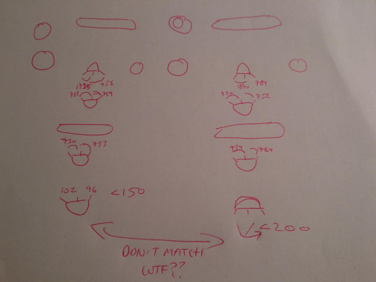

Can I post request for help on my SRM-1 Mk1 here over from the other thread (Spritz has already given a bit of guidance somewhat). I can't figure out what the heck is wrong with this dead left channel. Got measurements all up on a pic once I get the get-go.

No problem posting it here but the basics are simple enough.  Do a diode test on all the transistors to sort out obvious shorts and then compare the voltages between the channels.
I'll measure the diodes today.
Ffs...did the diode test (twice and many combinations following a few guides of measuring the right combos of Case+Emitter+Base etc....
What a headfuck this amp has been and due to my inexperience with troubleshooting these sort of things.
All the 4 2SC and 2SD Sankens all emit about the same numbers throughout the diode tests to each other in pairings.
Then I measured the 6 x 3 legged TO-92 black silicon enclosed 2SK68A transistors near the balance/offset trimpots (as seen above). Two of them measure less than the other 4. 1 of them measures 134 and 78 respectively, the other measures 108 and 78 respectively. All the other's emit numbers around 500+ and 700+.
Then I measured the section with a lot of ceramic film caps and again black transistor looking shit next to the 2 big cap section (left hand corner section in the above photo). Measured every diode in the amp and no sign of shorted diodes with correct readings from having the appropriate probes on the anode and cathode sides. Back to what looks like the bias section, all the transistors measure over 700-1800 range and lower or higher when I reverse the probes of my DMM to measure the same points again.
Gonna upload the rough measurements I took down on a gay diagram I drew soon.

That tells me nothing, what were you measuring to get a result of 500-700?  You should get the voltage drop of the diode.
What's your point of reference?
Where was the other voltmeter probe connected to?

Finally found the fucking culprit (and learnt a few things along the way too).
Swapped the Sanken transistors and my original assumption of 2 pairs per channel aligned with where the L and R signal input pads were (traced through the back of the circuit) was right. So swapped the two Sanken pairs around to see if the bad side will emit sound and the right side produce nothing. Nope, nada, still no sound on the Left channel.
So I look at the circuit hard again with a bit Heineken in the system I thought hard to myself wtf is happening. So I look hard at the bank of 6 2SK68A jfets (3 for each channel), desolder them each and do a diode test, properly this time. Two of jfets from the Left side gave me weird numbers and didn't match with the right bank of jfets. So how about the old fashion way to confirm my findings, desolder everything and swap the jfets around, this should mean no sound on right channel this time and sound from the left. Resoldered...opened another 6 pack.....
Powered the bitch on and VOILA! No sound on right channel, but sound on left channel. Measured everything again to make sure no odd jump in voltage or so. Now time to find some 2Sk68A jfets which are discontinued but ceitron.com ($0.49 a pop) has some and so does ebay ($7 a pop). Think I will finish the rest of the slab early tonight coz am one happy chap.

If the sand is that cheap ($0.49) - buy some extras for when the other channel pops.

Well that's certainly one way to find the problem... :P may want to replace the old electrolytics while you're at it. And above all, please find better beer than Heineken.

Yep going to buy a lot of spare k68a's just to keep everything in line incase one goes kaputz again.
