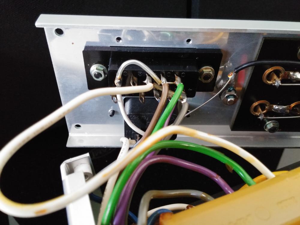

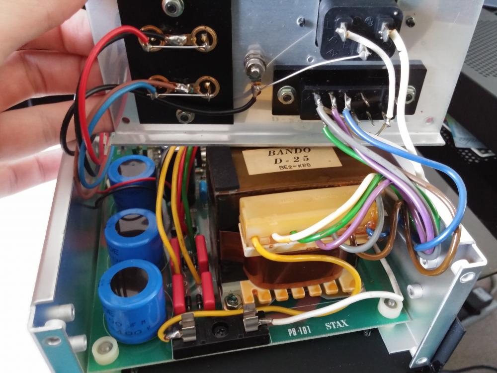

Spritzer would I need to re-wire my C serial number SRM1 MK2 from this:
20160118_110833.thumb.jpg.b0464ebade9533
20160118_110911.thumb.jpg.cb9f8c0cfec627
To this (your post on Head-fi):
voltageselector.jpg.97f67eb485f61f882bde
To be able to use the voltage plug? I managed to source a voltage plug and plugged in straight in but it blew the fuse. So I found your post (with the above picture) with some indication that the wires need to be wired to the voltage selector like that to able to use the voltage plug as I hate using a step down to 100v, I'd rather just use 240v.
This correct?
When Stax did 100V only amps back then they just wired the sockets every which way as they were never supposed to be used with the plug.  You need to completely match the picture above but it looks like you are lucky, just move the green and brown to the their correct spots and add the other white wire.  Just make sure it is the right one as Stax always used two white ones for some reason.
