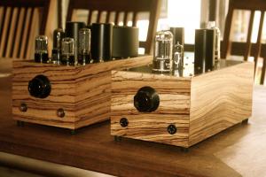

Here's a picture of my electrostatic amp under construction. It's my first attempt to post a picture on a forum. Hope it works. I'll get better. Any advice would be appreciated. Right now I'm in the process of rebuilding it in a more professional form. More info. later.

Looks beautiful, Frank, but 2 posts in a month does not a "miniblog" make! Let's hear some more about this thing! Do you think it will be ready for prime time if we have another Mayberry get together in February?
Hey Frank, it looks great. I advise you to invite me over so I can listen to it too. :D
Totally agree with Al. We need to hear more from you, Frank. I like how your "under construction" looks like a totally gorgeous finished build. And Al, I like how you're thinking with February rather than October.

As usual Frank your first attempt is more impressive than most of us could ever hope for. As for feedback, I got nothing.

Are those 7403's? :) Other then that, no comments from me besides basic questions about the circuitry.

Wow! My image post worked!
Thanks for all the kind words. I've had a few distractions in the past months, but now I'm back on track and should complete this amp in a few weeks. A "Mayberry" public debut would be great, but first listen will go to my fellow "Santa Barbarian" Ken, after a barbecue and a few beers.
I need to put a kudo in here for Jack Elliano of Electra-Print. For 15 years he's built transformers for me. Almost everything I've asked for has been a non-standard, custom design. He's never let me down no matter how crazy my requests, and his prices are dirt cheap considering the custom engineering involved.
Originally, I used an old recycled pair of 35ma 1:1-1 high level phase splitting interstage transformers for the output of the amp. Although they subjectively worked well, I knew that running 600vdc with a 1kv output swing was way beyond their design parameters. He doesn't normally make this transformer anymore and now reccomends an autoformer for phase splitting duties. I called Jack and asked for a pair of purpose built transformers that could do 600vdc, have enough primary inductance to support a wide variety of tubes, generate a 1:2 step-up,and have a 20hz-30khz bandwidth. He laughed. This is an extrodinary challenging set of specs for a transformer. At first he wasn't sure it was possible, but after a couple of attempts we have purpose-built electrostatic amplifier output transformers. If this amp has any value at all it will be because of his work. Thanks Jack!
On Spritzer's suggestion, I substituted a 3d21/7403 for the kt88 as output tube. In a no feedback, single ended amp, the quality of the tubes makes a big difference in the sonics. I'm fortunate enough to own a pair of original British Genelex kt88. They sound great, but the suppli8es are gone, and they now cost a fortune when and if you can find them. The reissue "Gold Lions", the best of the current production, while very nice, are a step down. Standard Chinese Shuguangs sucked. I've got a pair of 7403 on tap, but I've been running 1970 British STC 3d21a. You can buy them NOS all day on Ebay for $20.00 a pop. In this application, I can't tell them apart from the Genelax kt88.
