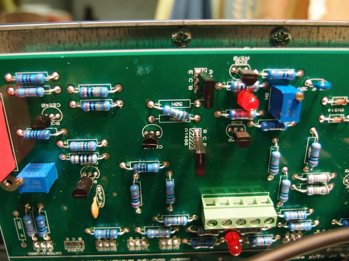

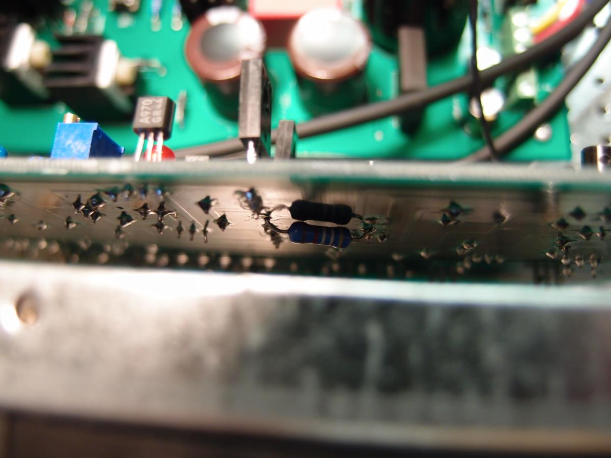

We crossed the 50k resistors and one board is now working. Very close on balance, millivolts, and about 3v on the offset without much work. Now working on the other board which does have some fried parts due to the 1486 being in backwards before, looks like 2 of the 4686 were done in.
We left in the 1.2k for now since we didn't have the 1350.
