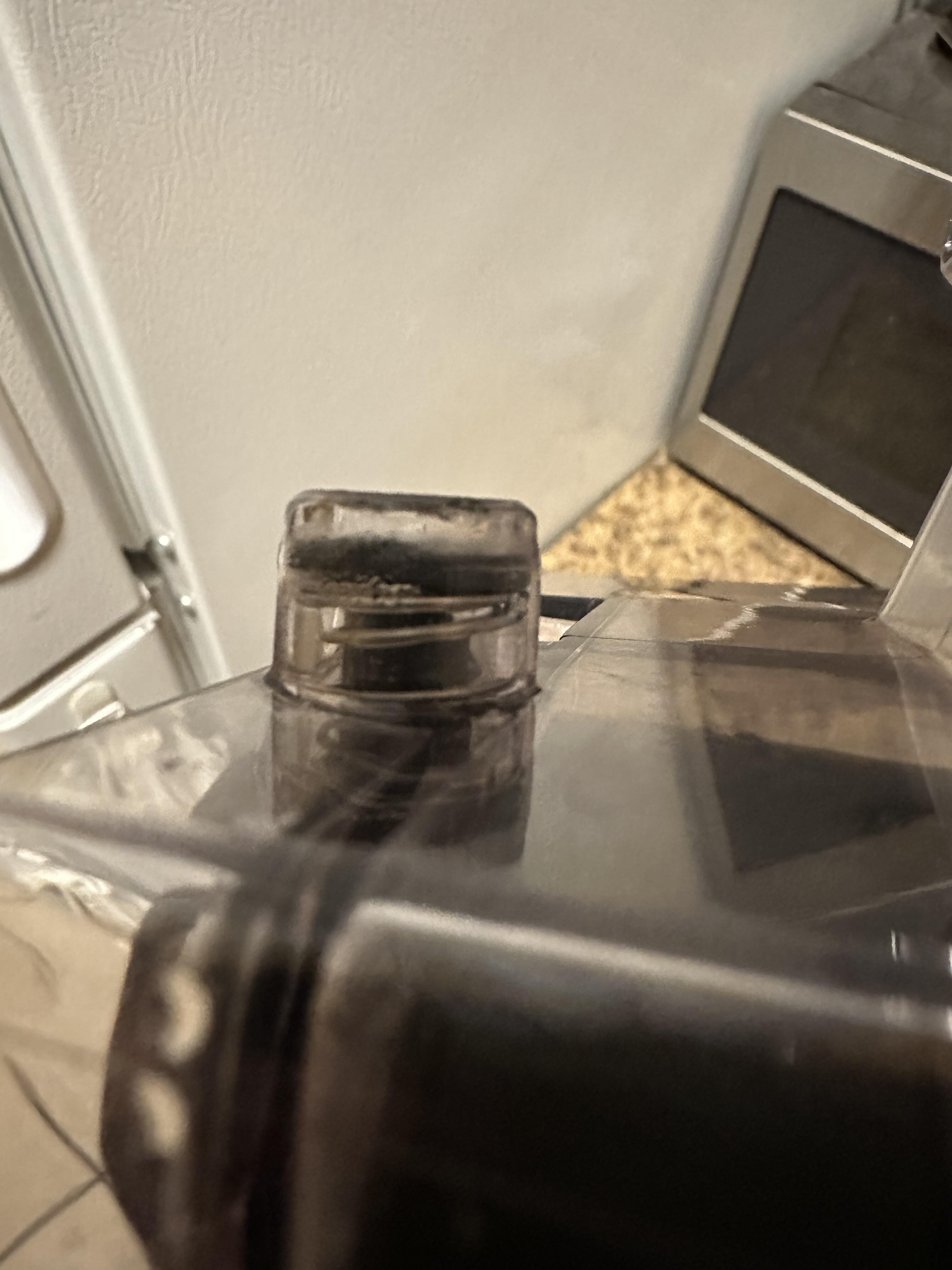

I have the same issue with my tank not sealing when I remove it from the machine. And you are right. I found no way to replace the little o-ring on the valve, and nobody sells it either. It is possible that it's leaking to the inside and causing issues there as well. Good luck with the repair, or if you send it in.
2 hours ago, kevin gilmore said:
pics of the unreplaceable o-ring please.
Too soon?
I‘m sure I can get the o-ring out, but I don’t know how I would get a replacement on.
use something round and small diameter to push the piston down, then tiny long nose pliers to extract the o-ring. then size appropriately from a selection of o-rings and reassemble the same way.
I did number one, but didn’t go so far as number two. I don’t necessarily trust my shaky hands with getting an o-ring on.
