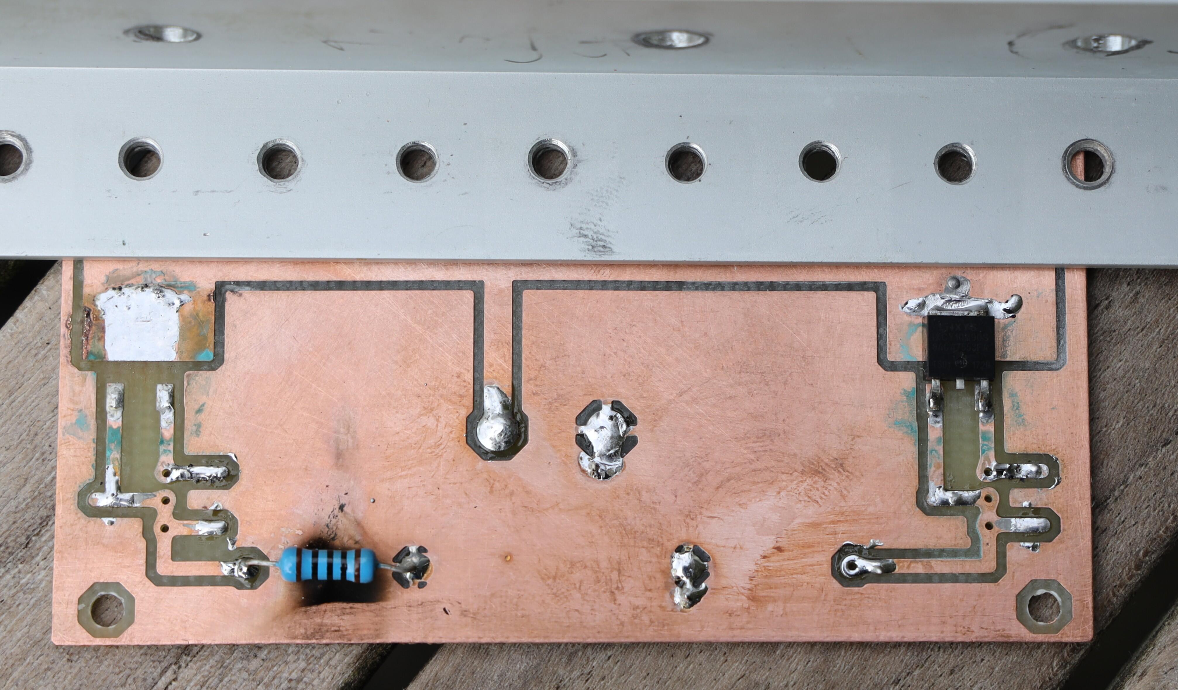

Thanks for notifying. The more eyes the better and… No, I missed that damage. With L-bracket it looks like this. Clearence between +400V area and ground is 40 mil. So, I doubt that there has been an electric short. I suspect that, for a reason I don’t understand, the current rushed and 10m90 quickly over heated. At the same time the PSU gave up and all went silent. I guess it’s heat from 10m90s that caused the damage. But that is a 100% guess. Anyhow, I think I stick to to220 version of 10m90s and forget this mishap.
That 10M90S decided it was done with this world and took a leap of faith! Looks like it couldn’t handle the heat.☹️ Did you check this section? Looks like it was shortened by the solder.

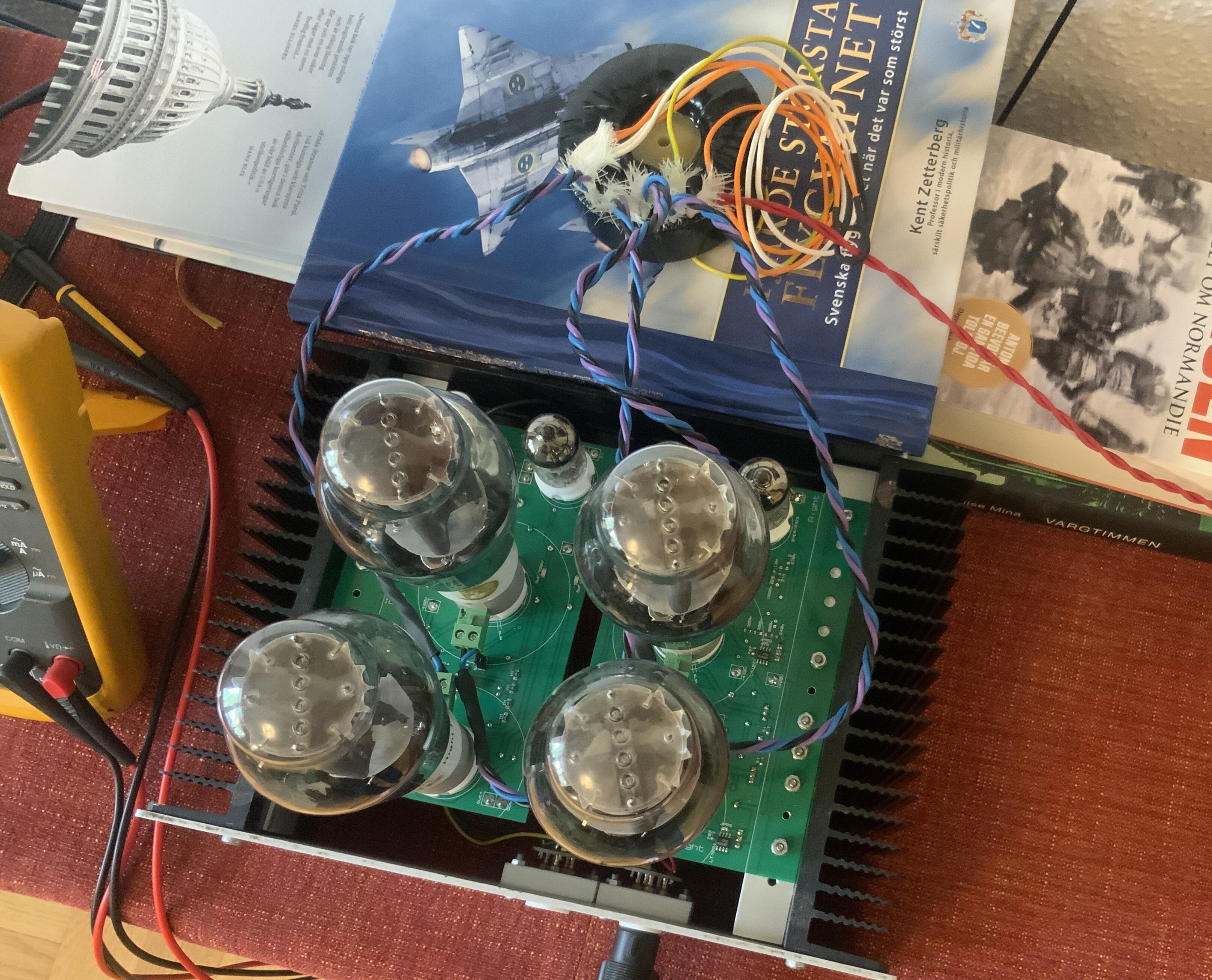

Milled a small board to test IXCP10M90S(TO-252). Attached board to heat sink via L-bracket and sil pad for insulation purpose of course. When increasing current to 20 mA left side its 10m90s popped and left the board completely. Found it on floor. So, no more testing regarding surface mounted 10m90s. I’m very pleased with the new mini T2 board. Here with 300B via tube adapter with filament injection, 5VAC from transformer. Works great. Nice setup, don’t you think?
