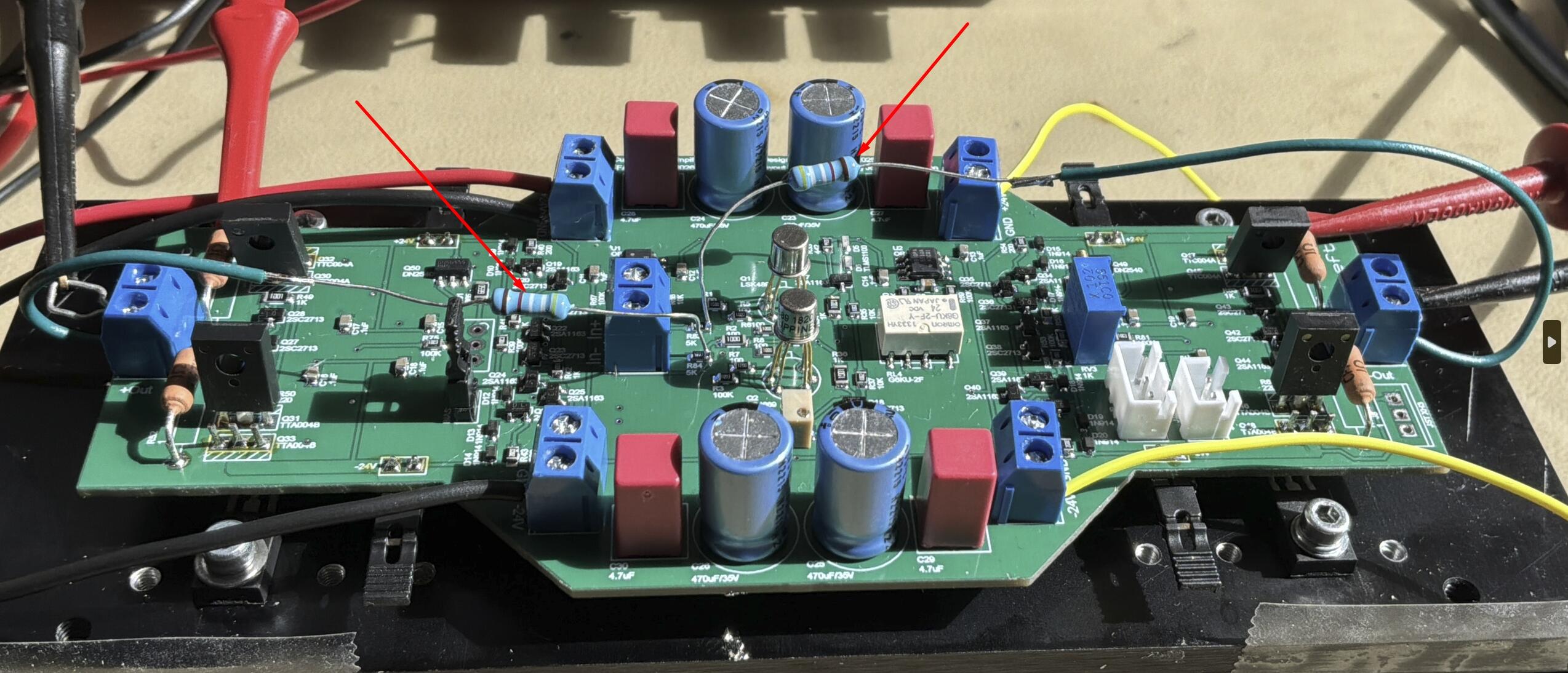

Thank you guys! Maybe your information will help me with the problem I've with my CFA3smd in SS mode. Removed feeback resistors from board and wired 50K xicons (at red arrows) from outputs to after 5K resistors at inputs. Now steady bias and zero offset. So far so good. But it's still on the kitchen table. - Today

great work ! glad my post helps and yes total length of feedback loop will affect DC offset from my past experience with my own split board attempt , looks like having some oscillation ? -

Reworking my CFA3 for ZF/SS switching. Inspired by ang728's hat board, I designed a split-board version. It works fine with ZF but has issues with SS: R channel: 0.2V offset, fluctuating ±0.1V. L channel: <30mV offset, fluctuating ±0.1V. Bias: Stable. Tried those solutions from previous posts but unsuccessful to solve any issues: -Removed hat board; use original jumpers for ZF/SS. -Added 680pF between B-C of output transistors. -Removed C9, C10 (20pF). -Replaced all PZTA56/06. -Swapped THAT340 / K389-J109 / K170-J74. Changing R171, R211, R272, R322 from 300R(silkscreen) to 600R(schematic) fixed the 0.2V offset, but both channels still fluctuate. Suspecting trace interference, I directly wired the jumpers to SS mode. The fluctuation is gone. So I redesign the hat board. SS resistors(R44, R49) sit on hat boards. SS jumpers and SS resistors are removed from cfp3smt2splitpre. My final result to get stable and low DC offet will be: -Using the hat board -R171, R211, R272, R322 = 600R. -Remove C3, C7, C9, C10 (600pF & 20pF) Thanks ang728, his posts helped me a lot. -
