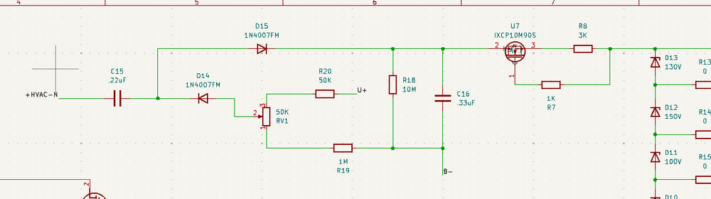

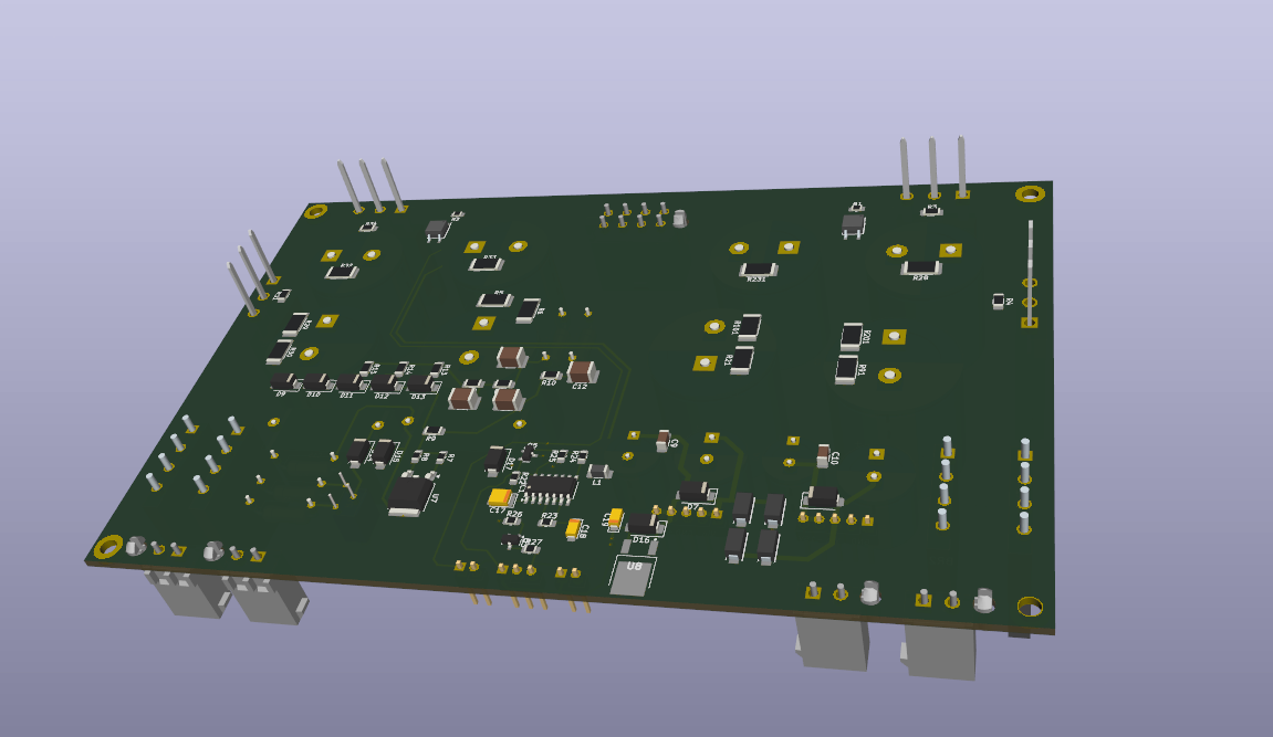

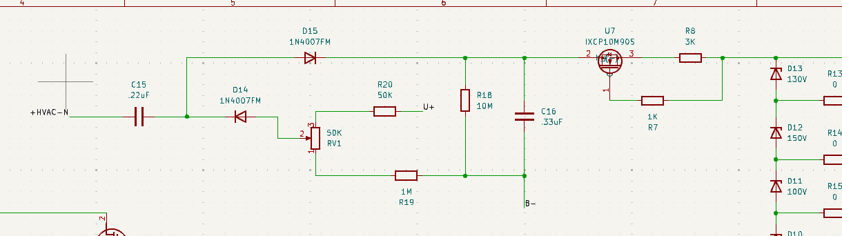

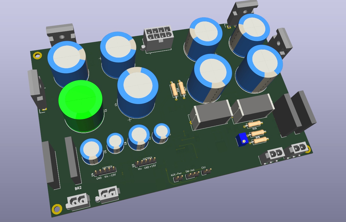

I’ve mostly finished the layout at this point. The current board size is 107 mm × 166 mm, and it integrates the following onto a single PCB: Bias GRLV interface Circlotron PSU interfaces Soft-start circuit Four IXTH6N100 Stand outside. Should be fine w/o heatsinks. Both Circlotron supplies merged into one board. For reference, the original Circlotron PSU boards were roughly 176 mm × 190 mm per board, so the overall footprint has been reduced to well under half the original total area while keeping full functionality. The shrink seems reasonably successful so far. There is one point I’m still not fully confident about (see Fig. 4): C15, left side +HVAC-N — which rectifier bridge should this node reference? In the non-floating implementation, it would naturally reference the rectifier feeding B+. However, once the supply is fully floating, I’m not entirely sure which point should be considered the correct reference for this connection, and I’m unclear which node I should be tying it to. Any clarification on the correct reference point here would be appreciated.
