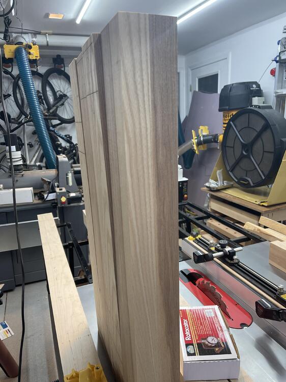

  5. Put up a French cleat wall to utilize some space behind my saw station. Testing using T-track and dowels for my red tools. Will build something proper soon.

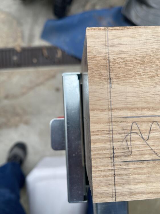

  18. Put it back together and that was the problem. Offset and balance adjusted fine. I was a bit concerned when I first turned it on as it started to come up but blew the fuse (3.15A Slow blow). Replaced the fuse and it came up fine. No soft start or anything. Lights didn't dim or anything. Not sure if this is a problem or not. I'll see how it starts up in further starts to adjust and implement the opto servo. Bias is ~17mA; heatsinks don't seem to be warming much, but I didn't run it much (5 minutes). Might turn it up to 20mA bias, need to read the thread more (again) to see user comments on that. Can't believe I hadn't noticed that solder bridge before, but glad I don't need to try to source any unobtainium parts right now
