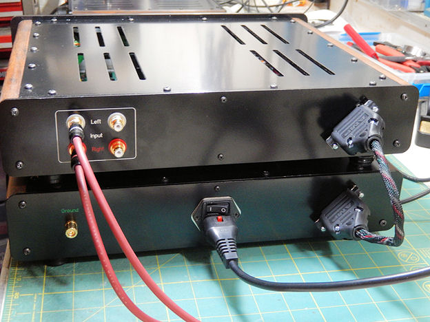

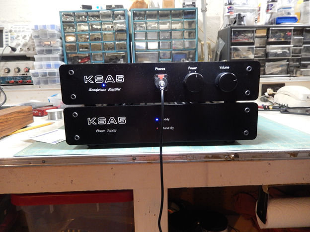

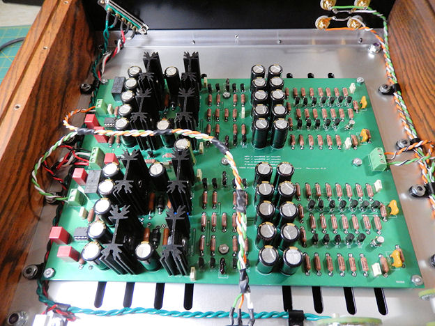

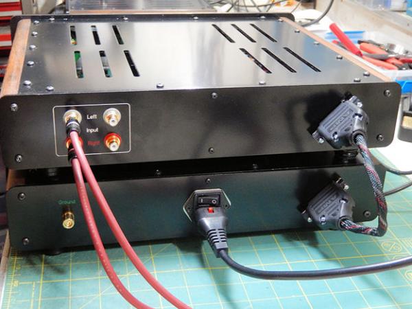

muskyhuntr Posted December 1, 2014 Report Posted December 1, 2014 Finished my KSA5 and am very pleased after a relativly short listening session. Board parts are standard from the BOM with extra attention paid to closely matching the parts. Goldpoint controls, Vampire RCA's, SUMR transformer. A big thank you to Kevin Gilmore for making this project possible! Me 1

UFN Posted December 1, 2014 Report Posted December 1, 2014 Finished my KSA5 and am very pleased after a relativly short listening session. Board parts are standard from the BOM with extra attention paid to closely matching the parts. Goldpoint controls, Vampire RCA's, SUMR transformer. A big thank you to Kevin Gilmore for making this project possible! <snip> Me Nice work on that chassis! //UFN
