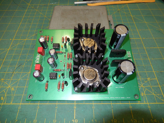

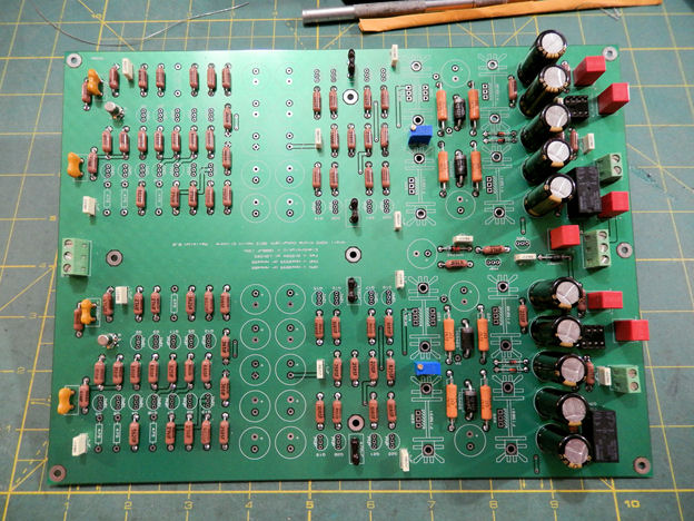

Hi All,
Been working on a couple of Gilmore projects at the same time.  Shown here is my compleated KSA5 power supply (new version).  Waiting on SUMR transformer before I test it.  I also have a good start on the amp board.  Still need to populate the 475 ohm resistors before I go on to the transistors.
post-4368-0-47223400-1400104859_thumb.jp
post-4368-0-07964200-1400105400_thumb.jp
