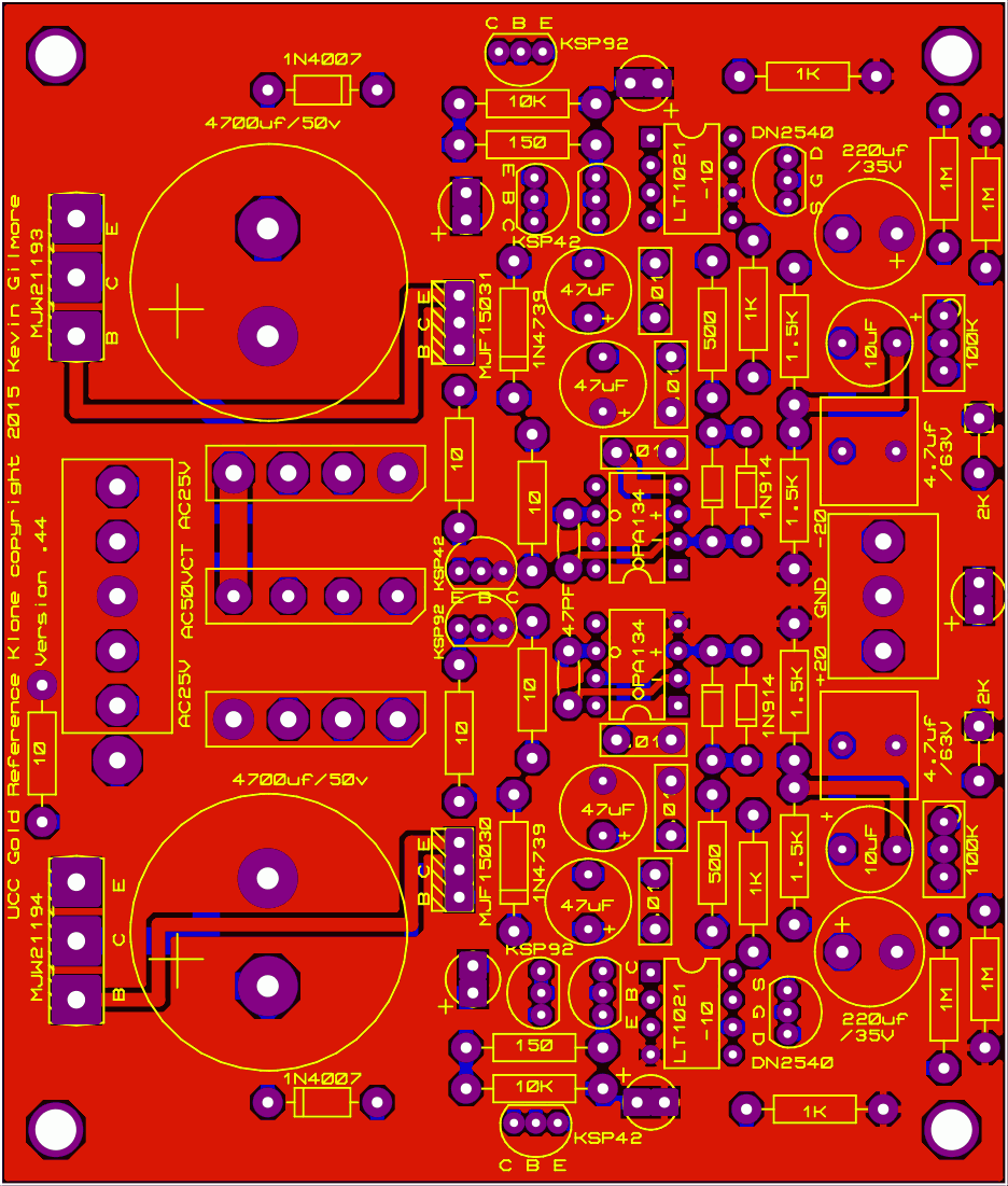

Could I request that a second set of output terminals be added to the next revision? This would make things easier when feeding more than one board.
Could you:
  1. move the power on LED and the 2K resistors
  2. leave the mounting holes in the same places, but extend the board out a bit to allow moving the output connector(s) out a touch, allowing for a couple of them
  3. also, is anyone actually using the adjustment pots? with good gain resistor measurement, you can get the output voltages quite tight without them (my board is a previous version without them). This would free up considerable real estate.
Just some thoughts. 2x18ga wires into a Phoenix block isn't much fun, and I don't think the Molex SPOX connectors I prefer using would accept more than 1 wire per terminal either, though I haven't tried it yet.
Edited by Pars
  • Author
goldenreference6d posted, 2 x output power connectors.
one should be the short variety, and the other one the taller one, or the angled one.
board is now 3.95 x 4.32 inches
its better to not use the pots and resistors, it probably increases the tempco. if you hand select the feedback resistors, or buy .1% parts its a better idea.

Folks if I wanna adjust the output voltage, which resistor should I change?
edit: +/- 12V/13.5V/15V, all less than +/- 20V, should I also need to change the caps and ops?
Edited by mtoc
http://imgur.com/xKQhzZZ
Take from Pars's pic,Change those 1.5K resistor,top and bottom ones are R8,R9
for V+: (R8 + R7) / R7 x 10 (reference voltage of D5 - LT1021-10)
for V-: (R9 + R10) / R10 x 10 (reference voltage of D7 - LT1021-10)
For 15V you can go 750R,1.5K Set
others you may need to change different voltage version of  LT1021
don't need to change caps and OPAs for voltages you mentioned ,but you may need to change zenzer value to voltage/2
Edited by ang728
edit 2: the transformer I think I will choose 12vac, 15vac or 18vac (all *2 models), among these three.

  • Author
for 12V you might want to go with the 7 volt version of the reference and recalculate the resistors. And probably lower the 9.1v zener to 7V

fisrtly I need the 13.5 VDC, so I just change the R8 and R9, then everything is fine? (R7 = R10 = 1.5k, plus the 10V version LT1021-10, 9.1V zeners)
R8 = R9
13.5 x 150 -1500 = R8 = 525
(R8 + R7) / R7 x 10 = 13.5
If using the 7V version
(R8 + R7) / R7 x 7 = 13.5
(R8 + R7) / R7 = 1.9286...
We change R7 to 2k to make it simpler
R8 = 1858 approximately

You might be better off sticking with the 10V ref and using R7 of 700r (715 is closest e96 value) for 13.57Vdc. That is with a 2K R8. Only if Kevin thinks the 10V Vref will work fine for 13.5V.
