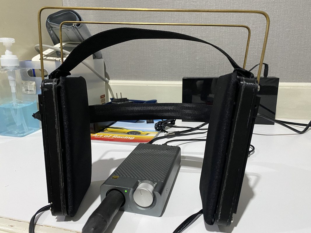

chinsettawong Posted August 12, 2021 Report Posted August 12, 2021 Finish a new pair of electrostatic headphones today. 18
spritzer Posted August 12, 2021 Report Posted August 12, 2021 Those look great and reminded me to post this, a possible cable for DIY electrostatics: https://www.aliexpress.com/item/1005002121174291.html?spm=a2g0s.12269583.0.0.67082dbcJ5CL0I I just got some but have as of yet not done HV tests on it or anything but it's nice and supple, if a bit thin. Well worth a punt and reminds me of the Koss wire but not double insulated. 3
chinsettawong Posted August 13, 2021 Report Posted August 13, 2021 15 hours ago, spritzer said: Those look great and reminded me to post this, a possible cable for DIY electrostatics: https://www.aliexpress.com/item/1005002121174291.html?spm=a2g0s.12269583.0.0.67082dbcJ5CL0I I just got some but have as of yet not done HV tests on it or anything but it's nice and supple, if a bit thin. Well worth a punt and reminds me of the Koss wire but not double insulated. I’ve used something similar with one of my headphones for a while now. It’s been OK. Yes, it’s not double insulated and it’s not as soft as the Koss cable. 5

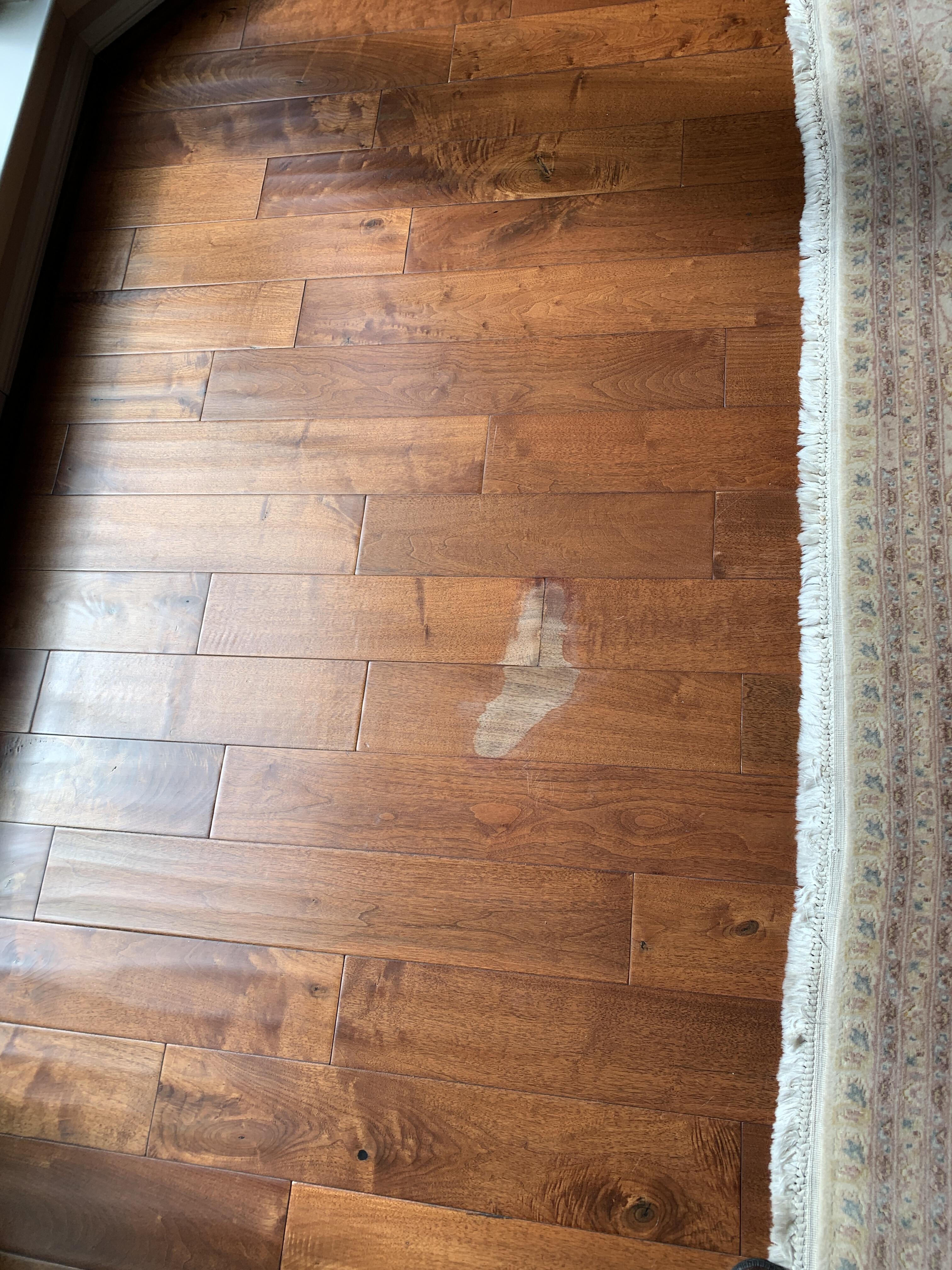

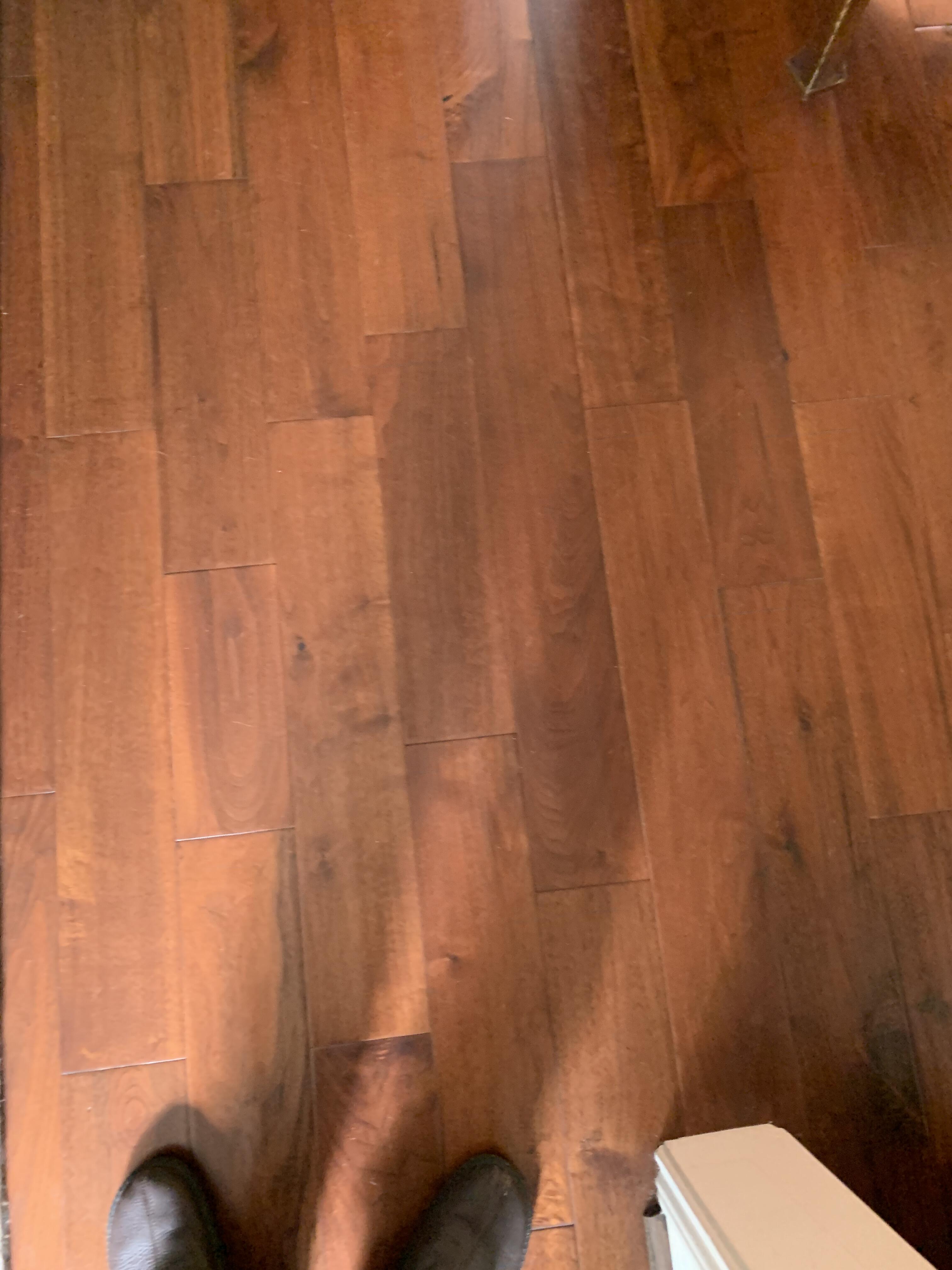

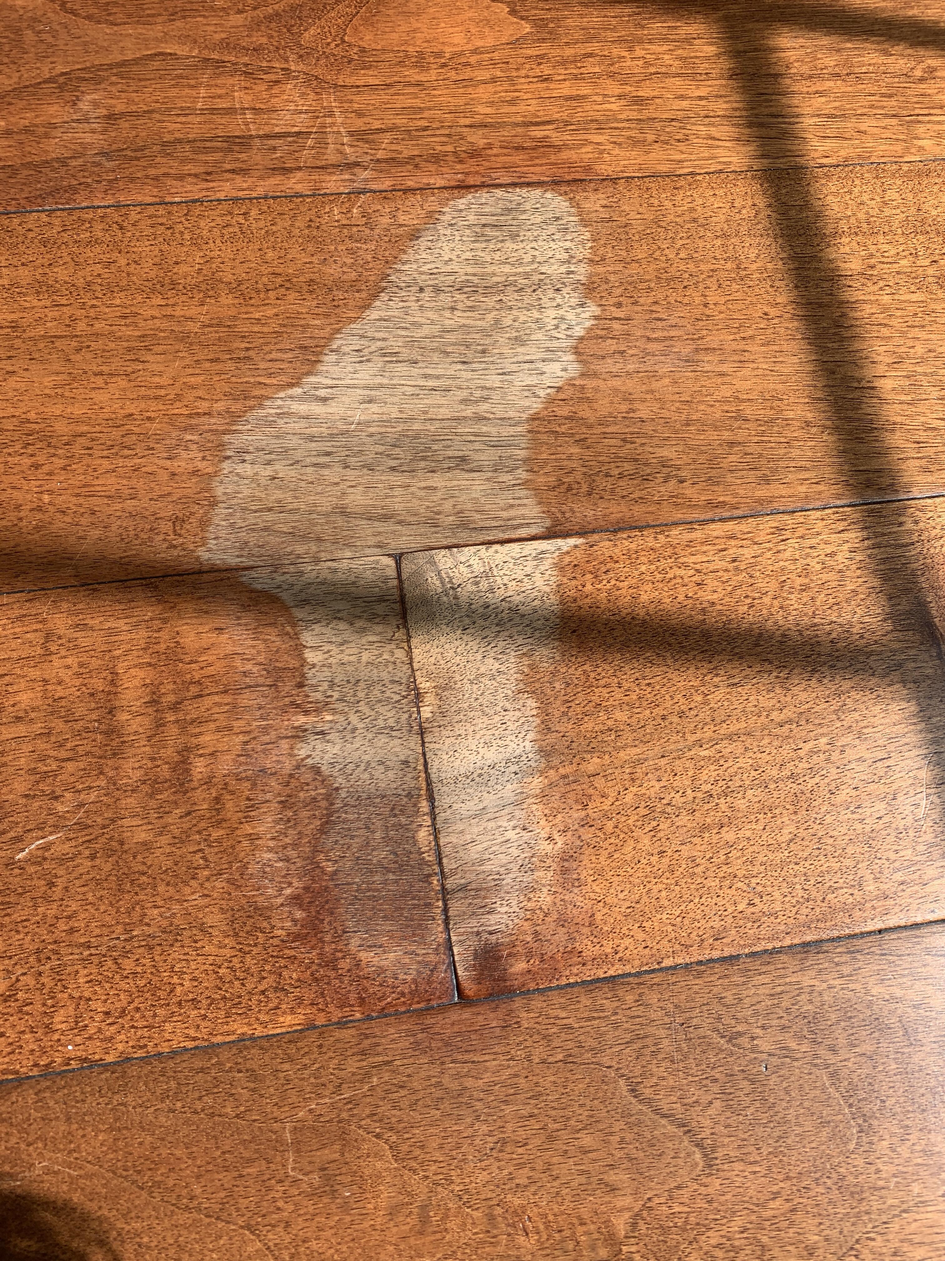

HemiSam Posted August 21, 2021 Report Posted August 21, 2021 I would appreciate any thoughts from the wood workers on how to as intelligently as possible "fix" this hot sticky mess that is my wood floor. In short, my beloved old pooch has a penchant for chewing on wood and, as odds would have it, wood floors... We thought she was over this in her later years but apparently not. The wifey then informed me that the spare boxes of slats were used to repair errors by the installers...and they left us with none. Extensive search for replacement slats and nothing... Called the seller, the manufacturer, yada yada....zero. We brought in some "experts" a friend recommended and they made it worse...pooch scratched it up and then they go to sanding it only to realize that the stain they used was absorbed far too easily to match the finish on the Brazilian hard wood. Other "experts" wouldn't touch it. Clearly there's some more complex stain and finish than they wanted to mess with or the size of the job so we were left with this.... The photos are a bit crap as the iPhone camera wanted to turn it grayish vs the reddish tones but these are indicative. I don't need perfection but I'd prefer not to FUBAR it completely. You can see where I've tried to correct a small section with not a ton of joy. Thanks in advance for any recommendations. HS
Craig Sawyers Posted August 21, 2021 Report Posted August 21, 2021 If this is solid wood, and not laminate (ie like QuickStep), I can't think of an alternative to using an industrial belt sander and taking it down to remove the stain entirely. And start all over. Steve - any alternative you can think of?
HemiSam Posted August 21, 2021 Report Posted August 21, 2021 It is solid wood, CS. As I hope you can see fairly light under what I’m assuming is a stain and then a urethane finish that’s not glossy…perhaps a cherry like hardwood but I am no expert. Once down to the wood it quickly absorbs a stain / oil and pulls in a good bit of darkness into the grain. HS
dsavitsk Posted August 21, 2021 Report Posted August 21, 2021 You are probably going to have to remove the poly. That probably means sanding the whole floor. For the black stains, oxalic acid
HemiSam Posted August 21, 2021 Report Posted August 21, 2021 I was hoping perhaps a few slats at most but thanks, Gents. HS
swt61 Posted August 21, 2021 Report Posted August 21, 2021 (edited) Unless you know for certain, I'm almost sure that's an engineered flooring. Which means you have about 1/4" of solid wood, with intergrainular plys beneath that. The problem is matching up that stain. I would recommend you call in a good flooring installer to repair and stain match. It won't be very expensive, and will get you the best results. You do not want to take a sander to that floor! The hand hewn texture will be completely fucked up if you do. Call in a professional. That's not always my advice, but in this circumstance it is. Edited August 21, 2021 by swt61 1
HemiSam Posted August 21, 2021 Report Posted August 21, 2021 1 hour ago, swt61 said: I believe this is exactly what we have. Hard wood up top and then whatever below. I tried to do as suggested, swt...but that failed. I'll try again. Thank you! 1
swt61 Posted August 22, 2021 Report Posted August 22, 2021 If that doesn't work. I'd hand sand the bleached area with 220 grit paper, then use some sanding sealer with a foam brush to cover the sanded area. The sanding sealer will stop the stain from soaking in too much. You may have to buy two or three stains to mix to get the right tone. It's not an easy task. I'd mix stain and practice on a scrap piece of Mahogany. That's going to be close enough to what you have. When it looks right on the Mahogany scrap, then you should be safe in staining the actual blemished spot. 1
dsavitsk Posted August 22, 2021 Report Posted August 22, 2021 If you want to match the surface texture, you might have luck with a card scraper. https://www.amazon.com/Crown-Hand-Tools-Rectangular-375/dp/B012M9H8UG/ 1

swt61 Posted August 22, 2021 Report Posted August 22, 2021 12 hours ago, dsavitsk said: If you want to match the surface texture, you might have luck with a card scraper. https://www.amazon.com/Crown-Hand-Tools-Rectangular-375/dp/B012M9H8UG/ Agreed on the card scraper, but maybe these in this situation. https://www.amazon.com/dp/B07S2DT3K5/ref=cm_sw_r_cp_apa_glt_fabc_GH12CB2PGVY6RE4TDZPP?_encoding=UTF8&psc=1 1

naamanf Posted August 22, 2021 Report Posted August 22, 2021 (edited) I installed very similar floors in my Texas house. I kept a decent amount of extra boards in case there was ever an accident. Can’t really refinish that type of flooring, and will probably never get a perfect match. Even finding the same flooring probably won’t get an exact match due to wear and batch variances. Hopefully I’m wrong. if you have an extra board a good paint store can try and stain match if you are going to try to repair it Only wood I’ll do now is something that can be sanded and refinished. Edited August 22, 2021 by naamanf 2 1
HemiSam Posted August 22, 2021 Report Posted August 22, 2021 3 minutes ago, naamanf said: I installed very similar floors in my Texas house. I kept a decent amount of extra boards in case there was ever an accident. Can’t really refinish that type of flooring, and will probably never get a perfect match. Even finding the same flooring probably won’t get an exact match due to wear and batch variances. Hopefully I’m wrong. if you have an extra board a good paint store can try and stain match if you are going to try to repair it Only wood I’ll do now is something that can be sanded and refinished. and with good reason, naamanf. We had extra boxes left over but the installers had to repair some areas and instead of leaving us add'l boards they used the spares. I did not know as I work too much...excuses. Wifey probably didn't think about it focused on the floor being correct. We don't need perfection but certainly less of a standout ugly mess. I would have the floor redone as its been a few years but I fear our pooch will go at it again... We won't have the joy of her forever so once she leaves us we'll have it replaced. HS
