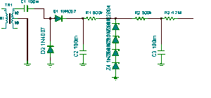

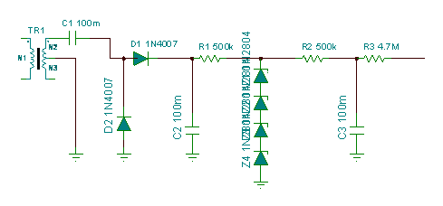

Manaox2, Yes, thanks, but I will have to do it this evening as my wife knows how to do this.:confused: Sorry, I'm not real good at posting diagrams, pics, online, but will hopefully have the circuit posted after I get home tonight, so Spritzer can see what KG reccomended. I have it drawn and saved using the Tina Software.

It's been a while since I looked at the exstata bias supply but adding another cap or two at the output could perhaps give you the filtering needed.

Extra resistors and the cap would surely help so it is worth a shot. You could also just copy what Koss did to the letter and see what happens.
Yes, I may experiment, but I no longer have this exact same bias supply in my KGSS, as I went back with an adjustable one. Also, gonna have to see if my phones will act up again, and if and when they do, I'm gonna try the extra 5M resistor in series for a 10M total and see if that helps. To see which bias circuit I'm using, just look at the eXStata bias circuit, which is what I'm currently using im both my stat amps. Will report back if I find anything.

this is the "passive battery" bias circuit :)
Uh, Yes, To clear up the "huge cap" comments, those are actually 100nF or .1uF, same spec as the ones in the BH and KGSS bias circuits.:o This circuit, which was drawn over a year ago, was just to verify with KG whether I had the components in the right places to try the extra filtering. Again, it hasn't been used in quite some time, but did work just fine for testing purposes back then.
