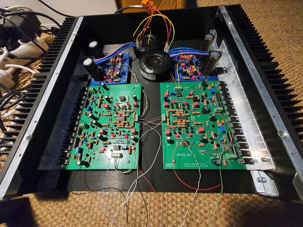

  12. It lives! One of the better solid state amps I've heard. Now to drill some panels!

  17. Second channel came up without a fault. For a 2U heatsink 200mA seems to be the highest what's thermally viable, the hottest transistors were above 70C. Once the spare THAT340 arrives, I'll try to do a listening test.

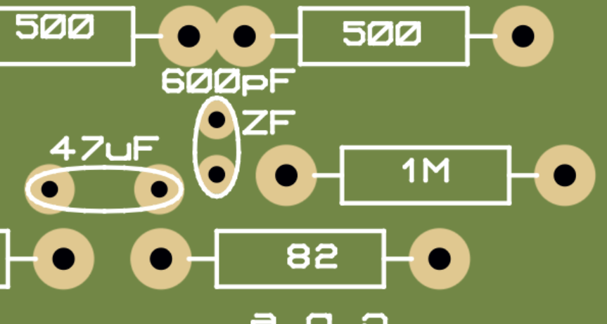

  18. Looks great! One thing, when I was searching for parts, the 600pf ceramic cap seemed to be problematic. Mouser only had one part and the lead spacing was more similar to what's for the 47uF cap.

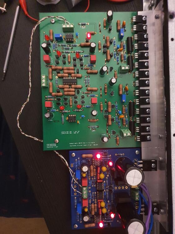

  19. Got the channel to work. Turns out the culprit was a faulty THAT chip.
  20. So, one channel of the CFA3 is assembled. As expected, it's acting funny! On the amp board only that LED stays lit. The four LEDs near the input stage only briefly light up when I'm powering on. The fifth outermost LED is dark no matter what. I have no problem biasing the output stages to 180mA, but have no idea how to do it for the input stage.

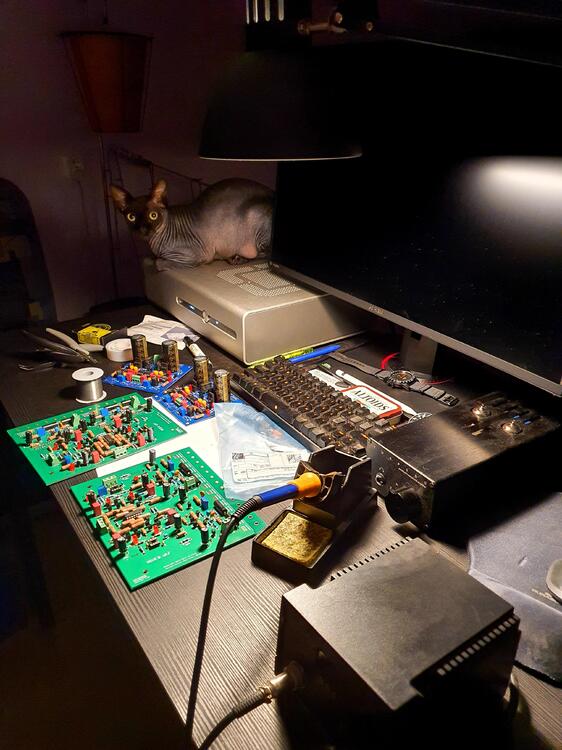

  21. Might be the fumes talking, but don't try to solder a CFA3 in one sitting.
