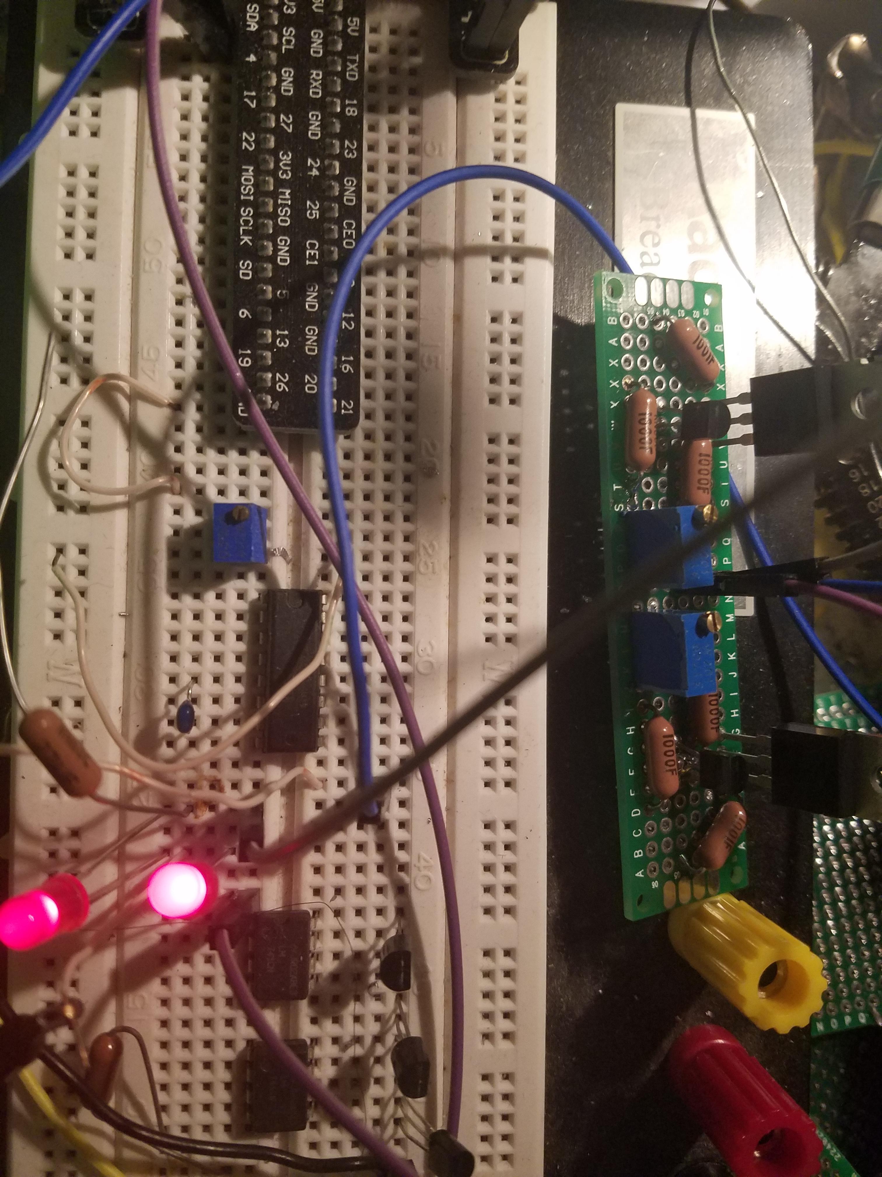

  10. Need to get around to swapping out some 10m90s for breadboarded cascode one of these days. Bought a hand tap that actually works, which makes things easier Gotta add the t8000 clone to the loooong queue too....
