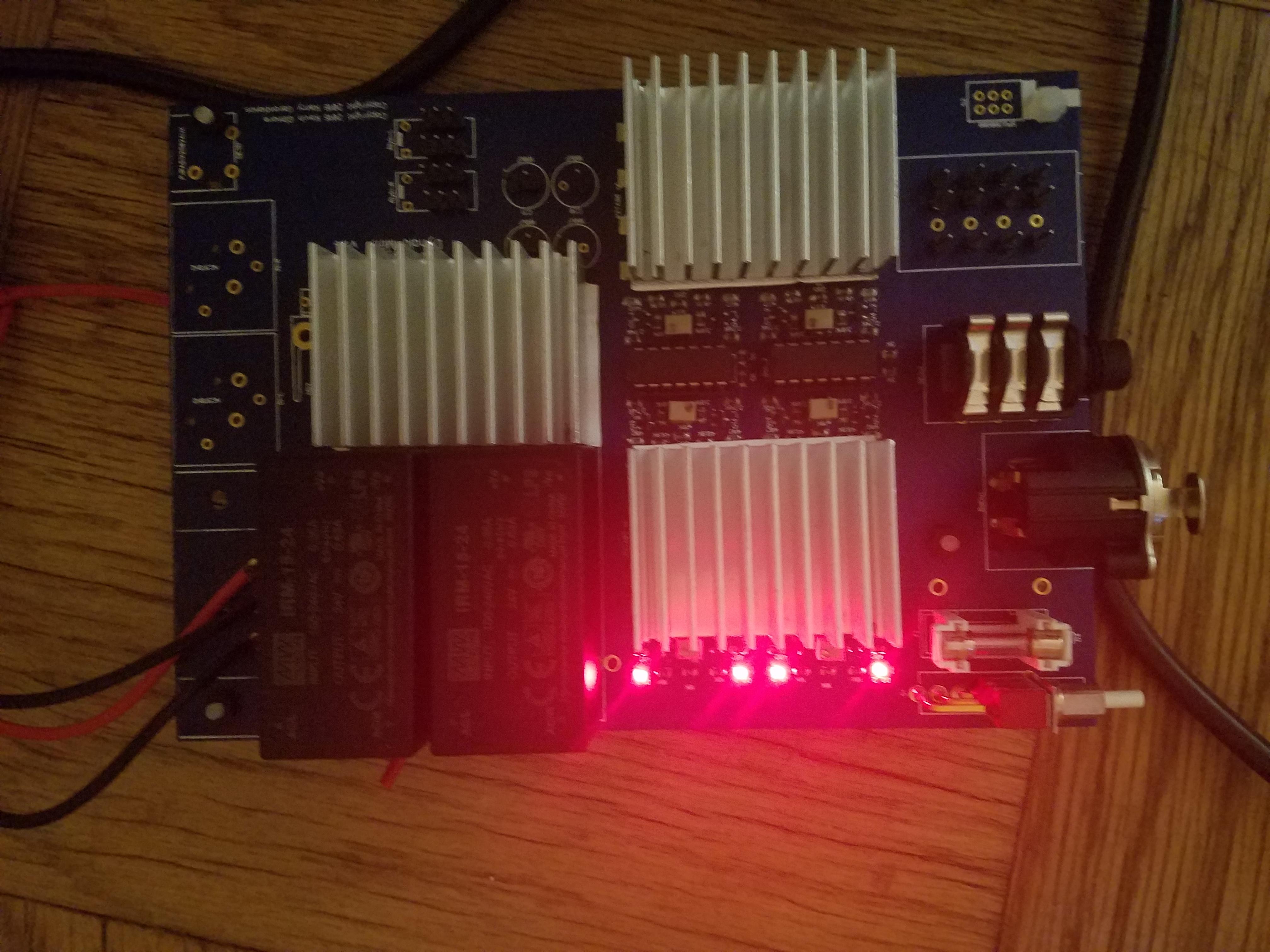

  2. ^ oops, forgot to answer. Yes it seems like a good price? Especially for a custom. A new Dynalo mini has been born (probably, I haven't tried with headphones yet). Was measuring 72 C on the regulators and 89 C on the output transistors so I threw heatsinks on everything. Now measuring about 62 on the fins of all three Edit: spoke too soon, it stabilized at 70 C Edit 2: I was planning on using the PS for the ubal to bal boards also but everything is running on the absolute ragged edge already so that won't work. I need to move the heatsink for the regulators out away from the switchers anyway.
  3. You'll know once you look at the boards, there is a gap between ground and the other 4 pins. If it's just a standard 2.54mm gap then potentially you could use a 6 pin header (if you cut the end off the gap header), though the socket end would still need to be 4 and 1, and the unused gap header would just be dangling. The RPi heatsinks already have some 3M adhesive squares so just stick them on. I wasn't sure if they were electrically insulating so just to be safe, I avoided the vias on the bottom of the boards.
  4. What wasn't nice was the first negative regulator working perfectly, then my ham-fistedness shorting it to ground with my probe when measuring voltages and then having to order and put in a new one
  5. Thanks, Steve! And many thanks to Kevin for the design and layout!
  6. I'm using +-18V straight out the PS of the Dynalo mini. Actual measured voltages +17.96, -17.92. I tried it at 16V on a GRLV and it still got quite hot, didn't measure temps.
  7. To answer the question, yes they do need heatsinks. Measuring 50-52 C with the sinks in the pic. Don't have part number, just RPi heatsinks from ebay

  17. So I did end up using a female header socket and air wiring the ground. The part number for the 4 pin right angle header is 68016-404hlf. The leds I used are extremely bright orange-red, glad once i case it up it will be harder to see. I am measuring about 3.95ma after a few minutes warm up but the thing lights up like a Christmas tree. Will do further testing hopefully over the weekend Edit: the diamond buffer boards are getting really toasty
  18. My bad. Yes they do. For the current source LEDs pick a forward voltage and matching resistor to get close to 4ma and you can use the vishay tnpw like from earlier builds or I used yageos. Also the decoupling caps on the opamps are 0603
