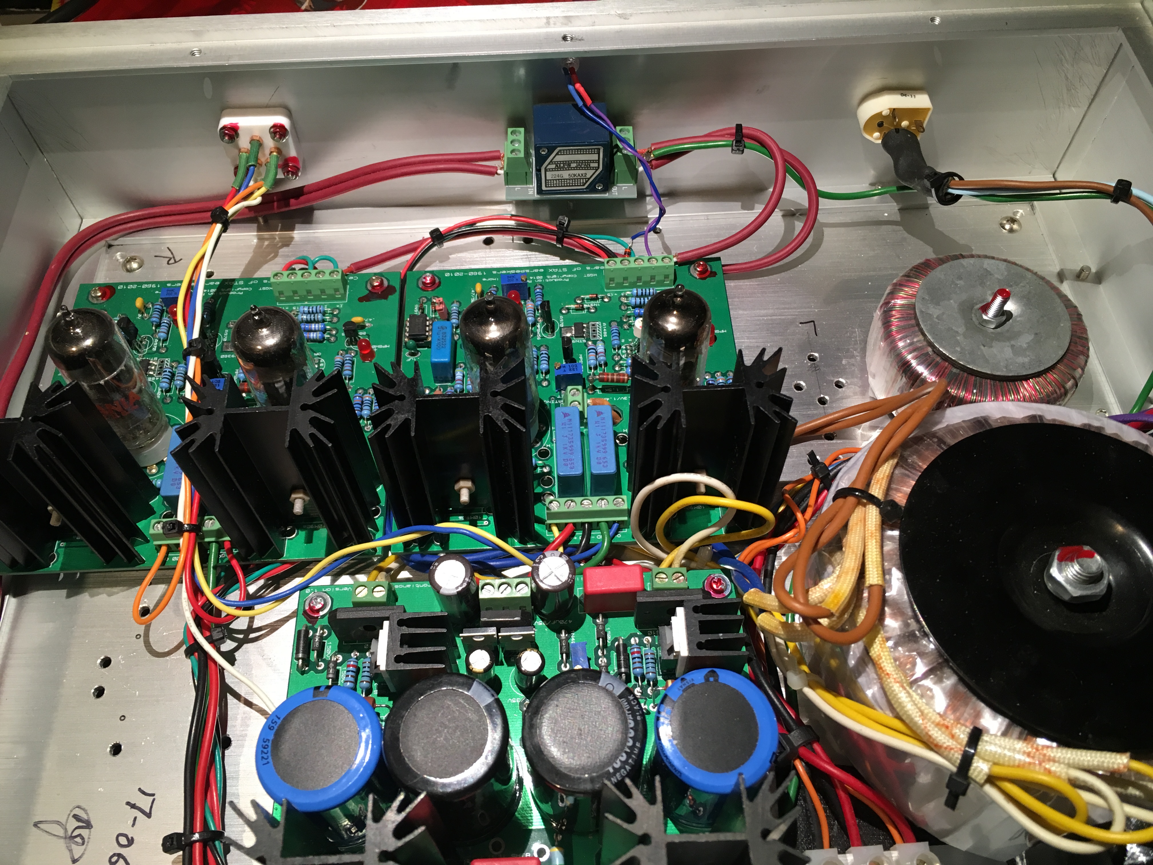

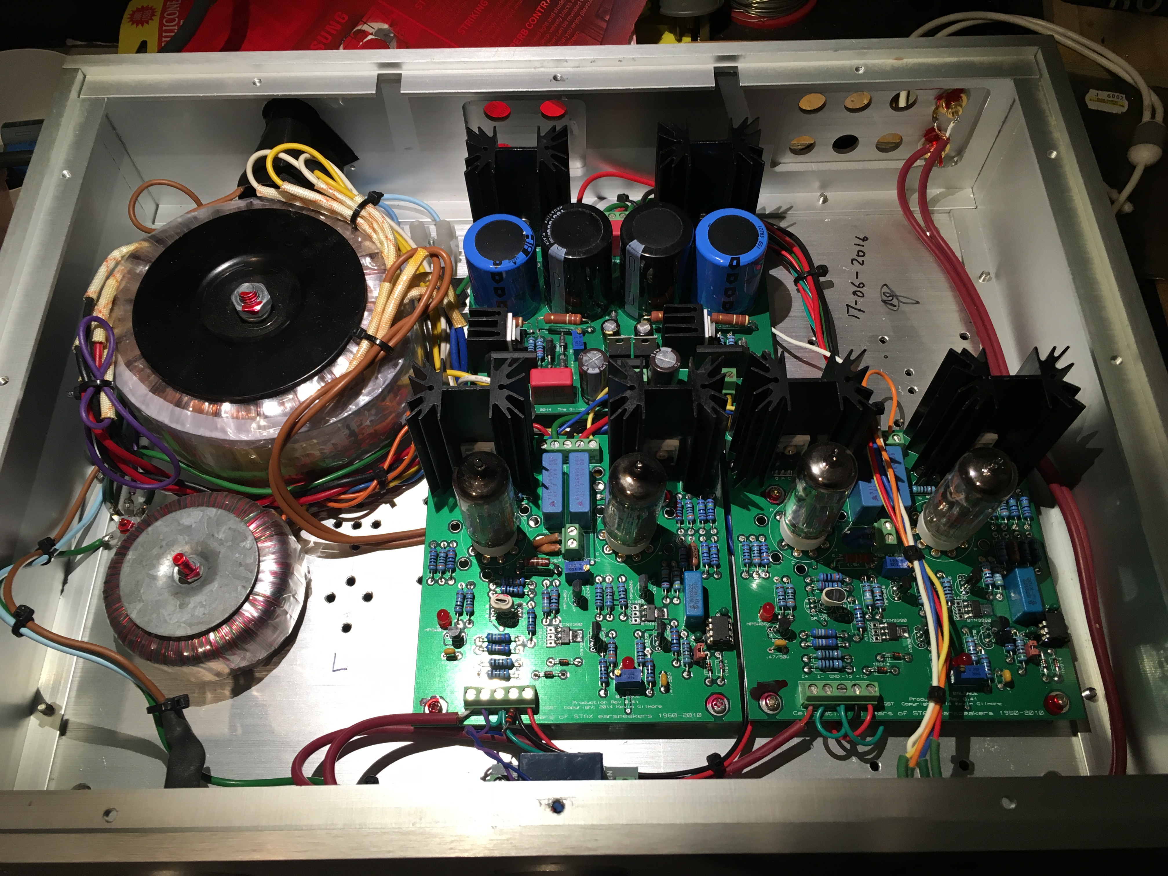

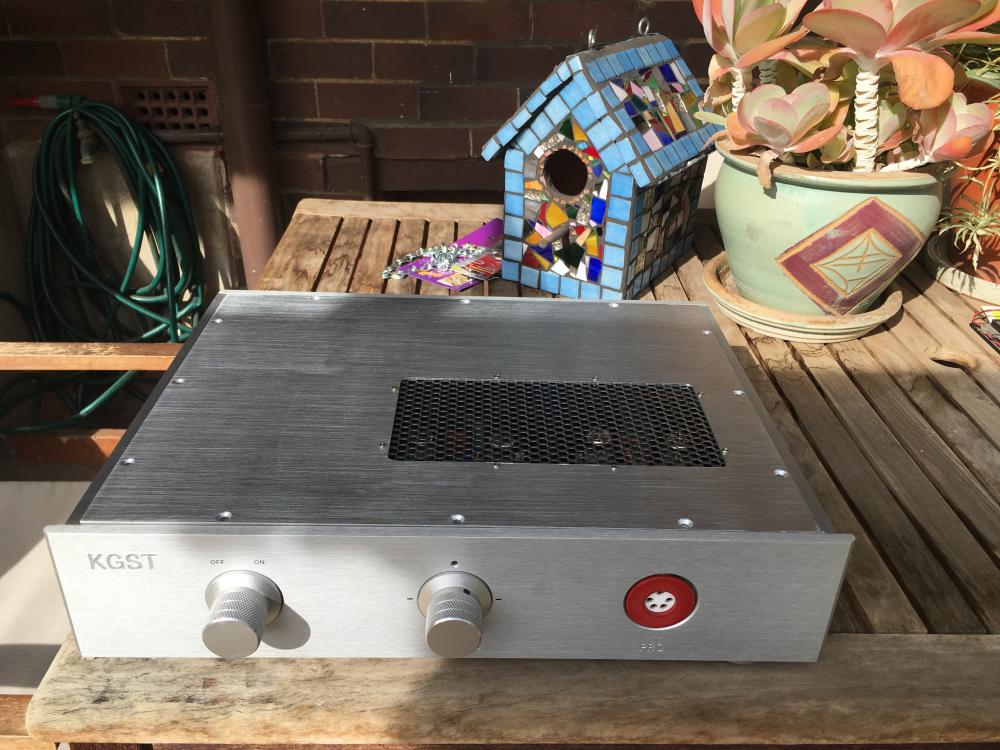

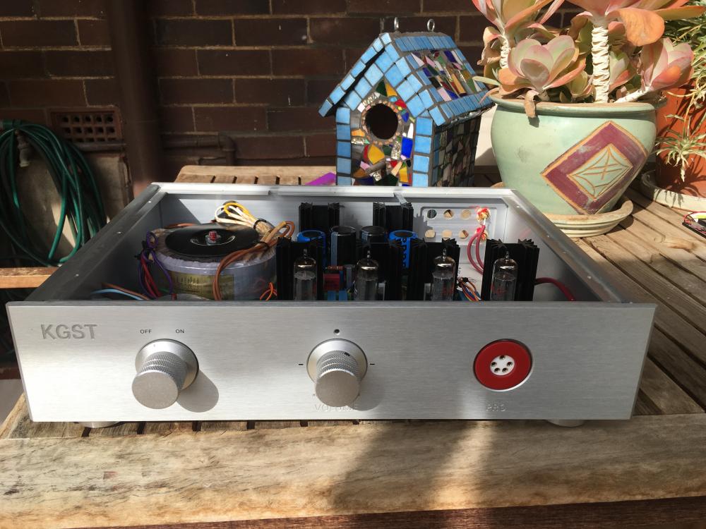

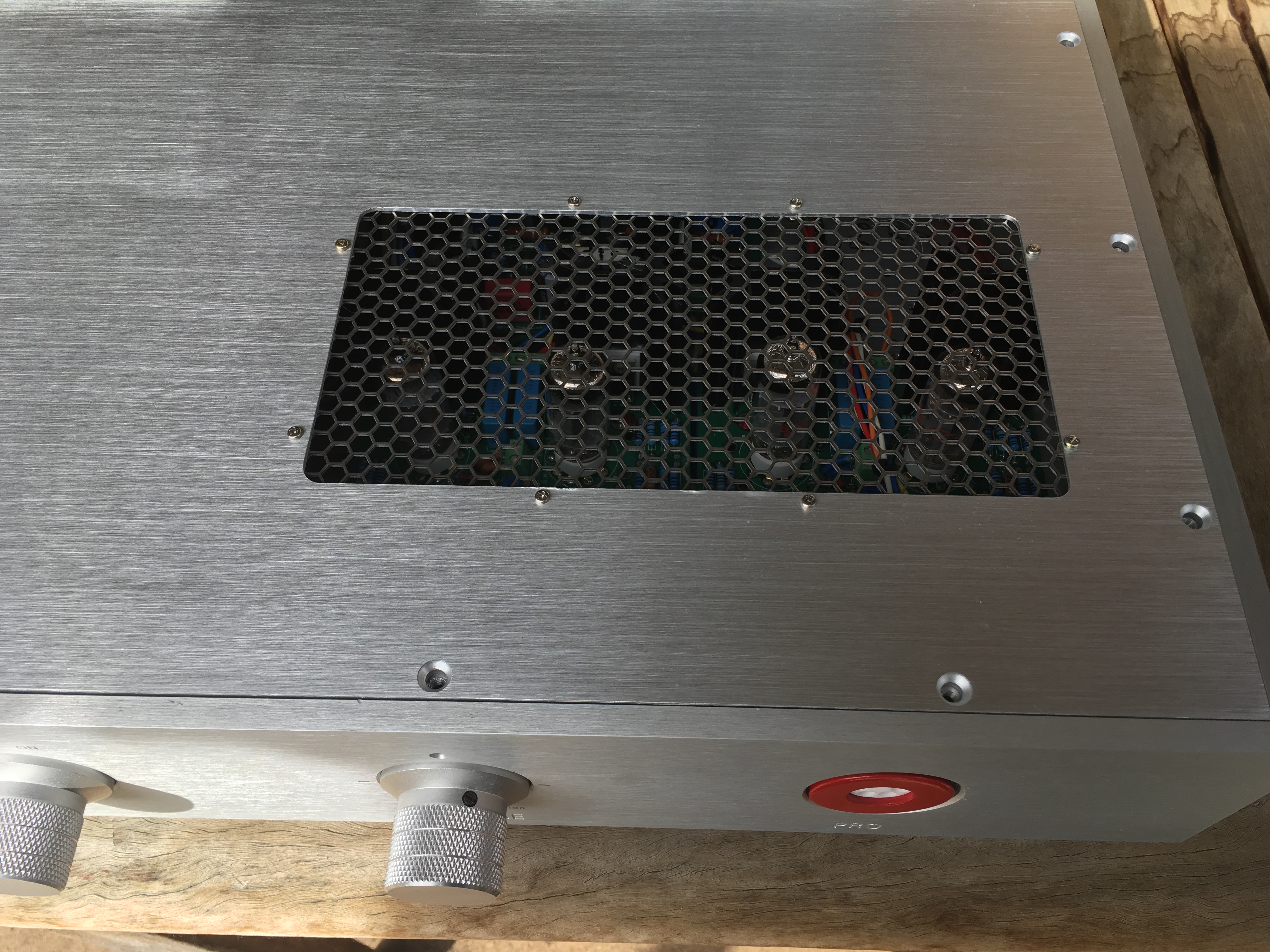

At last finish my KGST. This is my first completed KG project cased. Please I like any suggestion to improve my future build. It's a long road finding machine shop locally to cut the ventilation hole with an old milling machine.
Looks good and the only thing I would have done differently is to rotate the PSU 180°.  That moves the AC wiring to the other side so it's not running with all the DC and output lines.

Will modify the wiring run as suggested by the Don :)
That looks really nice. Well done sir.
Thank you for your kind words. Metal work is not my forté.
